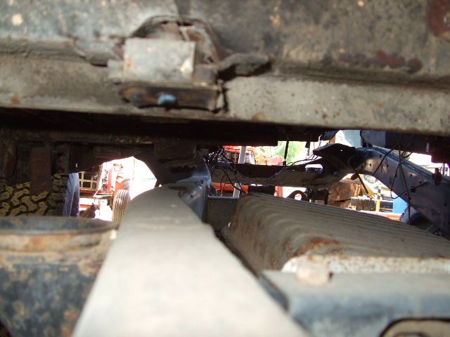

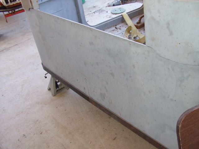

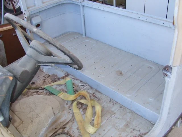

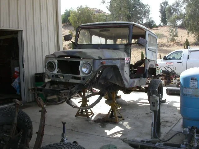

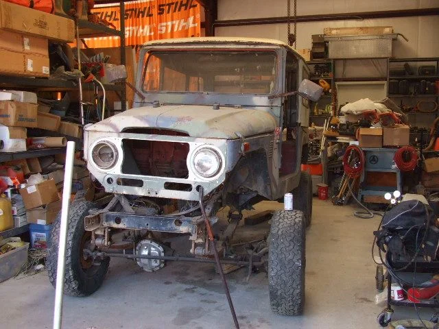

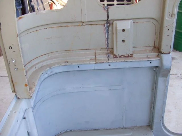

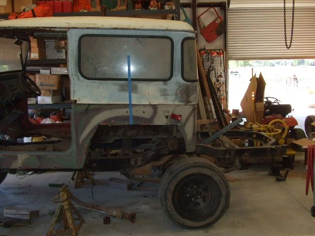

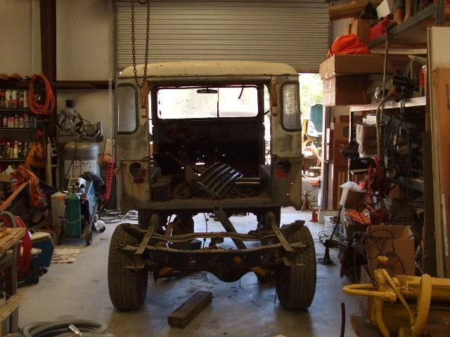

I have been accumulating parts for quite awhile now and I have the majority of them in the shop.
My project is Bobbing a 1974 FJ 40 to make a FJ 45 Extended Cab.
I started with a 1986 FJ 60 frame and using the power train out of a 1984 FJ60. It will be SOA using FJ 60 axle assemblies when done. Disregard the 44 that is mounted under it. It is just to roll it around.
For mock up I'm using a spare body so I do not destroy the Bobbed 40 cab.

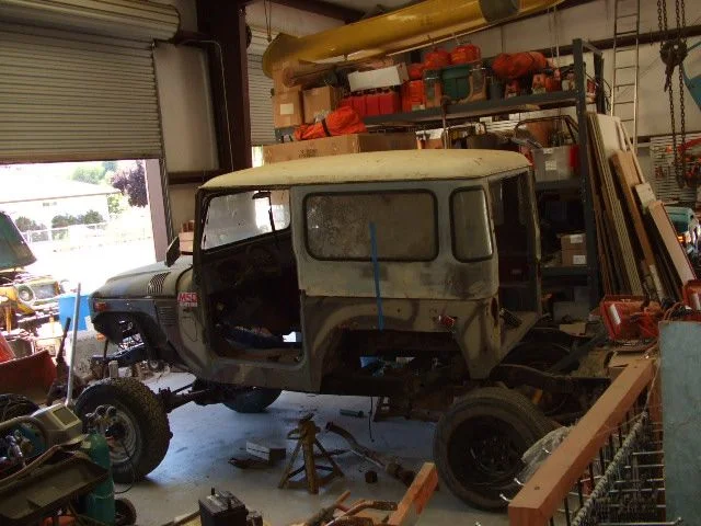

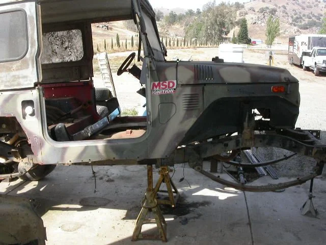

The bottom pic is 2 years later with the Rig 95% done.
This is a long thread showing my mistakes and obsticals I ran up against.

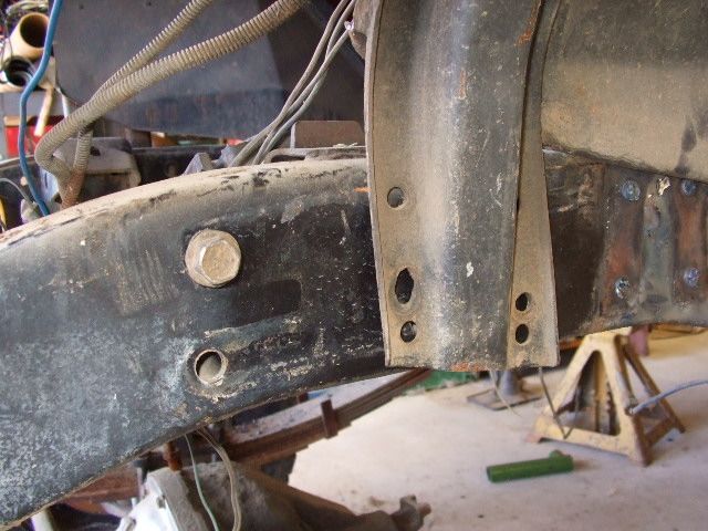

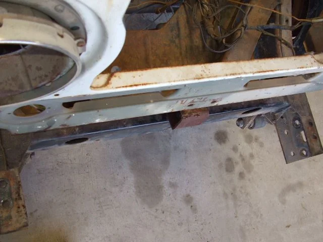

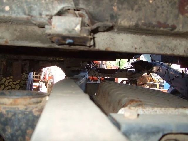

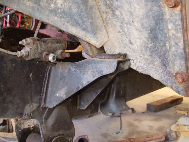

I would have started by gutting that 60 frame. I kinda doubt that the body mounts will fit lol
You going to do an interior cage?? (since you have so much more room there ;) )
you could use the cage mounts to mount the body to the frame..
I have already spoken to Don at FC Fabrication. He knows the Cab since G stored it for me there. That is exactly what the plan is though.
I'm going to tack everything for the mock up and then let him cut off and fab as he needs to for the cage.

x2 on the cage/ body mount idea. I saw where dhondagod took the main stay at the front of the 40 cab and re-made it to double as a cage mount and thot that is a super sweet way to do that. Angled tube with a pedestal. Beats the heck out of the rock catcher channel design.
That extended cab was a MAJOR score. Still shaking my head on why that guy 'got religion' and let that thing go. Anyways, I think I'd leave that exactly as is until Don is done; once the cage is done, you might change your mind about a couple of other things.
