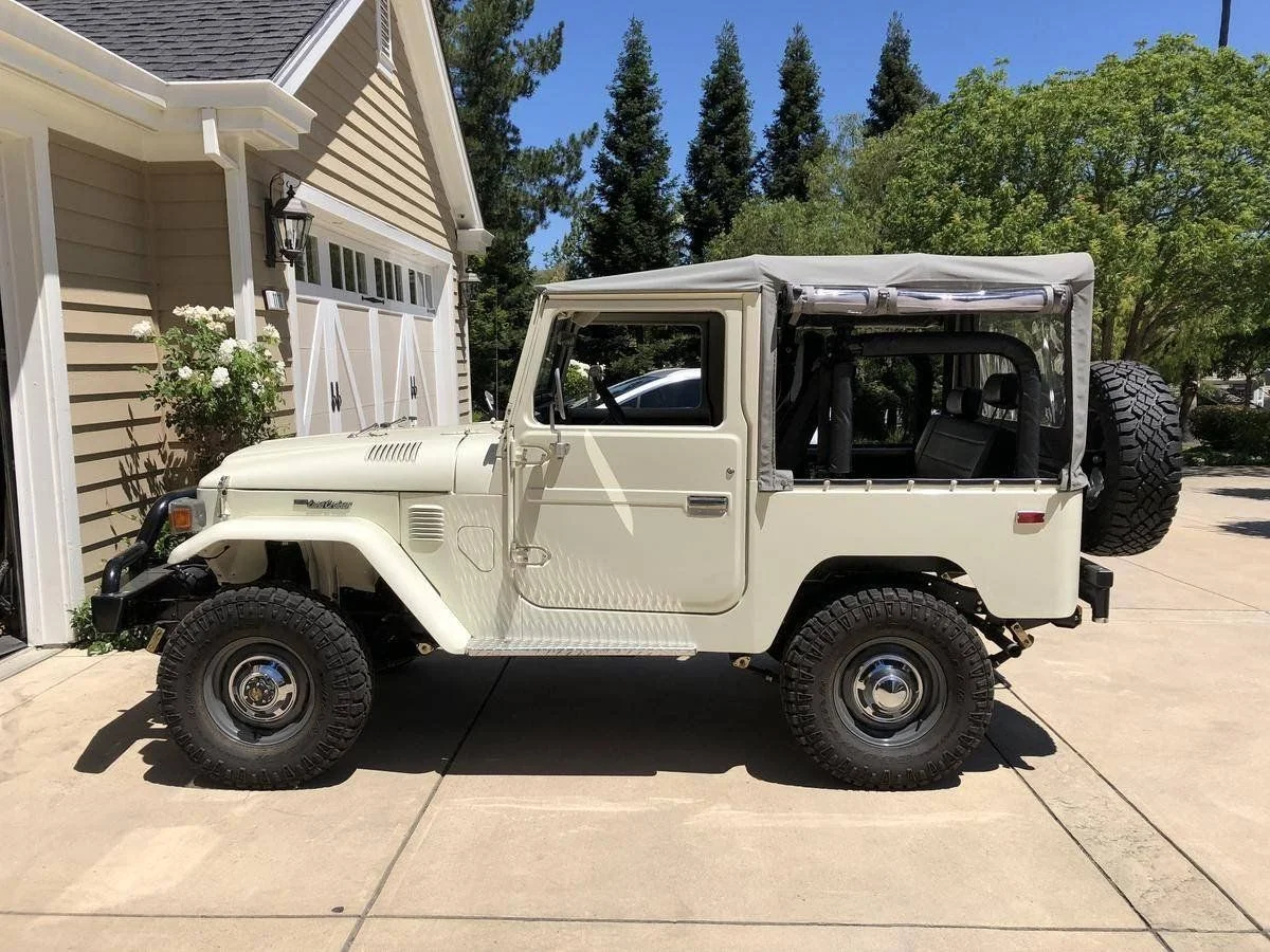

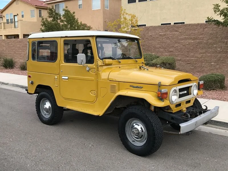

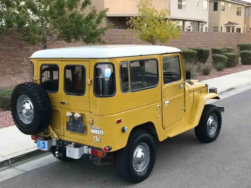

From what I have seen it depends on the quality of the work-whether steel or aluminum or fiberglass-that affects price. Not so much the material of the body. I drive my cruiser a lot, and I got tired of chasing rust. So I went with aluminum. One of these below is steel and one is aluminum. If a nice job is done on the aluminum tub it can look pretty nice.
View attachment 1787905 View attachment 1787907
Neither look completely original. Guessing a picture of the rear sill if the metal is original could tell the difference. How about a picture if the interior and transmission hump. As was brought up thoses are easy to tell apart.
I cannot tell the difference.
Mustard color does not the A pillar seam. White has the A pillar seam and can see where the B pillar seam should be. Mustard has the correct running board and rear corner reflectors. White has aftermarket running boards and no rear reflector. Can't see the spot welds over the wheel wells on either.
Guessing the white one is an aluminum tub? I had a 40 with an aluminum tub and I think they have their place. Also, I wouldn't have an issue buying one in the future. Just depends on what your goal / preference is.

So , Mustard is aluminum and white is steel ? I have an original FJ40 steel, and did not notice this at all.

Wasn't saying that. Was saying neither was 100% original. One picture of each is not a fair way to tell. If I seen each in person betting tell without looking inside.

The wrong turn signals on the white 40 fenders drive me nuts. If your gonna go with the old front grill, it looks wierd with the wrong fender lights.

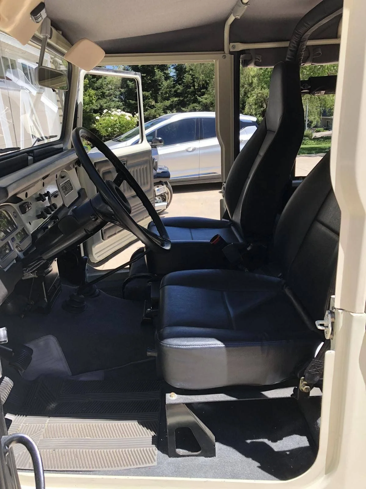

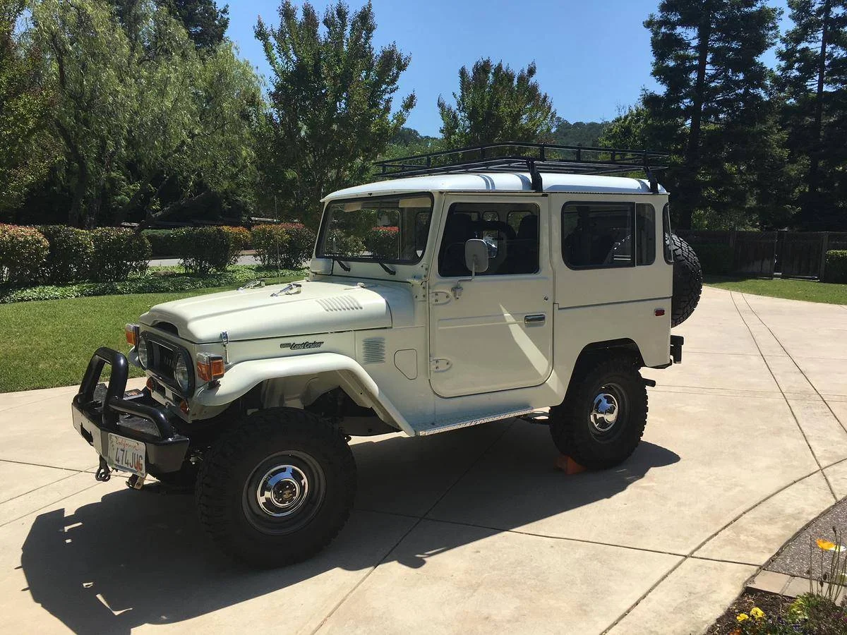

In the above pics I posted, the yellow one is steel, white is aqualu.

Is the mustard one yours? Didn't make a guess because could tell neither was original. Restore ones generally loose some of the original details like seams covered and spot welds filled. No one mentioned the bezel on the mustard or the fact it has two hooks on the front. The second hook I'm debating using on my 79. Not correct but have a number of spares in my parts collection.
No not mine, just found it in a for sale ad.
