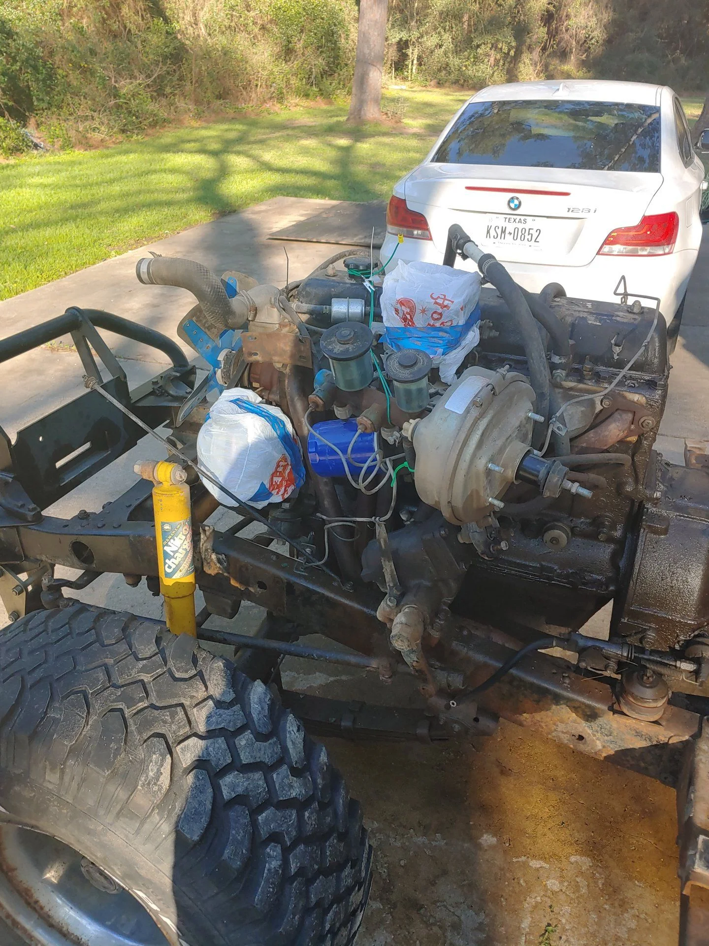

Btw you do not need that monstrous Mallory ignition coil... an F155 will never rev high enough for it to make any difference ... stocker coil or other oil filled coil that has a bit more umph is more than enough

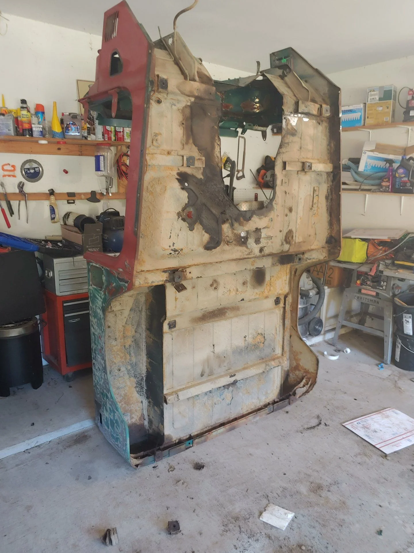

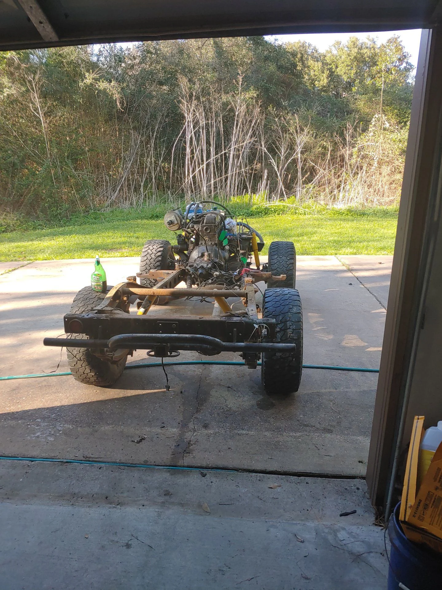

Thanks guys. Yes it was his. He put the Mallory on it. Always had problems burning his points. How heavy is that tub and Cowl going to be to lift off the frame? Can 2 people do it?
Recommend a 3rd at minimum. I did it with 2, but we used straps and an engine hoist.

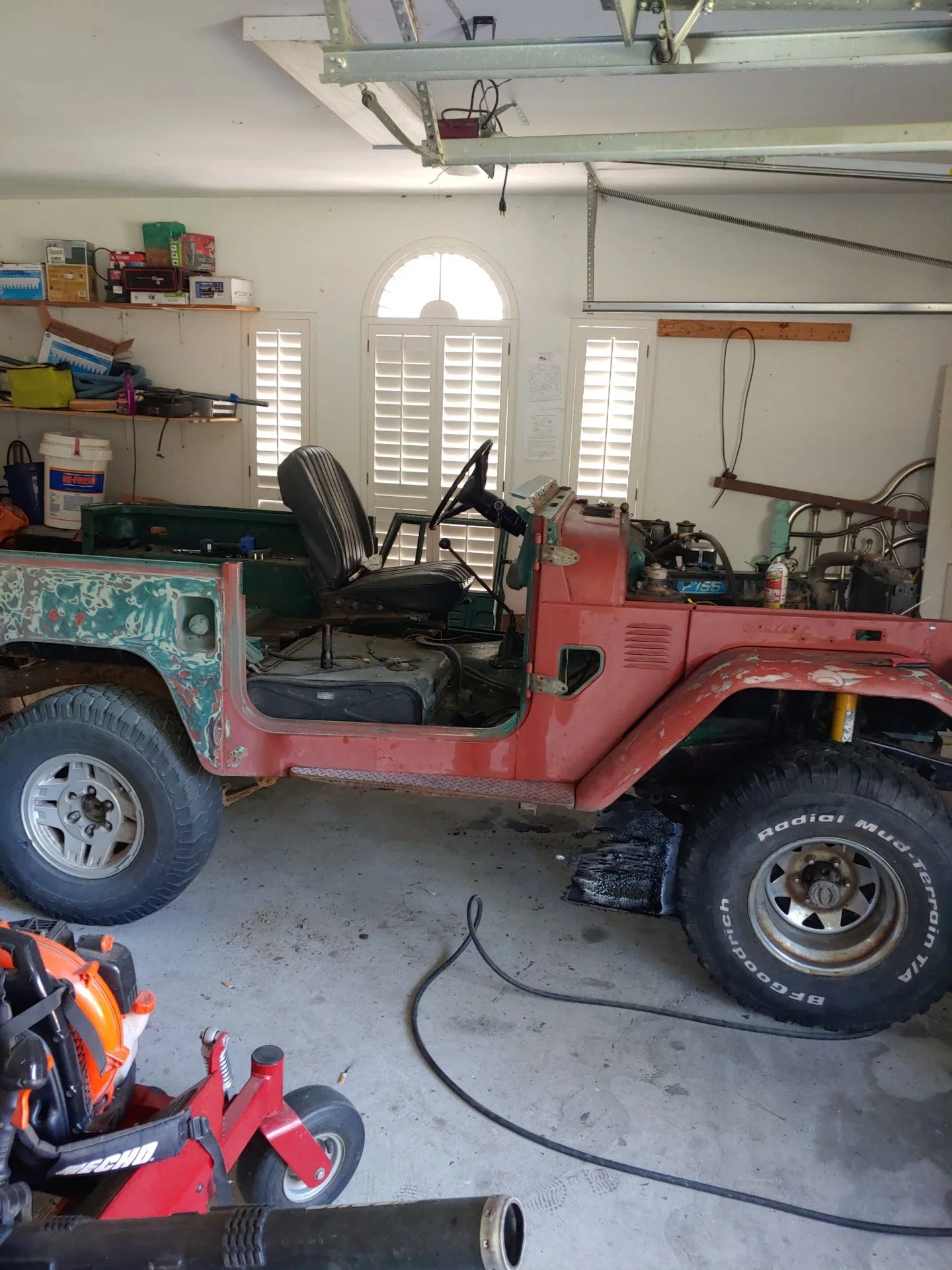

I have been bagging and marking every piece i take off. He just had the motor rebuilt a few years ago. He put everything stock back in it. Runs great, radiator leaks and its leaking oil from the plate under the oil pan.
Ok cool so its pretty heavy?

Pics would help to know what the issue is. Potentially weld from inside of pan if leak area can be seen from inside pan side
That's probably a rust problem at the oilpan/skidplate joint. Usually best to source a new pan...
