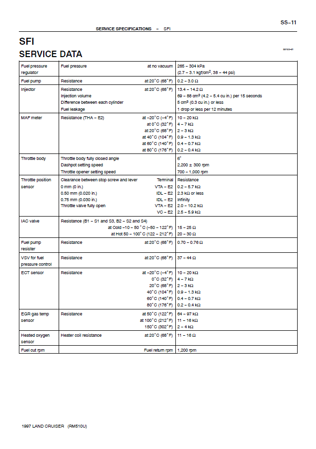

Here are the ignition, fuel and miscellaneous specs:
Check the ignition specs first (you'll need a multimeter), they're the easiest to confirm. Next go to the fuel system and finally set the ignition timing and idle speed.
If that doesn't get you where you need to be, you have other problems. The most important thing is not to skip around, throwing parts at the problem. You'll get as many opinions on how to proceed as posts. This isn't the only way to find and solve your problem. You need to develop (or use) a solid, systematic plan and stick to it.
