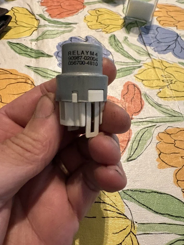

attached is one of the factory relays and an o'reily one that I bought. The factory -83 has the same cap as the o'reily and a similar price point.
The 4 relays are MAIN Power, Tail light, EFI and Open circuit. You might consider changing them also.

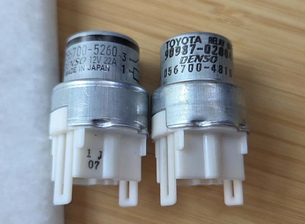

It looks like the original relay Denso part# 056700-4810 has been replaced by Denso part# 056700-5260 which appears to have the same specs as the original. 12V/22A.
Denso lists that as "heavy duty"

They are identical to the OEM part number 90987-02004, down to the coil resistance.
Pictures for your amusement. The new relay is on the left and the one I found rolling around in my truck is on the right:

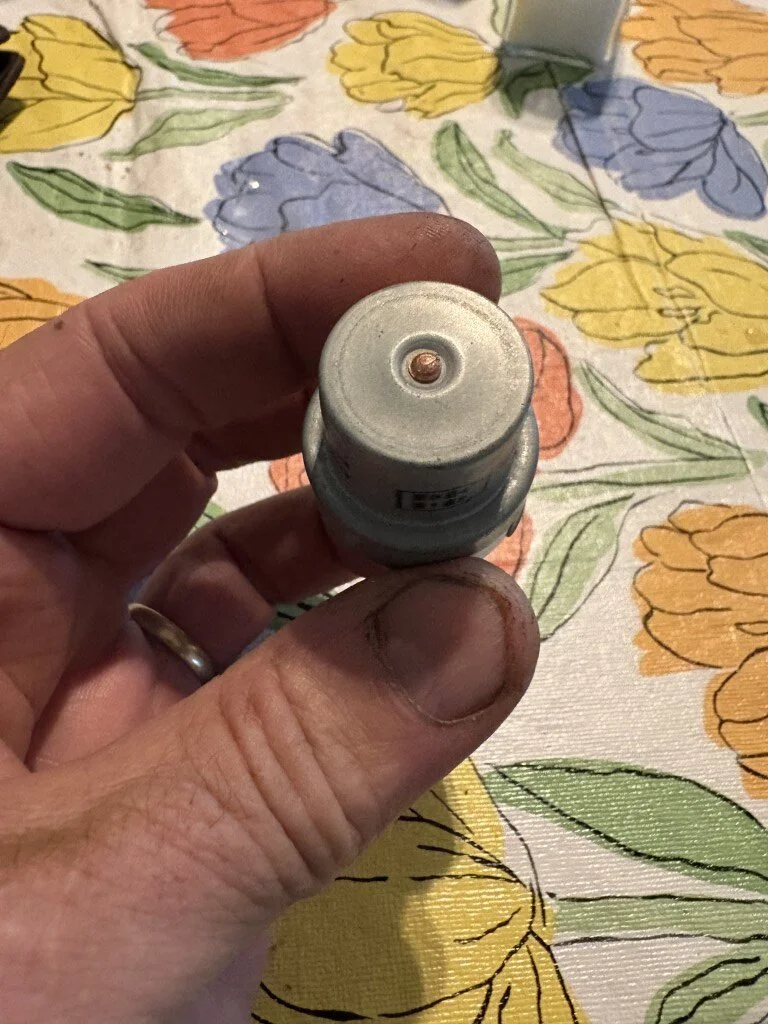

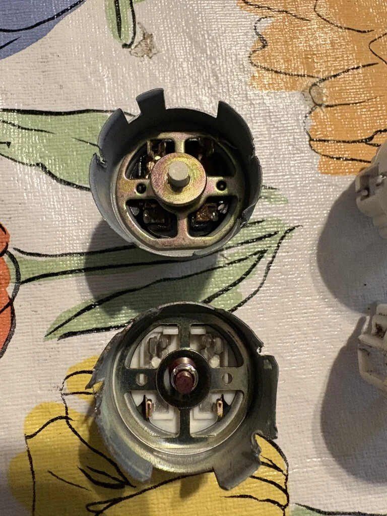

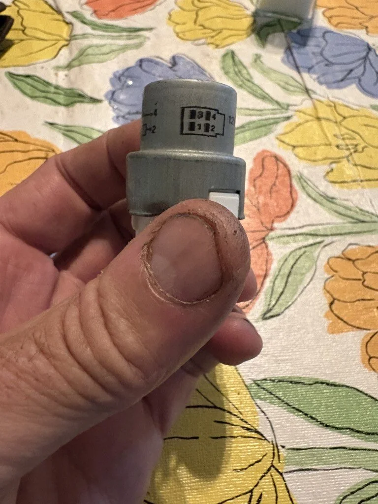

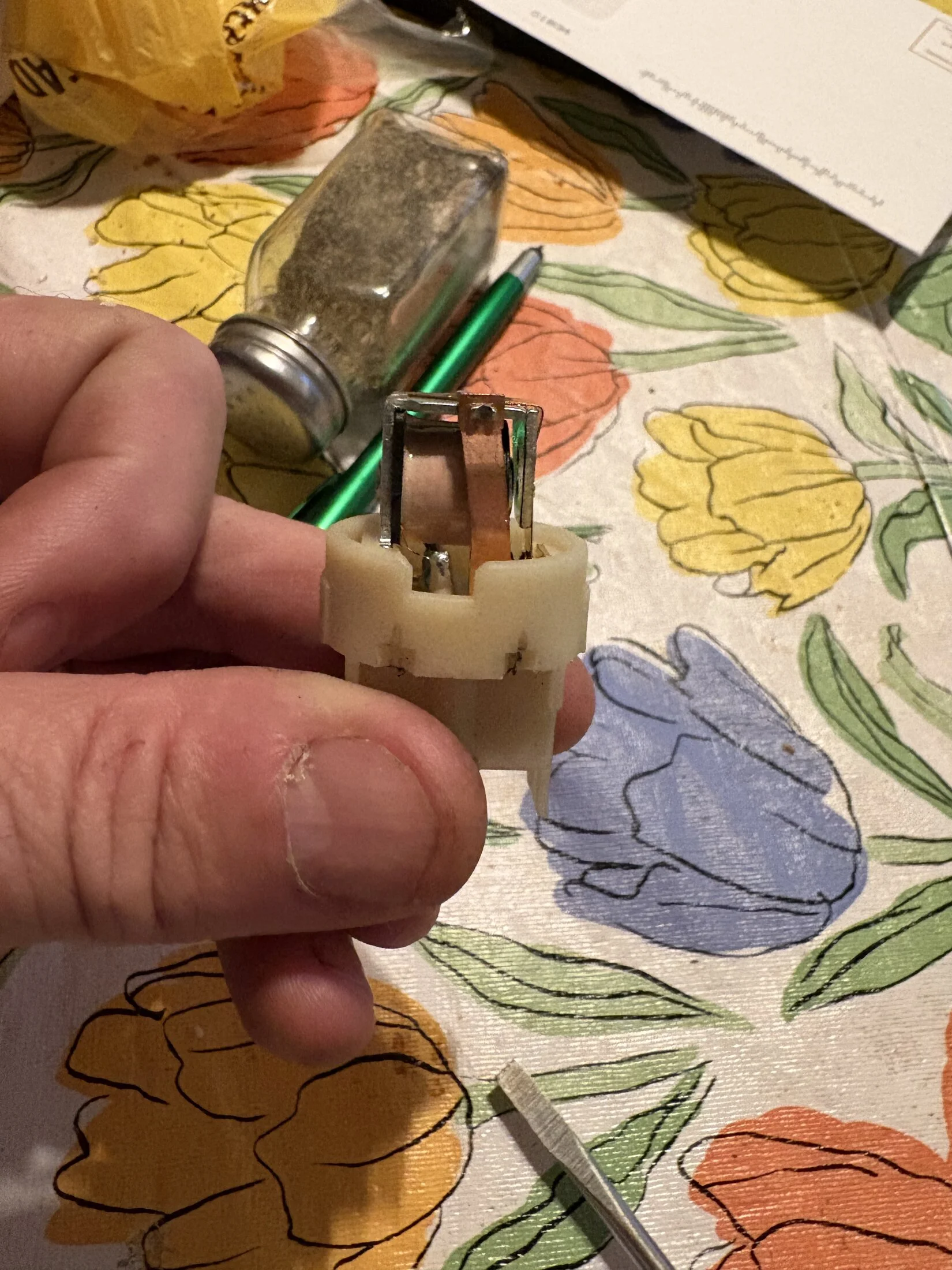

So I received my generic relay. I cut it apart and it's the identical build/design of the factory relay. I've requested a quote for a large Quantity with hopes of offering a very affordable 4 pack.
Attached are some pics, The first three are the outside views and the remainder 2 are of the guts.
I'll let you determine which is the factory item and which is the generic one .
I the give away is the one on the top shows it’s age.
I have to buy a bunch of them, but I think it’s worth it. A 4 pack of the non branded relays will be $12.00. Yup , $3.00 each.
