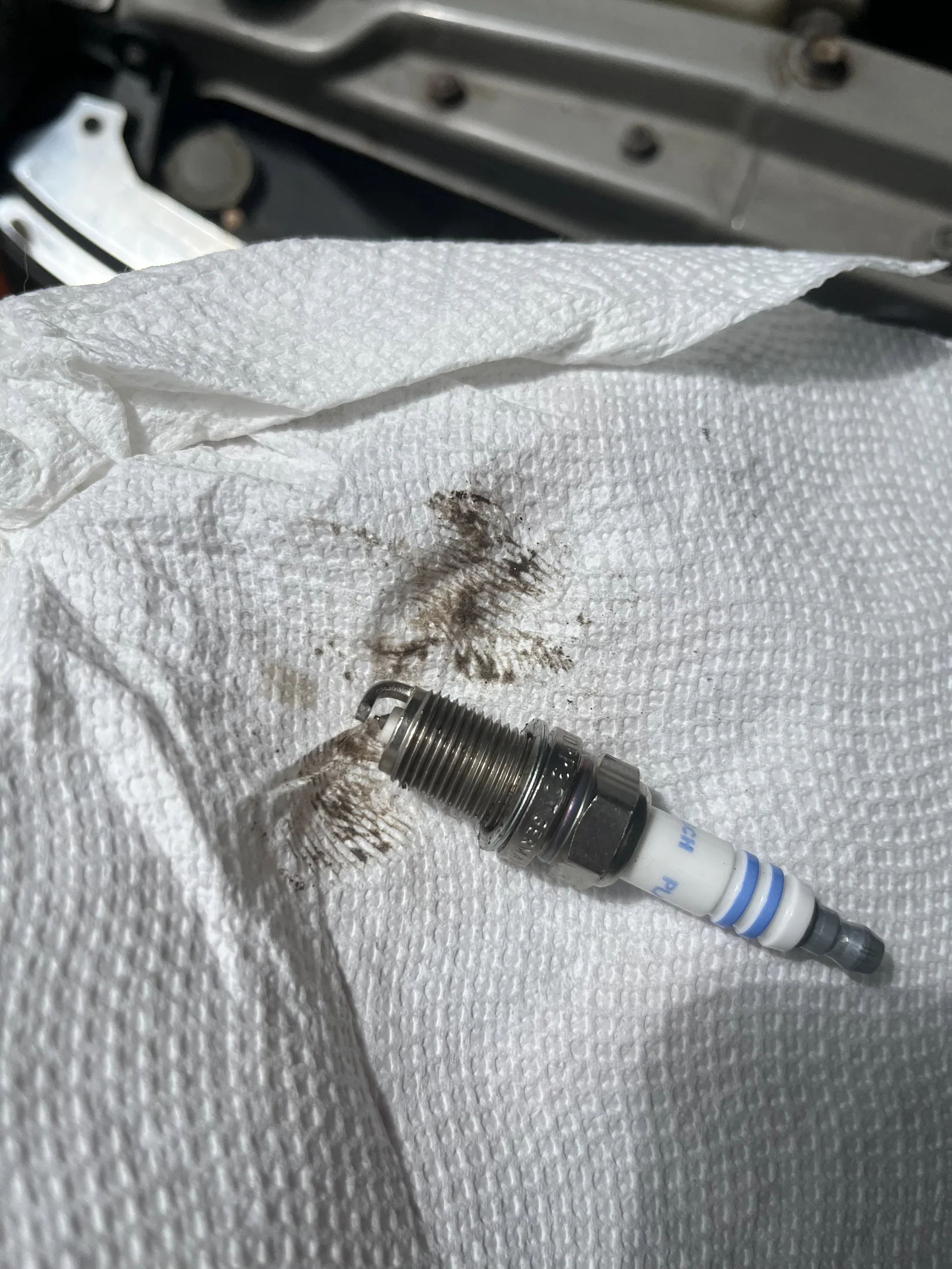

I looked at the harness around the EGR when the manifold was off and didn’t see any issues. I did change the dizzy O-ring recently and also the spark plug gaskets when I first had this issue, but not the valve cover itself because it looked alright. Maybe that was a mistake.
Just pulled a spark plug. These are newer plugs, but I’ve run the car a couple times since they’ve been installed just trying to diagnose the issue. Does this amount of oil indicate that the plug gaskets I put in aren’t working?
