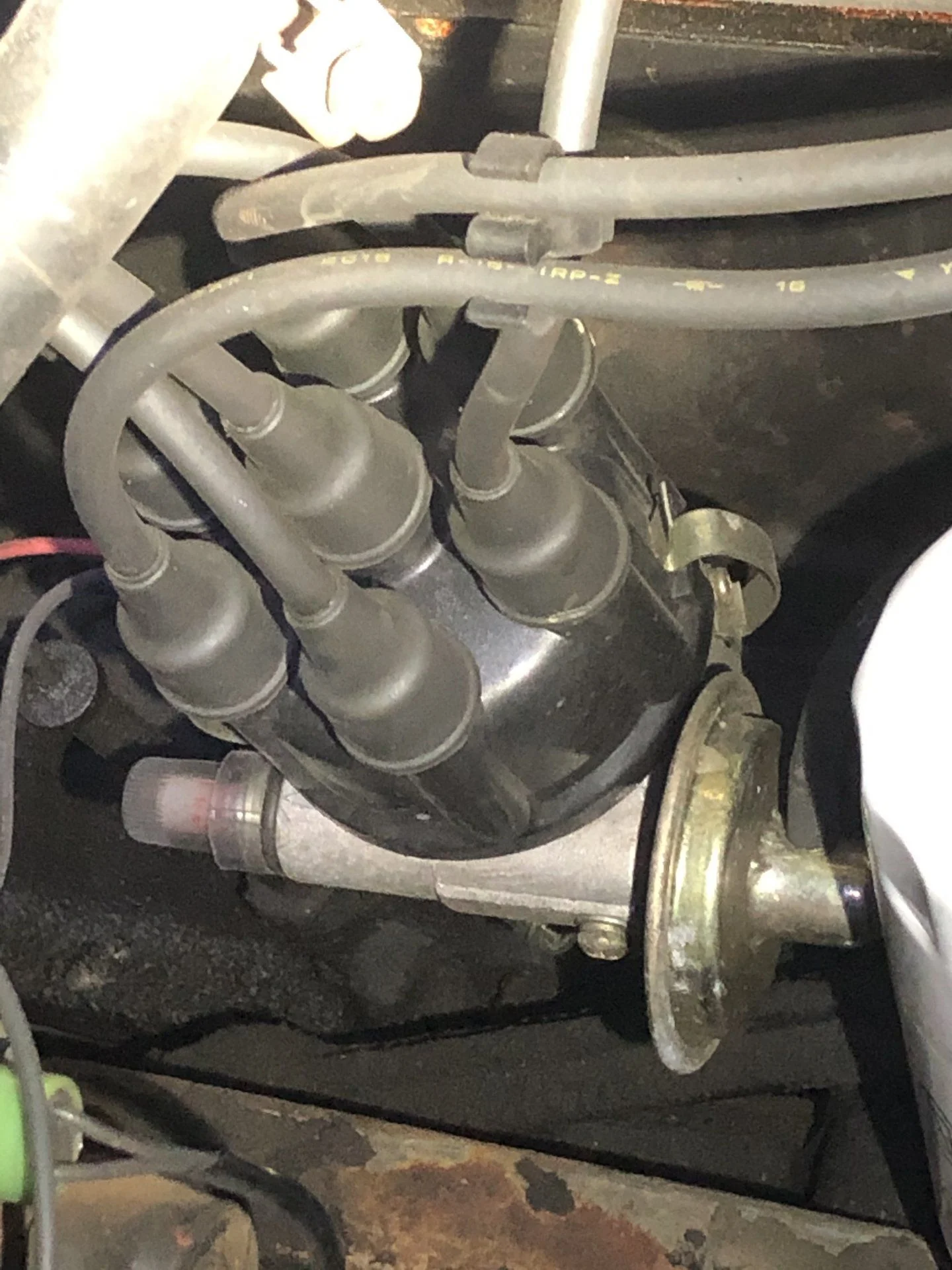

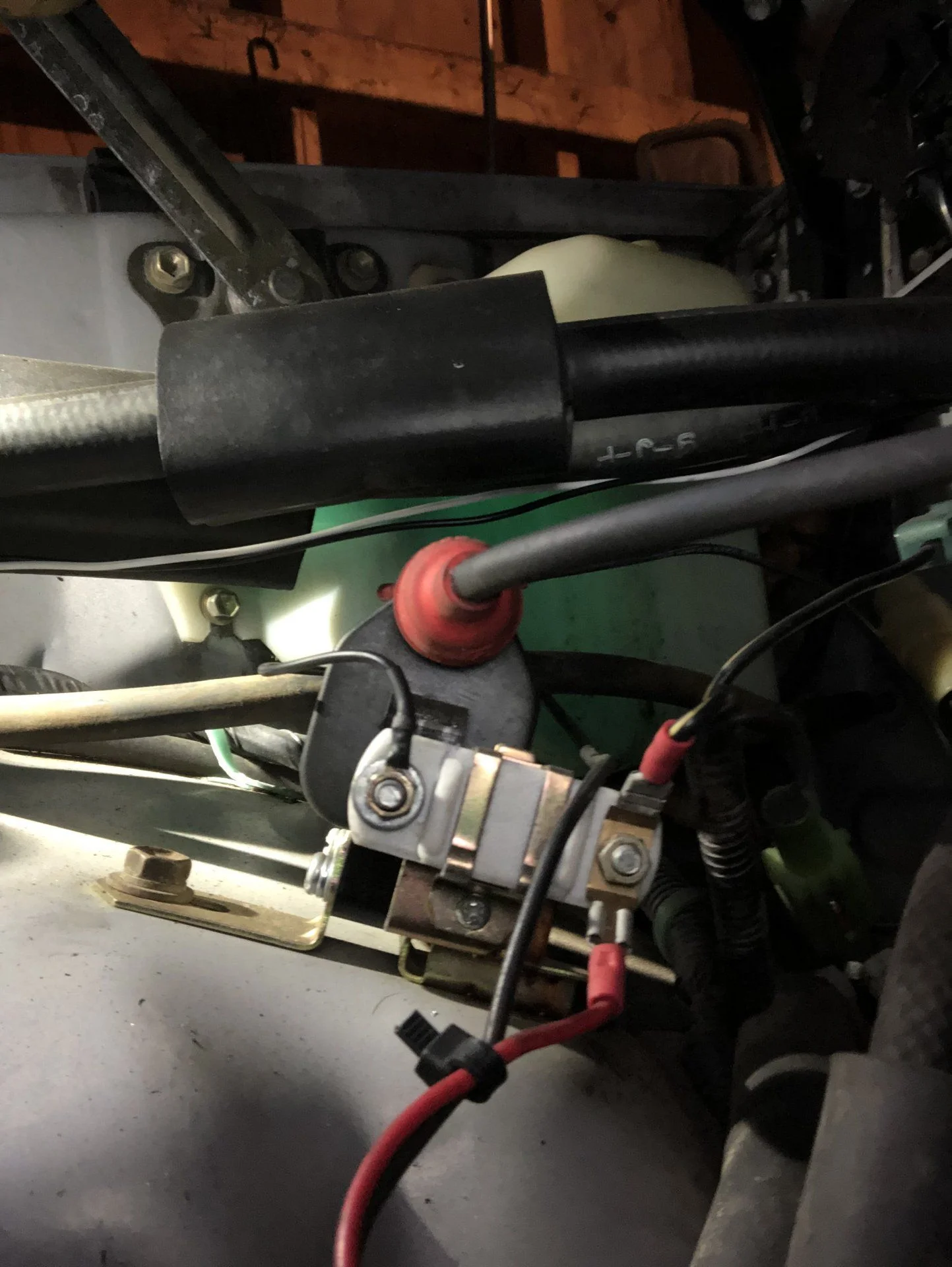

The stock distributor was replaced with a non-usa dissy or possibly aftermarket dissy. Also, the coil is one I'm not familiar with. Maybe if you get a chance, can you take and post a few high-res pix, please?

I can't really tell from the pix if that's a Toyota (Denso) distributor or a Trollhole (Chi-Com aftermarket). You have to unclip the side clasps on the cap and post of pic of the guts. Either way, it's not the stock dissy or coil/Igniter. Or, check for a foil Toyota sticker on the side of the dissy housing.
Coil looks like a Diamond Brand coil that that used to be sold by TPI 4x4 with a non-USA distributor (like yours) as a power package (it's not).
Either way, if it's running well, don't mess with it.

That looks just like the 19100-61080 non-US distributor in my '71 FJ40. I bought it used on the Pirate4X4 site more than 20 years ago. It was sold by TPI, which would make sense given @Spike Strip's input on your coil.
That would also make sense because TPI is a Nashville based shop and I’m not sure how long this truck has been in the Nashville area. The previous owner sold the truck through a Brentwood auto dealer (15 min south of Nashville). Not sure where he bought it from, but my guess is it’s been in the area for a minute or that he put it distributor on.
