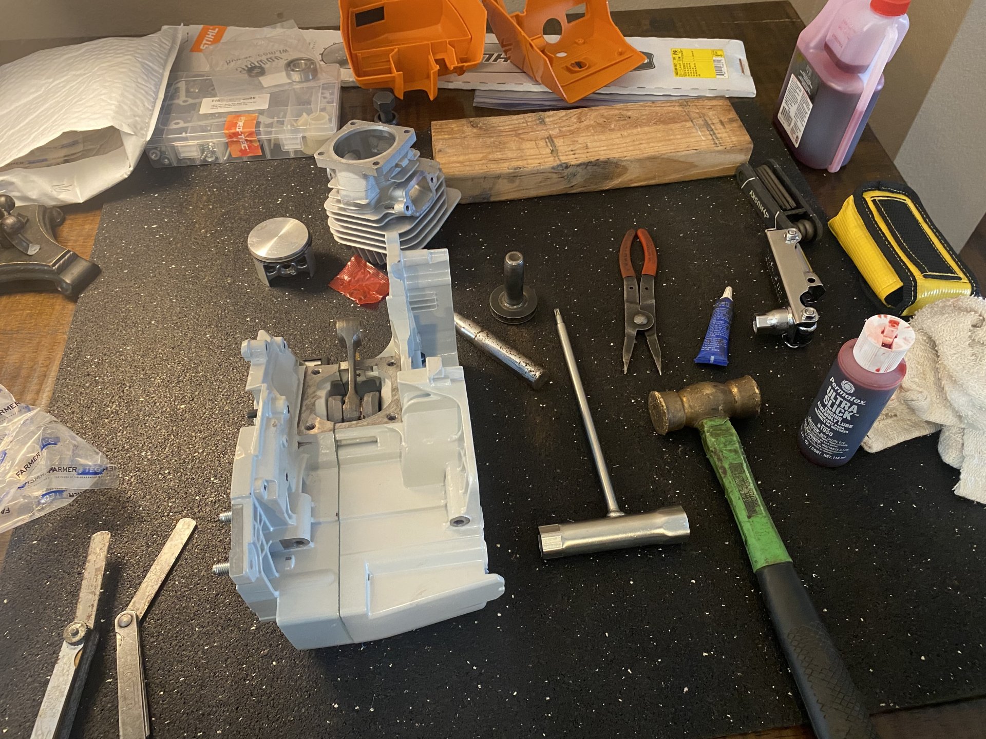

Started building a MS460 from scratch today using the Farmertec kit from HL Supply. Overall, I think the quality is pretty good. The head could use some polishing but it came with the sharp edges of the ports smoothed down. The wrist pin fit nicely in the cylinder. The kit was missing a couple crucial parts…the right size crankcase seal, throttle rod were the big ones.
Does anybody have any opinions of tolerance for the assembly of the saw? Got the crank spaced around .013 and .022. The rings provided are at .012.
Finally got the MS460 completely built and tuned-ish. The assembly was pretty straightforward with a build video on YouTube. All the steps should be similar for any professional style Stihl saws. 2hrs 20 mins long.

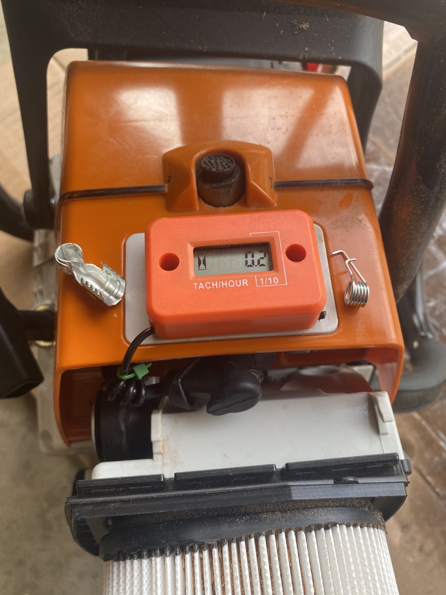

The stock, 1 turn out on the H and L, got the saw start and run. I could fine tune the L but got a little response from the H and no response from the LA with multiple turns from seated. It’s strange, but this is an off brand carburetor instead of the stock Walbro. It currently is idling around 2500 rpm and hitting a high around 12,500 rpm. Hard in a cut puts the saw around 9-10,000 rpm. I have a little over an hour of cutting time with it. My plan is to run 35:1 fuel for added lubrication. The saw won’t see a ton of use in the future…more of just a project. The money spent on a Walbro vs a $23 carburetor isn’t worth it. I’m also basing my tuning on a $20 tachometer.

Pics of after the build and with the added tachometer. Also, added a proper spark plug cap instead of the odd spring that pokes two holes in the plug wire.

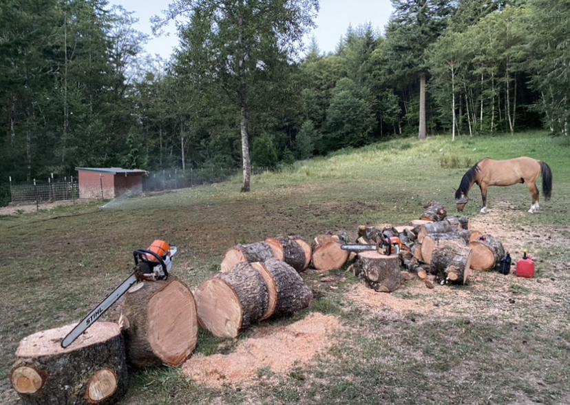

Just spent eleven nights at our mountain place, took two loads to our friend’s store during that time. I’ve gotten bad about getting firewood pictures, I keep forgetting. This is from our first trip.
The first three pictures are from a few weeks ago.

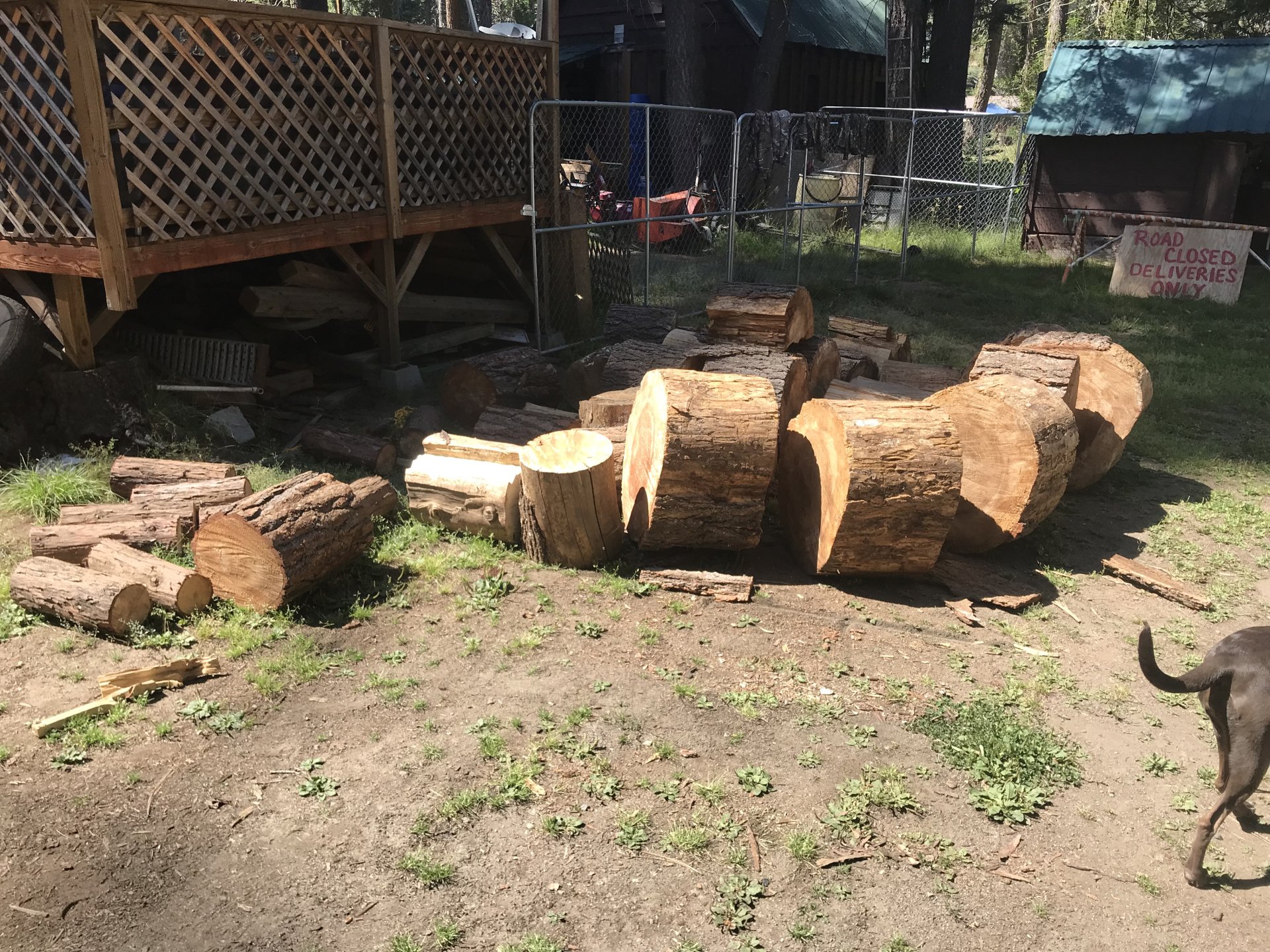

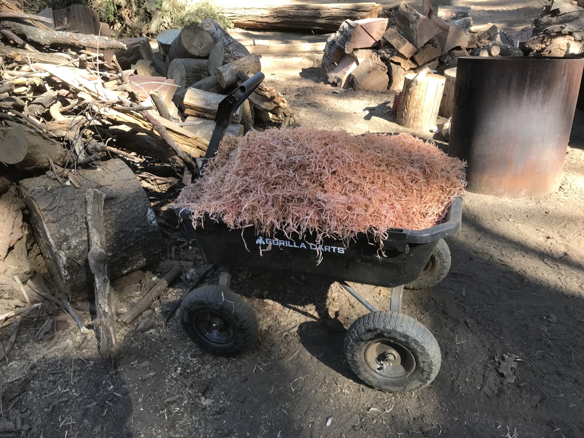

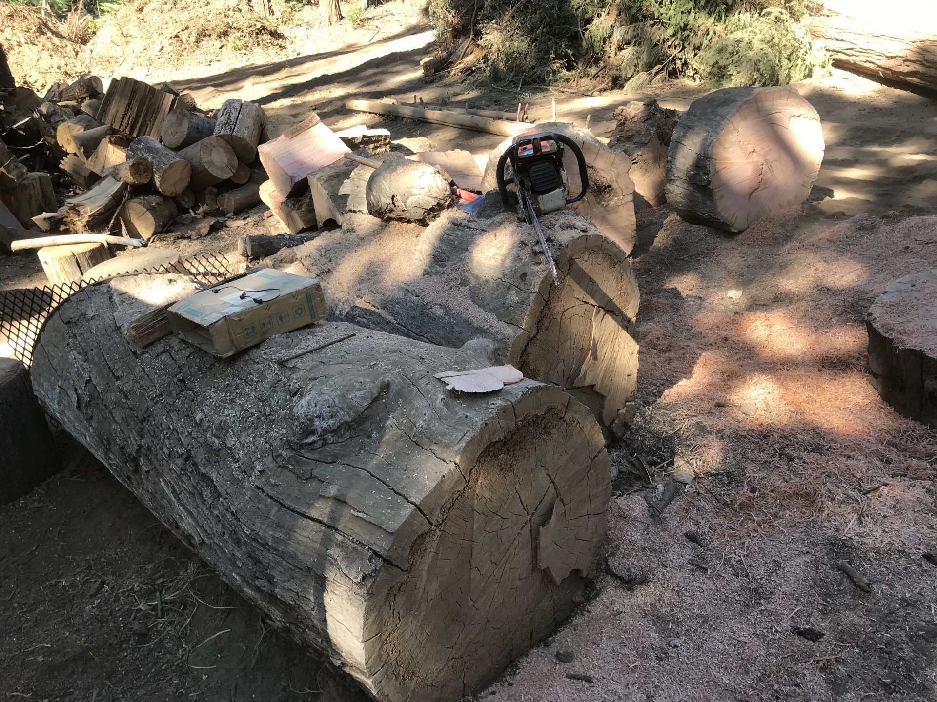

I cut rounds into quarters or eighths, because we didn’t bring the splitter. They’re too heavy to load when whole. Cutting with the grain makes long chips like this, this is about half of them. Some people sell them for fire starter or animal bedding, but we just burned them.
This wood looks like it’s been dead a very long time. As usual for logs this size it’s only dry about three inches in, the middle is very wet. And it’s mostly good wood.
I only cut up one of the three logs.
The biggest piece is still up the hill, we’ll probably drag it down and cut up all of it early next season.

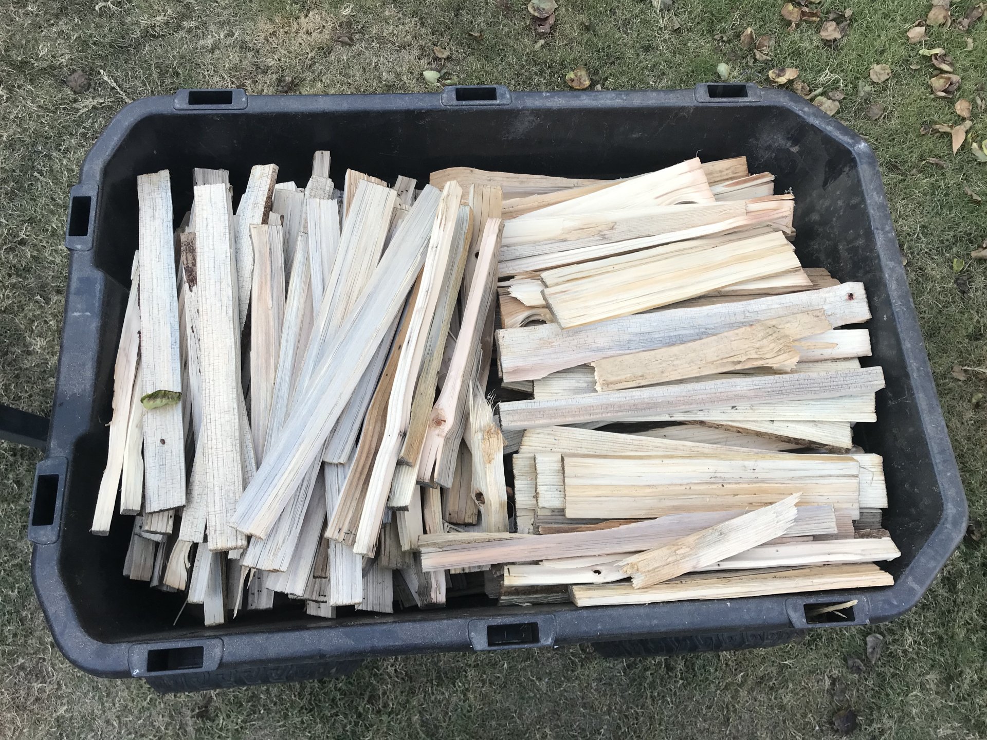

At home I made kindling from well seasoned softwoods, pine and cedar. I used the hydraulic splitter to do this. It won’t take a sliver off a log, but it will split in half until this size.

If you do that a lot you might consider getting a ripping chain. The cutter pitch is set around 10-15 degrees instead of approx 30 degrees for a standard chain.
