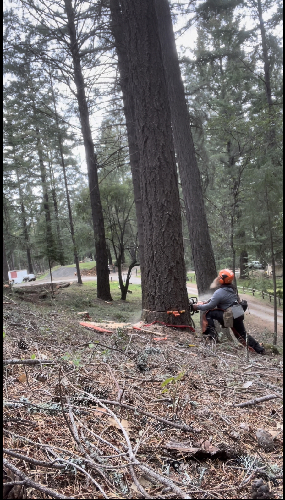

Humboldt cut, that’s what the loggers do. They say two reasons 1. Better control of the fall 2. Less waste.
OK
I didn't look at your face-cut carefully....I see the Humboldt now. 👍
Should have noticed....I use it a lot.

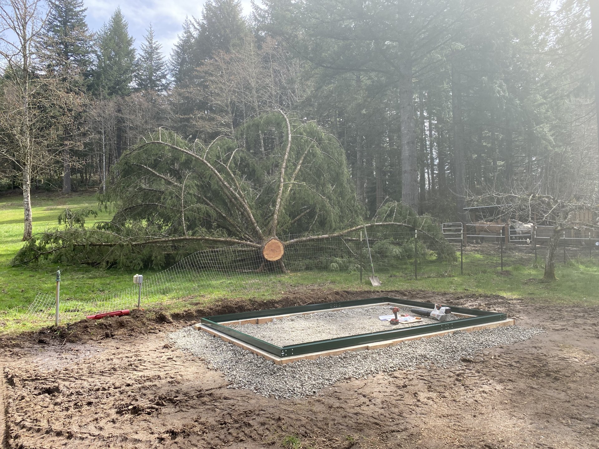

I’m curious why you brought that tree down in the first place.
Putting up an 8x12 greenhouse
With that fir tree gone it’s the best location on my property for sunlight. Need to get this done for the wife so I can take about 11 days off at the end of April to work on my Crater Lake property.
Go figure… you setup a greenhouse in 70F weather and then old man winter steps in during the middle of April…

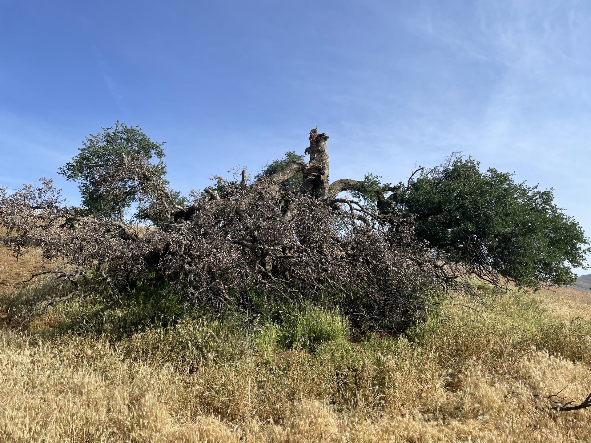

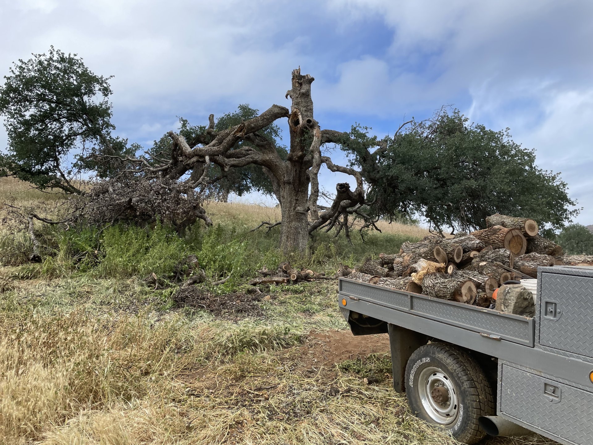

Felling several hazard trees for a Boy Scout camp.
"Leaners' to boot! Those are always fun.
Good job....!
I can tell a Pro when I see a good escape route, looking up to see movement of the top, proper use of wedges, wearing PPE and using good equipment. 👍

Good of you to utilize the resource from an otherwise broken up and dying tree. THAT is proper stewardship IMO.
I'm guessing a mature Blue Oak would be a fairly prized tree to have if the pics of the landscape are representative of that area?
I know it varies spot to spot.
Some places out West look so 'open' to me. I am used to having to weave my way around the trees (Pines and Hardwoods) where I live.

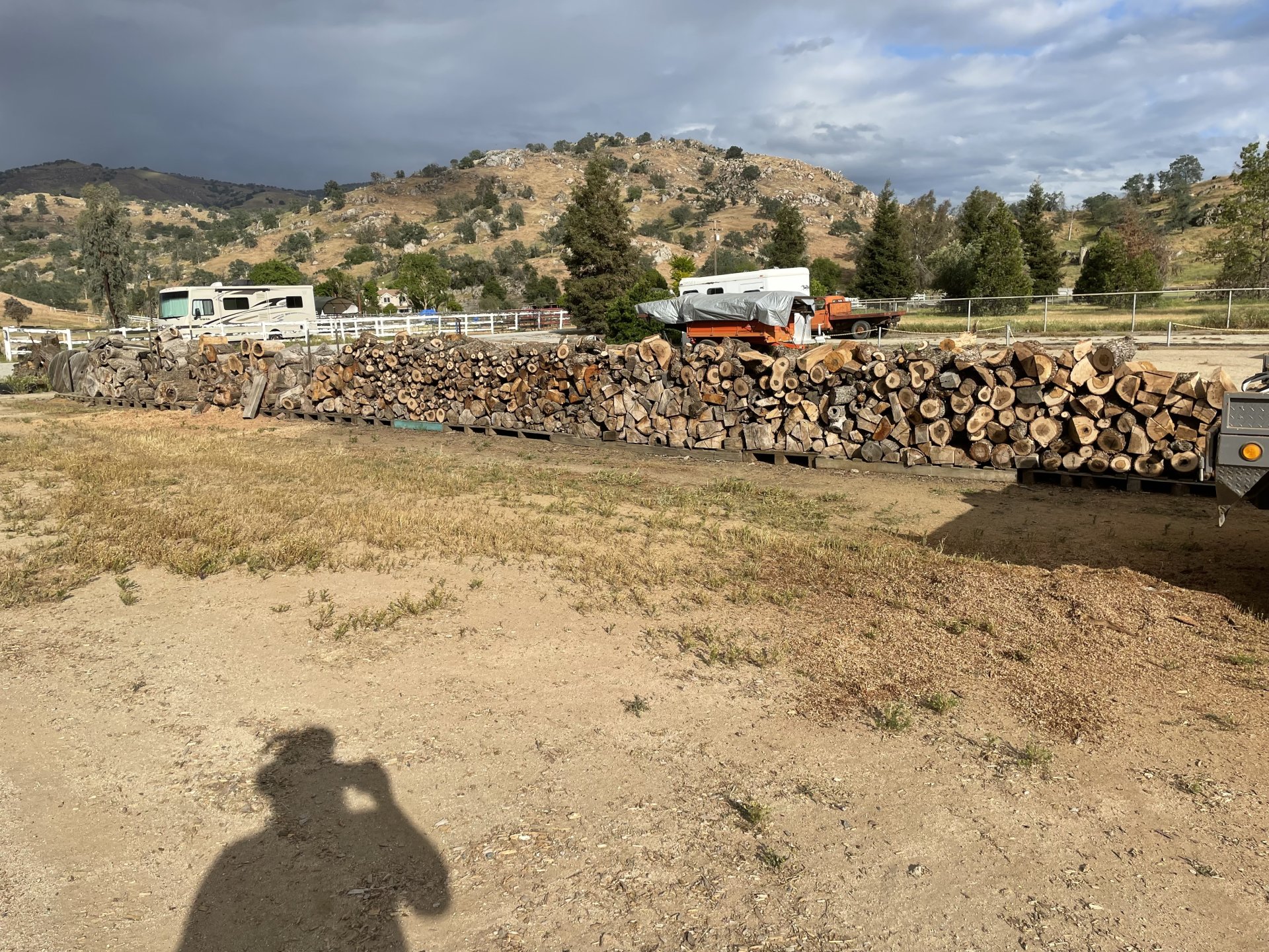

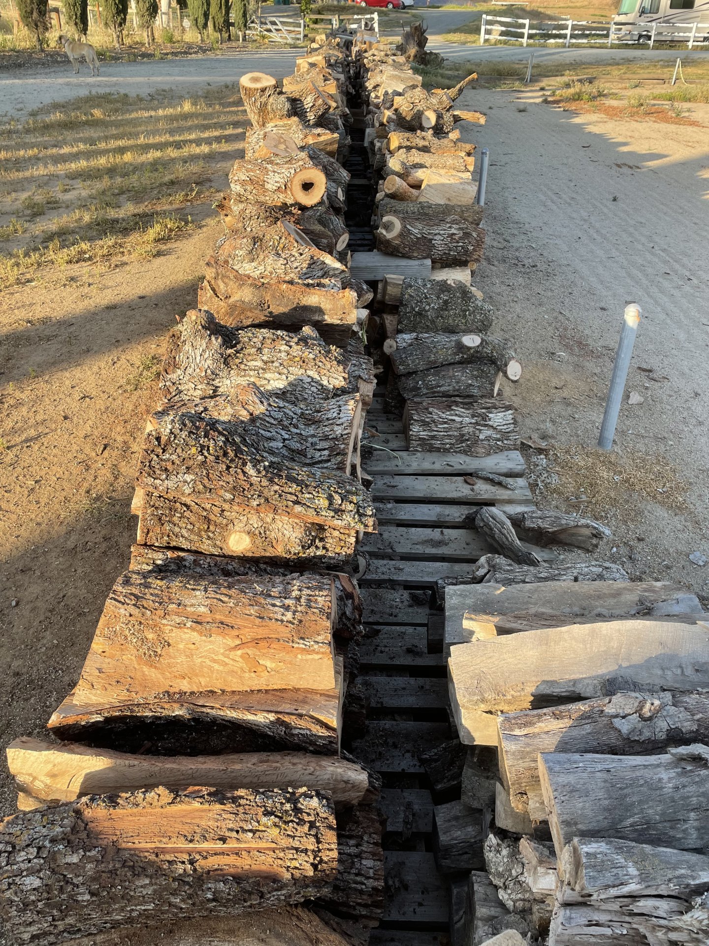

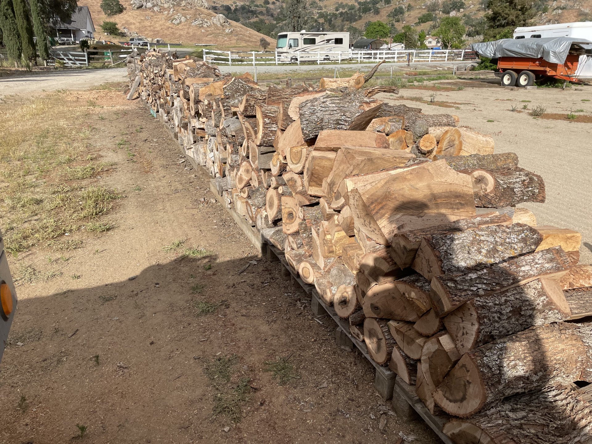

That's one heck of a pile of firewood. Good job taking care of the land. 👍
Had a rough day, maybe 2 cords between both trucks.
