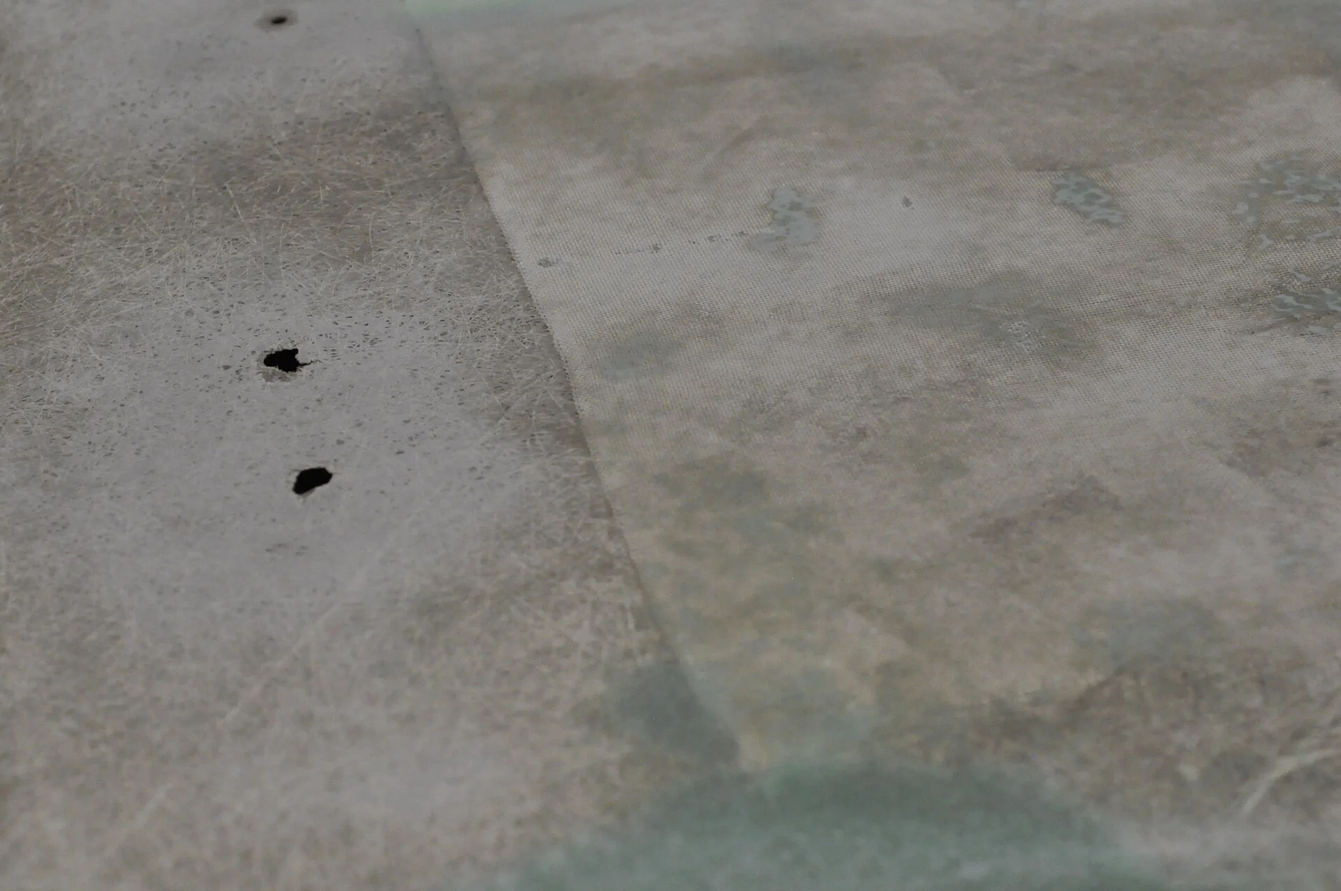

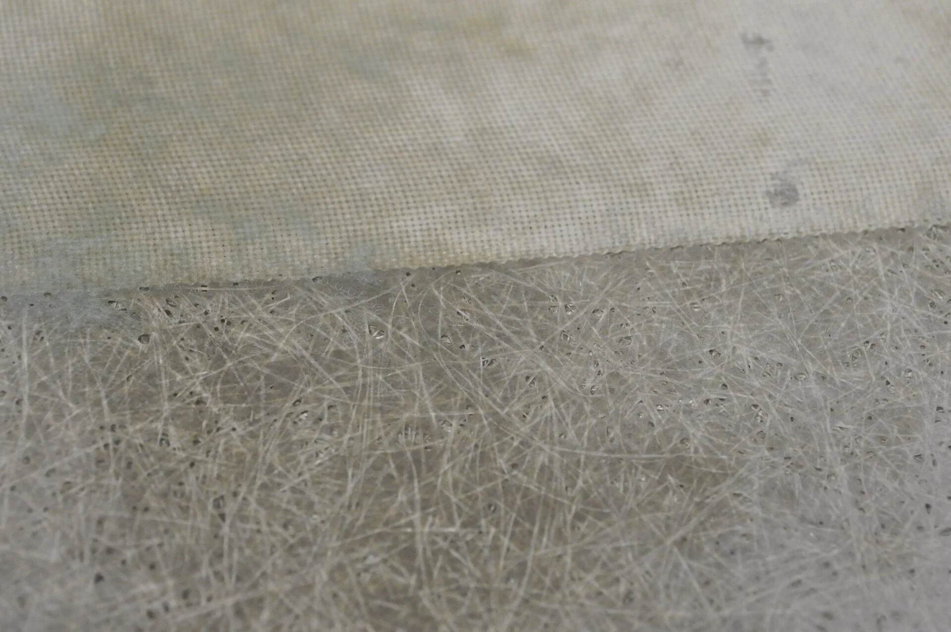

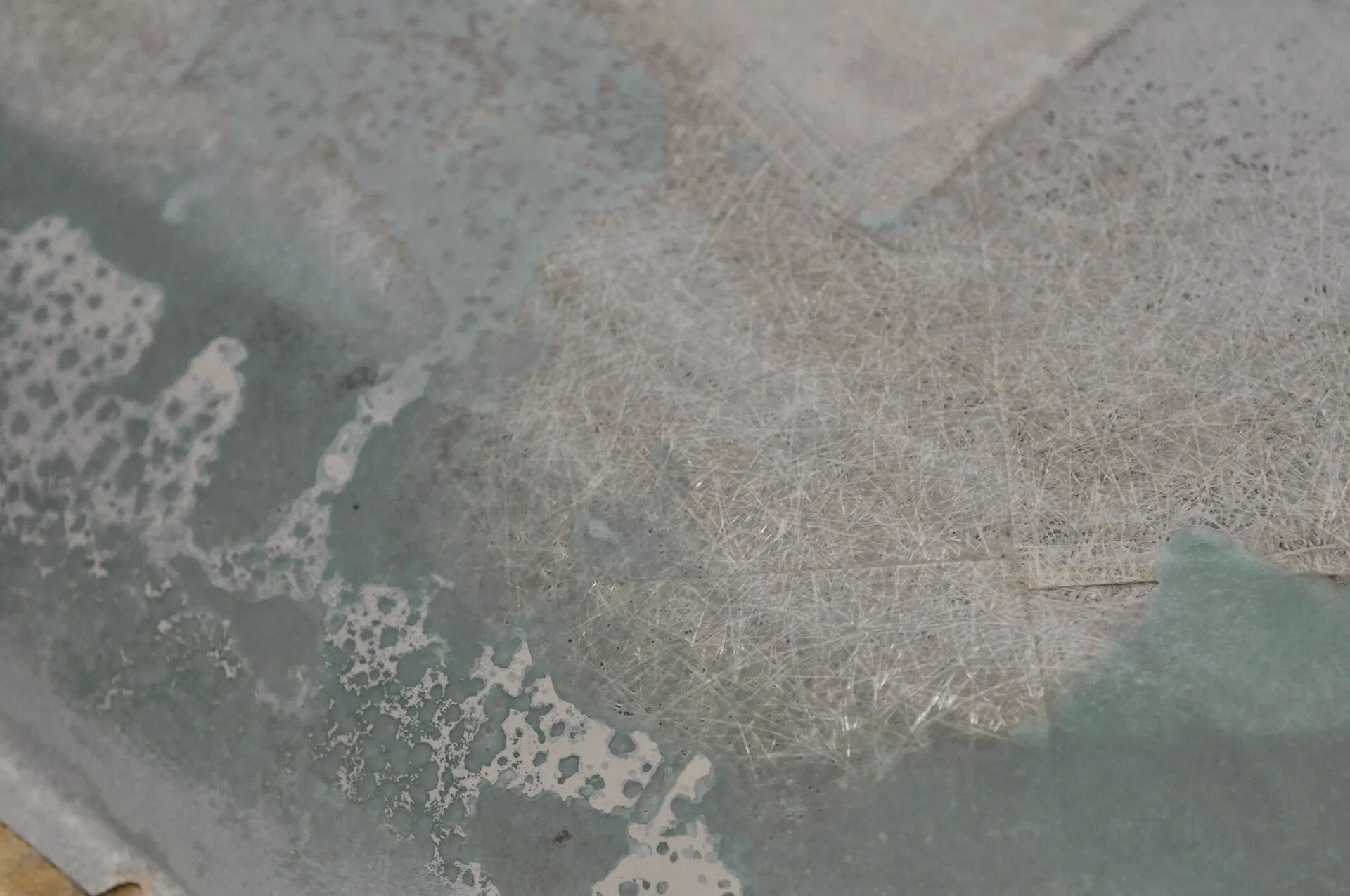

Just starting to restore a my 67 fj40. I have the fiberglass roof off and getting ready to repair the holes and dings. The outside is heavily weathered and the cloth and glass strands are exposed. Were these initially painted or gel coated? This has some remaining white coating in places over a green primer(?) layer over the glass. What's the best way to proceed, paint or gel? Many thanks from someone on a very steep learning curve.

The last time I worked on my top I just sanded the surface smooth, sealed the gutters with seam sealer, then hit it with some gloss rattle rattle can paint, probably 3-4 coats in all.
There was some damage done to my top in Jume and my gutter clamps have wrecked havoc on the seam sealer, so I presently have my lid on saw horses in my garage about to do a little rehab.
Gel coat would be the best long term solution, but regular old rattle can would be a whole lot easier to touch up.
Pretty sure you want Gel Coat. As much as I appreciate DIY, I have found some things are better (and sometimes cheaper) to leave to the experts. I would at least take it to a boat place and ask for an estimate. If nothing else, you will learn how they would tackle the refurbishment.
The tops are multilayered and the pictures show something but the feel of the top says a lot more. Good advice on seeking help from repair people. Restore it best now for a lasting piece of history.
And welcome to a life of….. fun!! 😳
We've owned my '76 since new, and all indications were that it was painted with Cygnus from the factory. Given the rail, seam sealer, and visor/rivets needed paint as well, I suspect that was done for easy of assembly and finished. The steel rail was definitely not pre-painted, as there was minimal paint inside the lip.
If your top is heavily weathered, the glass might need some love in some form...but I'd wager you'd still end up needing paint as the final topcoat after assembly.
Heed my warning... the roof is a brutal job. I disliked every minute of working with fiberglass. I would have botched the job big time if it wasn't for @zerotreedelta and his Youtube videos. I have a write-up on how I tackled it if you want to check it out.
In all seriousness, fiberglass is icky stuff, but take your time, and it will come out nice.
I’ll be doing the same to mine next week. I just don’t have the energy or $$ for a fiberglass pro. Going to sand the multiple layers of paint with some 80 grit, epoxy primer, seamseal, and paint with a single stage Cygnus white. I’m expecting it to be good enough.

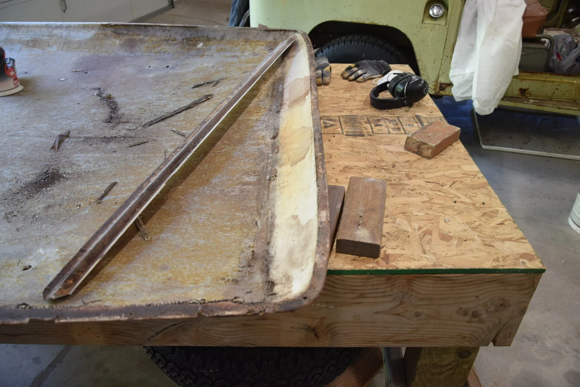

Thank you all or your advice, very helpful and informative. I'll probably be using something from each of you. Here's a few pictures of what I'm doing. The roof was bedded in the drip tray with what looks like burlap and resin. I ground that off to get back to the original glass. Now I have to repair the edge with new glass and reinforce it. I'll also be patching the holes in the roof left from a rack.
