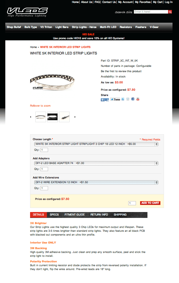

A very small but useful, simple and cheap mod: Better illumination from the anemic OEM glove compartment lamp.
Parts: Sourced from VLEDS
1) 12" white 5k interior strip light, 3 chip 18 LED with 3M VHB adhesive back (STRIP_3C_INT_W_5K): $7.50
1) DIY-LED base adapter 74: $1.00
1) DIY-2 wire extension 12 inch: $1.50
Remove the tiny #74 size filament bulb from the glove box light fixture (sorry...no pics but this is a point 1 banana job ;))...and swap in the base adapter and wire extension (disclosure: I can't remember if I actually used the extension wire or not...but given its only $1.50 have it on hand just in case).
Trim the LED strip to width. Using alcohol and a clean rag wipe the area of the dash, just above where the top glove box lip resides when its in the closed position. Press the LED strip into place and let it sit for 72-hours...this is the time it takes 3M VHB to fully "cure". Connect the LED strip to the adapter wire and secure the excess wire as necessary so not to bind/get pinched when the glove box is opened/closed.
