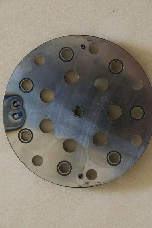

After swapping in the latest incarnation from the Toyota engineers :rolleyes: of the ignition's intermediate shaft yesterday as a solid DIY PM project I moved back to my OBAv2 system for a little mod.
The Sanden compressors are designed to push oil/lube rich freon throughout the system whereas an OBA system should keep the lubricant on the crank side of the pistons, as much as possible, and away from the head side of the pistons is supposed to be mobetta. This is also a little mod that is apart of converting the Sanden to a grease based lube system.
For airing up tires the small amount of oil vapor that exits isn't a factor. However for filling air mattresses, blowing the dust out of the rig at the end of a dusty trail day, etc., I'd like cleaner air. And my OCD ways contributed to this project too :lol:
Not quite ready to go to grease but wanting to try to keep more of the lubricating oil on the crank side and away from downstream pressurized side of this system I'm opting to stay with oil for now.
There are a few threads out on the interweb about this conversion so I wasn't reinventing the wheel. However all the threads I've seen pertain to the 508 Sanden which is a 5-cylinder. Basically you drill, tap and thread in a Loctite coated grub screw into the small hole in the head's reed plate to help keep oil from being pushed downstream of the crank side.
Since I'm running an SD7, a 7-piston Sanden, I discovered I had two not one of these ~5.2mm holes in the reed plate. It really wasn't conducive to push the diameter of these holes out to 1/4" diameter grub screws, the next viable size given the diameter of the holes in the SD7, so I opted to TIG them shut. To keep the filler rod from flowing past the critical piston side (not a big deal if you have a surface grinder...but I don't ;)) I used a small copper plate...worked great. This eliminated the need to dress the piston side of the holes you see in the photo. Not pretty but it'll get the job done.
The 2nd part of this project, since plugging these holes prevents breathing of the crankcase of the Sanden, is installing a crankcase vent. Another thread I found on-line used an ARB solenoid switch for this purpose. So I've got one ordered...but essentially I'll run the ARB solenoid switch (from their lockers), connected to the switched compressor clutch so activation is apart of the clutch engagement (this is a good thing), from a tee fitting atop the Sanden. The other side of the tee fitting goes downstream to a return from my coalescing filter.
More to come after I receive the ARB solenoid switch.
