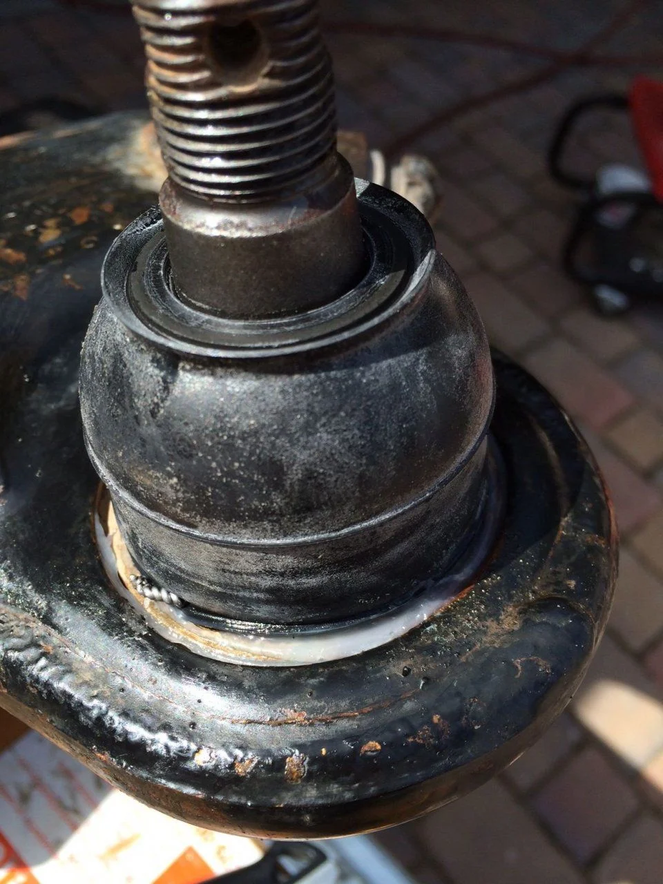

Needed to reboot the lower balljoints; one was torn and I had silicone patched it and the other, well I just was curious how contaminated the lube would look after being run for 4-years.
The boot kits are available from Toyota as an OEM part; my good friend Onur Azeri aka beno at Nalley Toyota in Atlanta (OAzeri@nalleycars.com) always takes good care of me.
Replacing the boots is a very simple job once you get the knuckle separated from the ball joint. There is a spring clip that compresses the rubber boot to the groove in the balljoint. Using a small flat blade screwdriver you simply pry the spring clip, slip the boot off and then, using brake cleaner, get all the old contaminated grease out of the top and lower section of the ball joint cavity.
The balljoint boot kit comes with the rubber boot, grease and a spring clip. For whatever reason, I've rebooted these many times over the years, the spring clip Toyota provides in the boot kit is not the same type of clip they use at the factory when they assemble the same. The spring clip in the kit is very soft/pliable steel and very easily distorted when trying to use it as intended. Basically there just isn't a way! The material is very similar to aircraft type safety wire...and that's how I use it to retain the boot to the ball joint; works perfectly.
The flat wire spring clip in the photo is what Toyota uses at the factory (or whatever corp does their lower ball joints and/or LCA). The round wire variant is what is supplied with the boot clip.
And a note about the grease: I'm not sure what type of grease it is, presumably lithium base, but its thick and sticky...the perfect grease for ball joints! The grease within the undamaged boot was 100% clean and uncontaminated. After 4-years of big trail miles I am very impressed!
I posted this for the benefit of those that ask about the reboot process on occasion...hope it helps someone down the trail.
