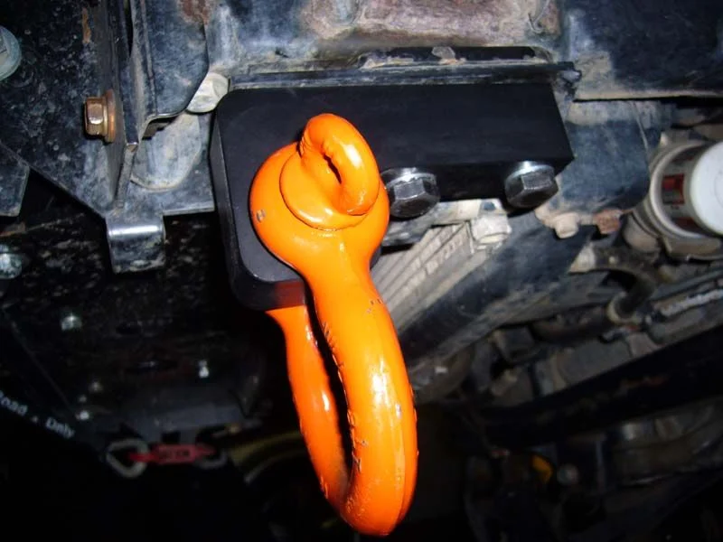

Then the Warn 9.5XP winch with X-Line was added...had to make a couple new mounting brackets as the TJM is designed for a smaller winch...but it all fit just fine. And along the way I just couldn't get past the goofy OEM frame mounted hooks. And since the bolt spacing is atypical...and no after market recovery hooks available I, along with a couple buddies...you know who you are!...designed the Frame Recovery Brackets for a small production run. The TJM hoop was removed earlier this year...and I sliced up some thick plate I had in the garage and welded the current recovery points to the front bumper...

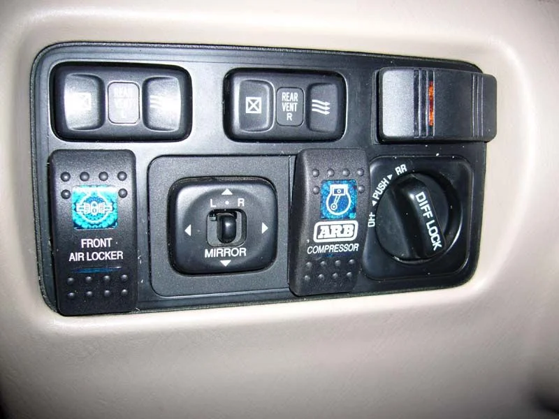

A little over a year ago I installed the ARB front air locker along with completely rebuilding all axle/hub bearings, new OEM CV shaft assemblies, 4.88 gears, 315R75-16 MT/R's and ART cryo'd rotors with Porterfield kevlar and carbon pads and custom stainless steel brake lines throughout.

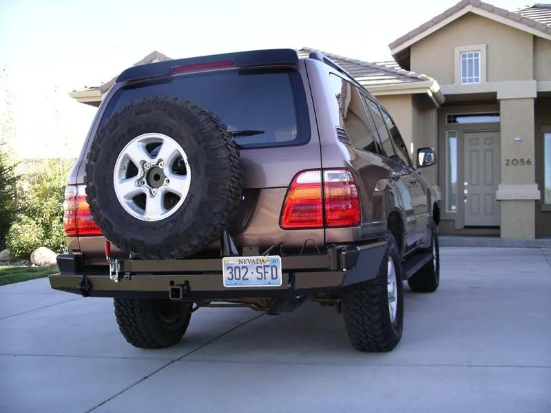

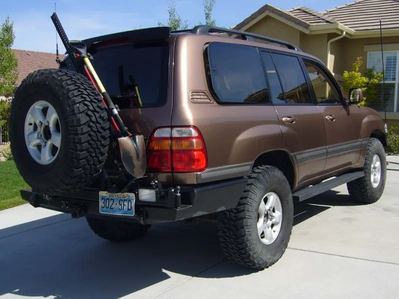

The first three pics were taken right after I purchased it and right after I installed the 285R75-16 MT/R's...

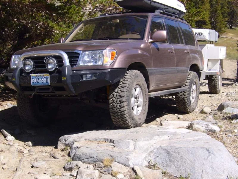

The sliders were the first project I built...and then on to the OME lift.

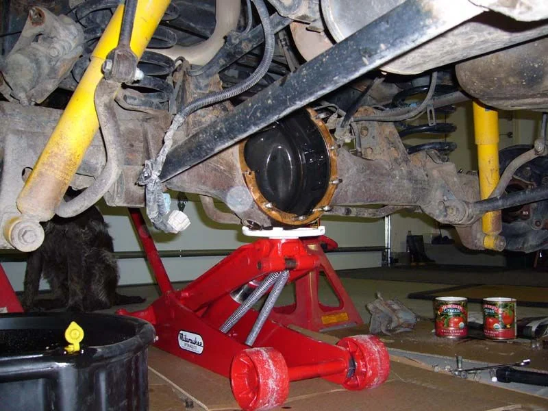

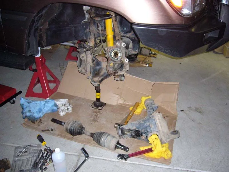

The 4.88, ARB locker, etc., etc., 6-week down and missed some cool runs project.
A couple nice 40's from a run with the homies before the 4.88 tear down...
Rear diff...before the 4.88's were installed...
Front diff...and the problem solver ARB locker fitting...
Switches...no factory look for me...

Custom Frame Recovery Bracket.

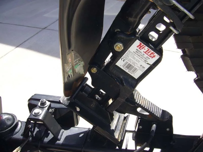

A custom little bracket to secure and keep the winch line out of harm's way.
My second favorite accessory...ha ha...
And another little weld on support to keep the shovel blade centered.
God I love having a welder!
