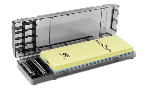

I go old school with my knives...and use a "water stone" to sharpen my knives. A couple times a year is usually good for me.
This is what I'm currently using.
