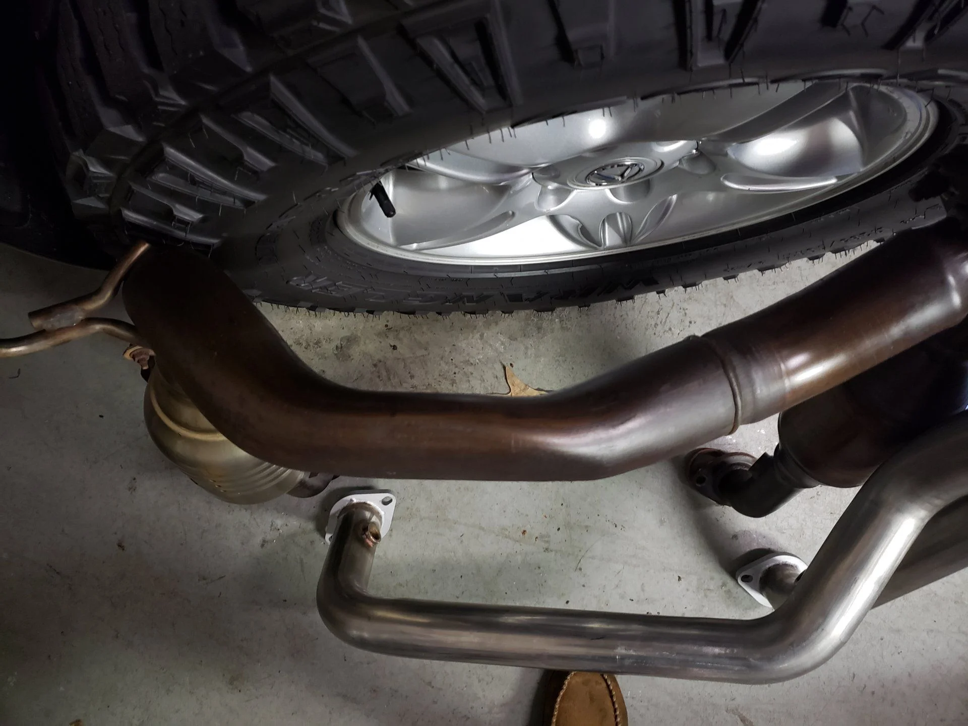

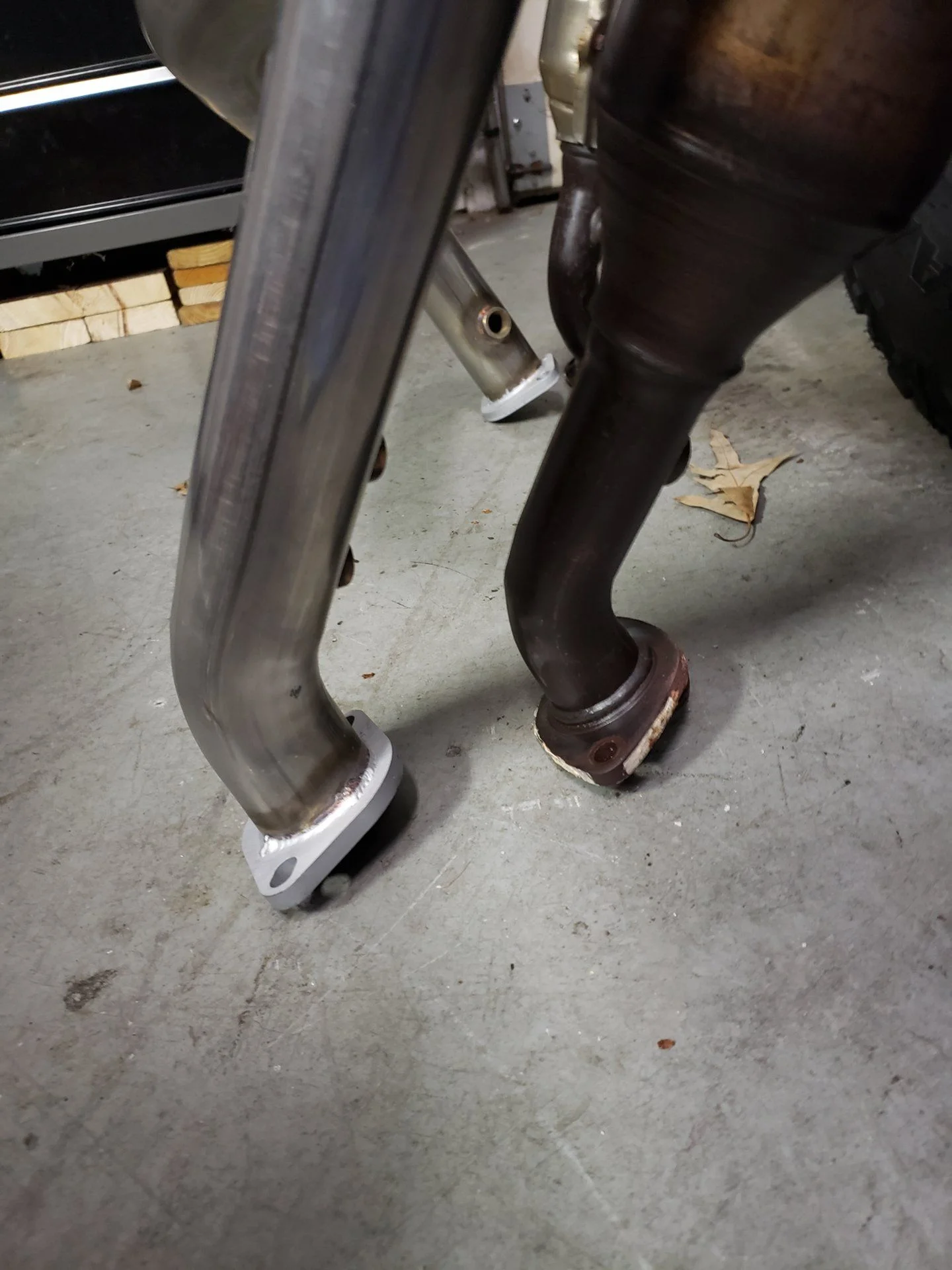

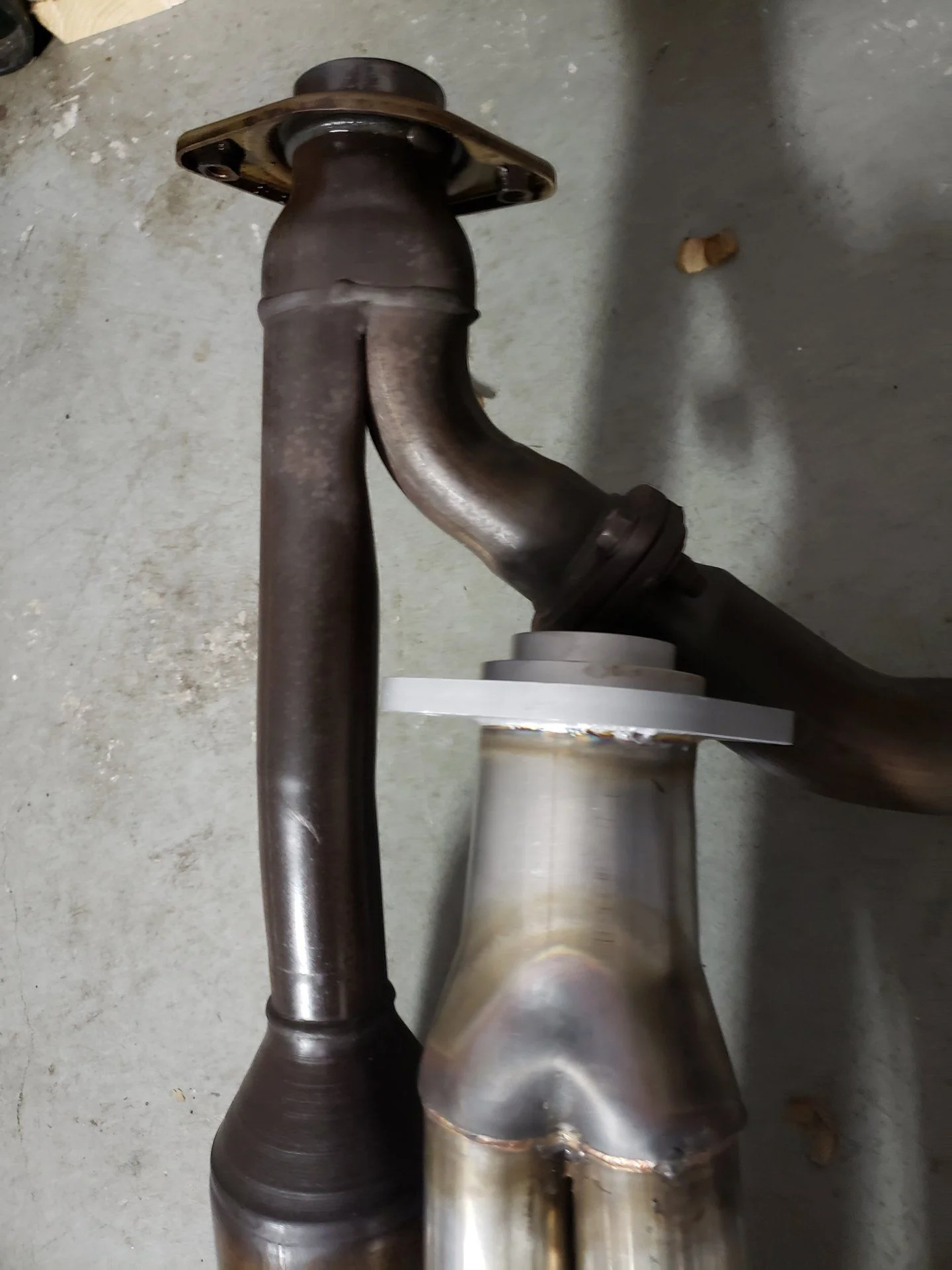

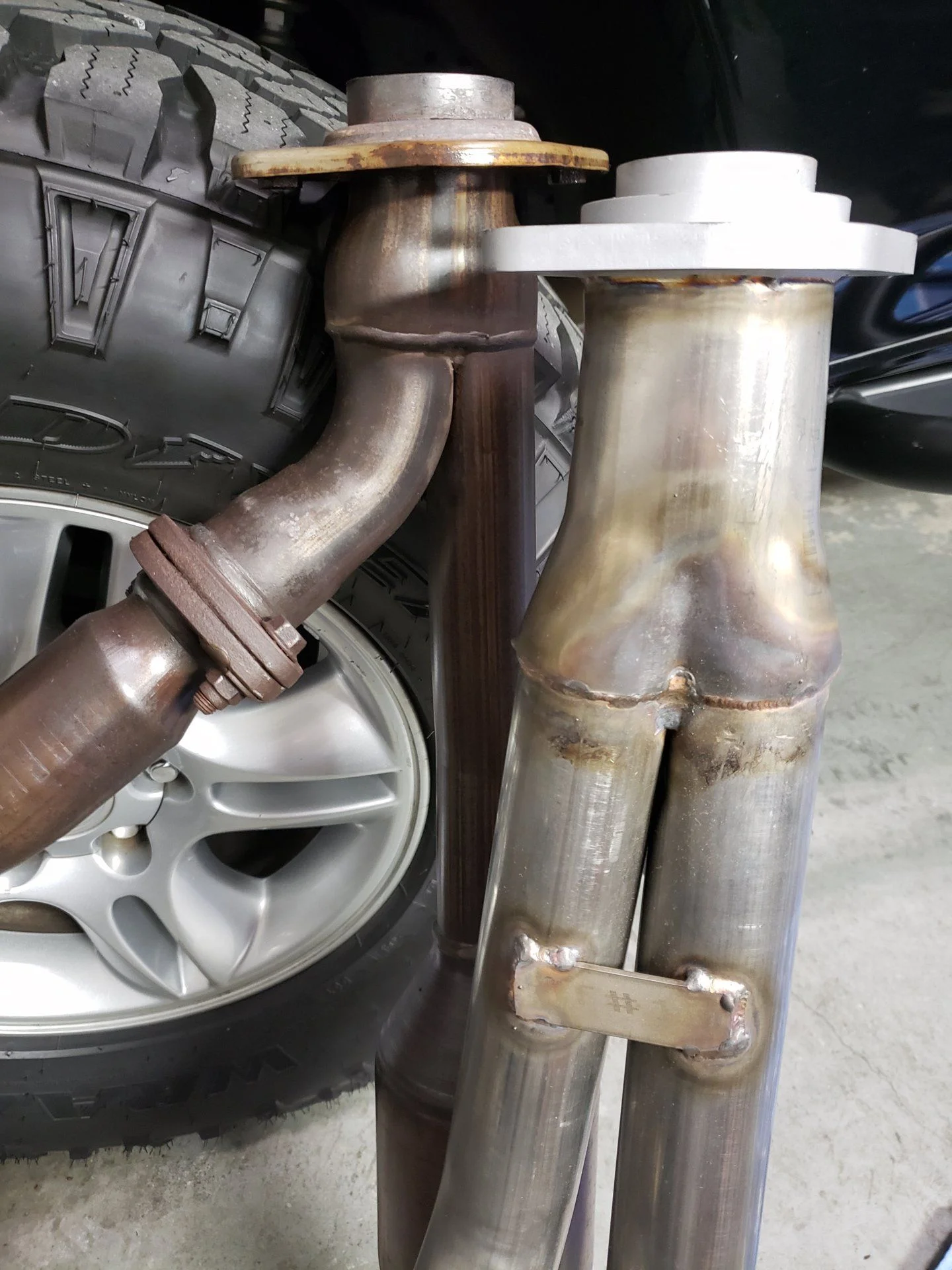

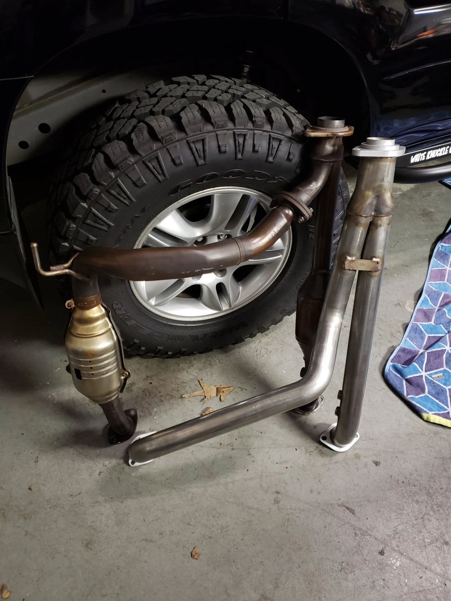

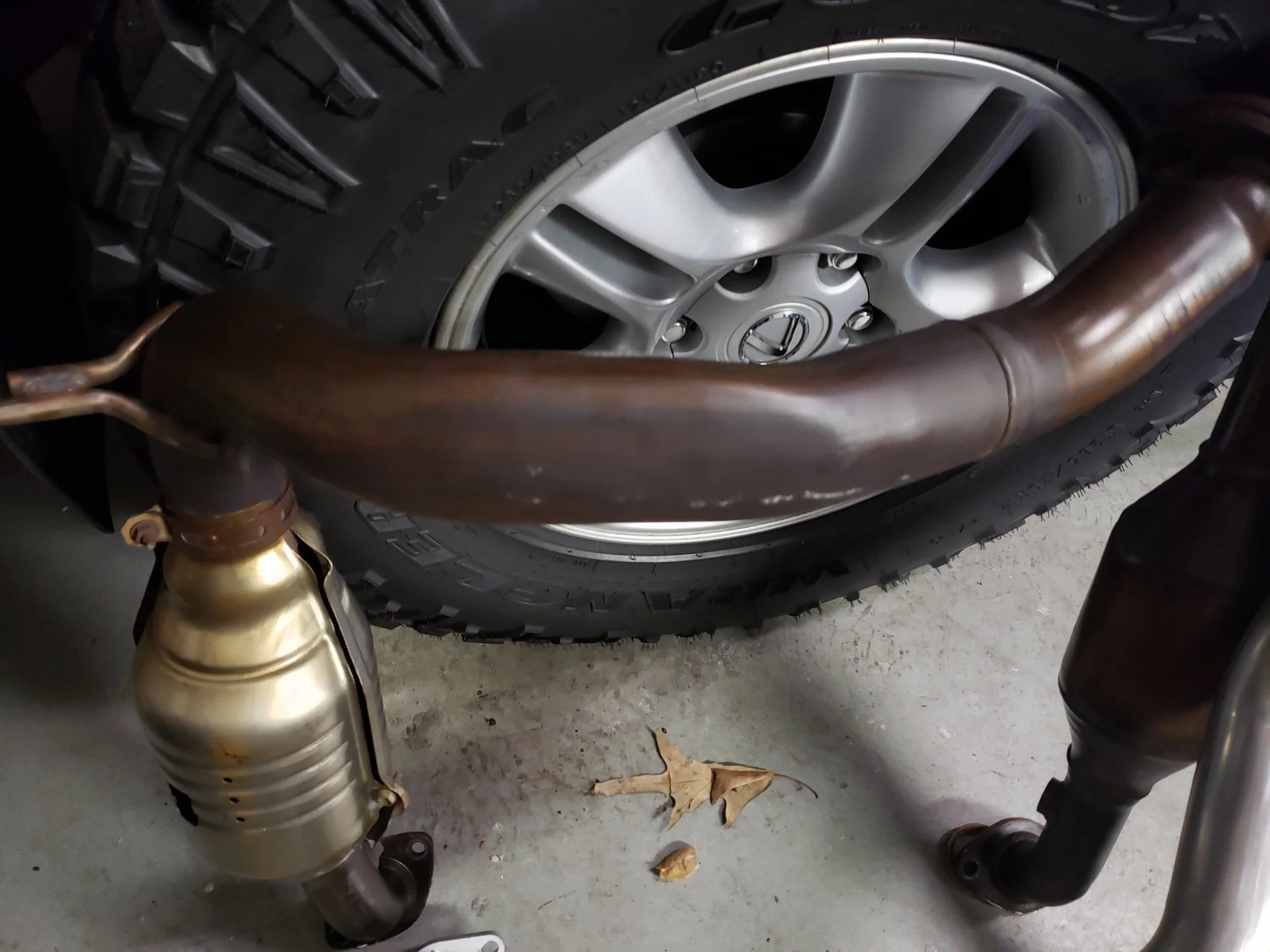

Just replaced the factory crossover / y pipe with the one from URD. I did not like how the stock pipe hung down below the transmission cross-member. It just looked like an accident waiting to happen when this thing gets off road eventually. The URD is not as tucked up as I thought it would be but it does not hang lower than the tubular supports going from the cross-member to the frame. I am very pleased with the quality of the URD piece. It fits absolutely perfect. The pipe is mandrel bent stainless steel with a proper Y section that isn't crimped. The stock piece is double walled where it hung below the transmission cross-member so the diameter you see is actually a lot smaller inside. The URD pipe will surely flow better plus it eliminates the rear cats. I also understand that the stock exhaust manifolds are prone to cracks and leaks. My thinking is that the crossover pipe getting hit off road may be a contributor to that cracking. I am hoping to avoid replacing the manifolds anytime soon. The rear section (cat back) is stock at this time. The sound difference is really not noticeable. My wife wouldn't notice any difference. There is a very slight increase in burble at idle and a very slight increase under heavy throttle. It does feel more responsive. I will see how fuel mileage is affected but I have only driven it to work twice so far. I suspect with the addition of a cat back system down the road it would sound very good! Pics below show the poor design of the stock pipe. It is in very good condition if anyone wants it. I have it on Ebay currently but would let it go to a MUD / GXOR member for a lot less $.

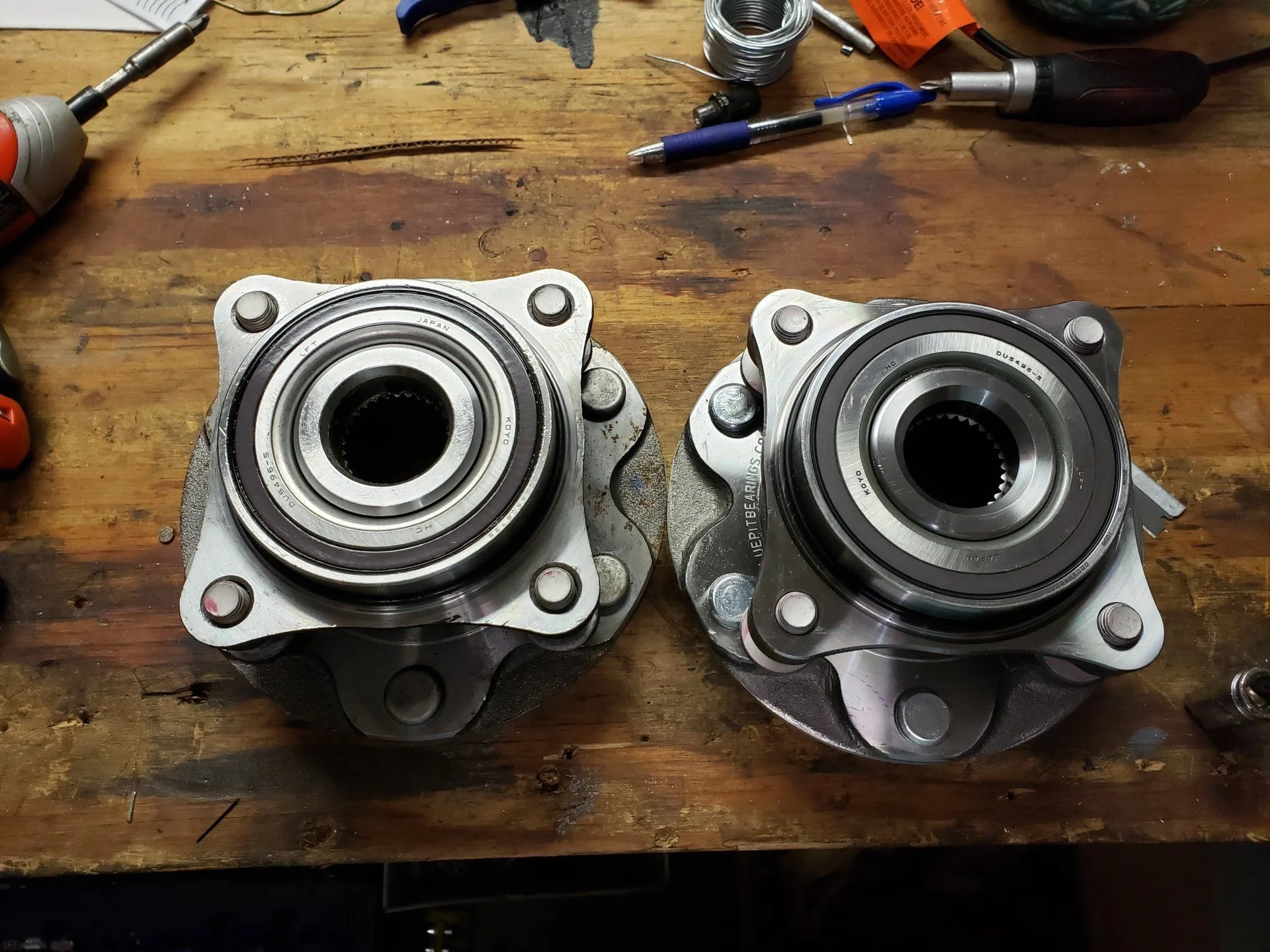

I started hearing and feeling a wheel bearing growl from the front end of the GX a couple days ago. I felt and heard it while in a tight left sweeping turn on an entrance ramp. The left side was unweighted. I had just replaced my front wheel bearing/hub assemblies with units off Ebay from seller 8maggie. They were advertised to be Koyo bearings. After some research I determined they were counterfeit bearings. I messaged the seller and after going back and forth and threatening to contact Ebay, Paypal, credit card company (whatever it took) I would get my money back. He authorized the return. I swapped them with Bluepit hub bearing assemblies. Here are the differences and how to tell if bearings are genuine Koyo or not. The genuine Koyo bearings have smaller and deeper markings. The counterfeit bearings have nicks and burs on the outer edge. Also the magnet for the speed sensor does not have the same uniform look of the genuine bearing. Beware of all Ebay Koyo bearings in my opinion. Buy from an authorized dealer with a solid reputation over a number of years. Bluepit uses Japanese sourced Tezuka hubs (OEM supplier) and Genuine Koyo bearings assembled with Toyota, bolts, seal, and o-ring. They come with a new Toyota cotter pin as well. Andy is quick to reply and ship. I had mine the next day somehow. They shipped from KY. I am in Tennessee.

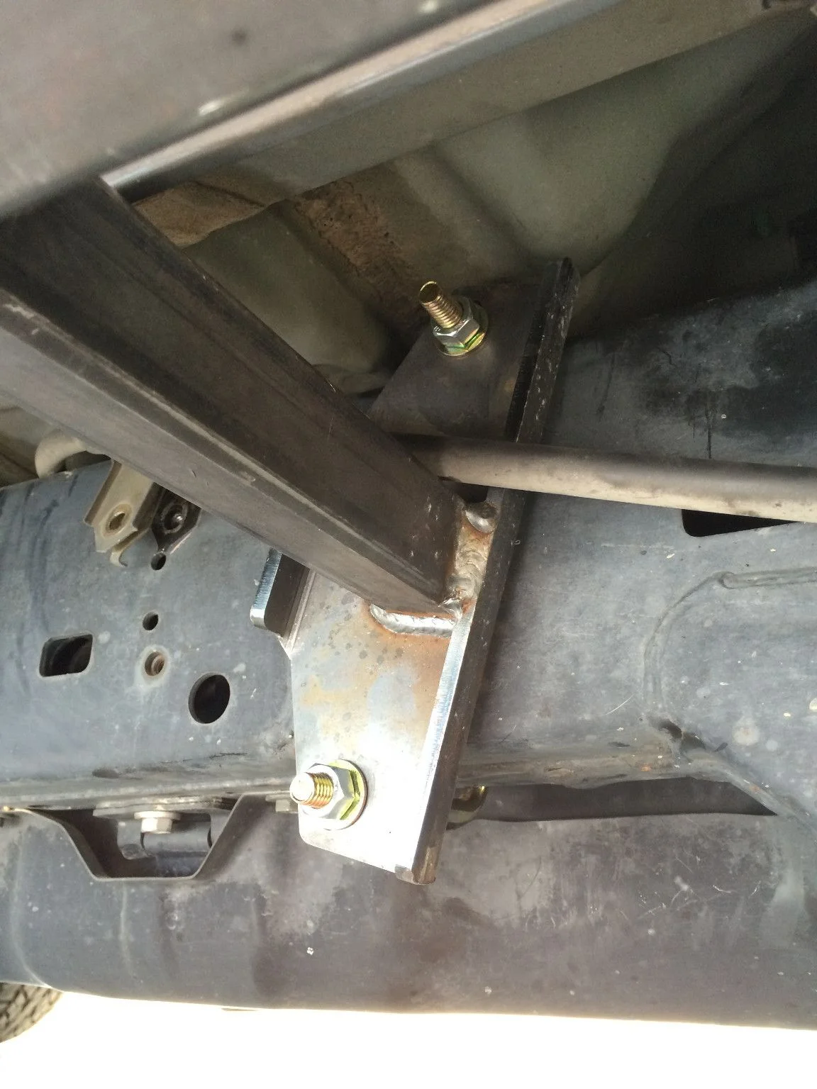

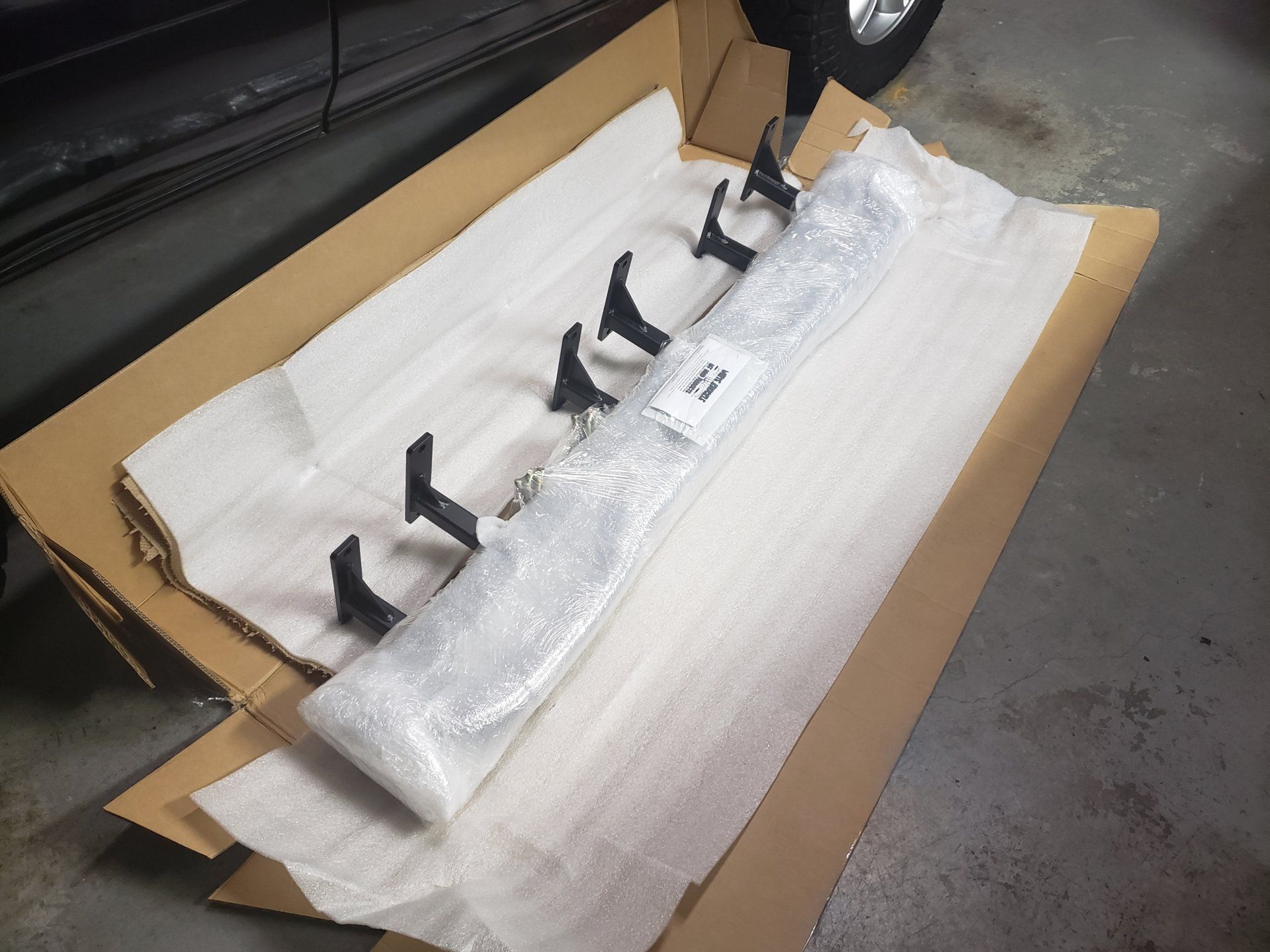

So my White-Knuckle Off Road Sliders arrived yesterday and I could not be more impressed! The whole process start to finish was great so I wanted to do a little write up and hopefully help some folks in the future and thank a great company. I did a lot of research to decide which brand to go with. I looked at pictures, reviews, etc. on here and on GXOR.
I wanted a bolt-on option without nutserts or drilling the frame. I like the tapered rectangular sliders of the WKOR, square legs, DOM tubing, subtle kick out, and U-bolt mount around the frame. John and Natalie at WKOR were both very helpful answering questions through e-mail and Instagram messaging. From ordering to arrival took 7 weeks. 1 of these weeks was the Christmas and New Year holiday. 2 weeks were powder coating and one week was shipping from California. They were on time, never over promised and undelivered. The couple times I checked in on progress they were friendly and gave me updates.
Lots of pictures below. I did the whole installation during the State of the Union Address. The driver's side has the fuel tank and brake lines to deal with. The passenger side was easy easy. Overall, I was able to knock this out pretty quick and easy by myself with jack stands. They balanced perfect on the stands. I could raise them up into place while laying on my back under the sliders. The jack stands just clicked and locked at the right height. All these folks do is sliders and they do it well. The way everything was packaged was amazing. Instructions were clear and detailed. They were specific to the GX even though the same sliders fit the 4th gen 4Runner. I needed a 12mm socket and ratchet for the E-brake line brackets and 3/4" for the slider mounts.
The welds, plate thickness, gusseting, square, rectangular, and round tubing was all top notch quality. I had Trail Gear sliders on a previous rig ('05 Tahoe Z71) that a shop welded on for me. The whole experience was so much easier being able to install myself this time. The WKOR sliders are in a different league. I can have them welded later if I want but I don't see any reason to. They are rock solid. I'd hang this GX off a cliff by these sliders. If there was anything critical I could say I would but honestly there just wasn't. I usually nit pick a part or a company one way or another but this was a great experience. You can option these with diamond plate step pads as well if you like. You can build and order to spec at this link if you are curious about pricing and options. Toyota 4Runner 4th Generation 2003-2009 / Lexus GX470 Rock Sliders - White Knuckle Off Road Products

They are a tight fit on the driver side but once you get that rear u bolt in place its not bad. The passenger side is really easy.

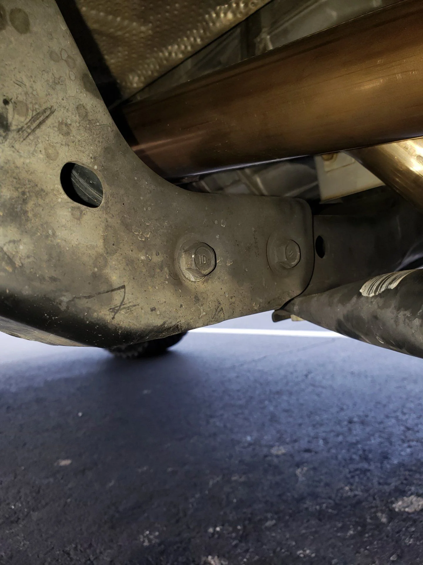

Because the back mount hangs an inch below the frame.
Most likely you are going to hit your gas tank skid before that spot. But as others have mentioned I don't think they are going anywhere. These have been on the market longer than most and no one has reported a failure from them taking a hit. Now the nutcerts that is TRUTH. They never should have been mounted with them. I didn't and many others have also found better ways that still don't require welding. Great looking truck by the way!

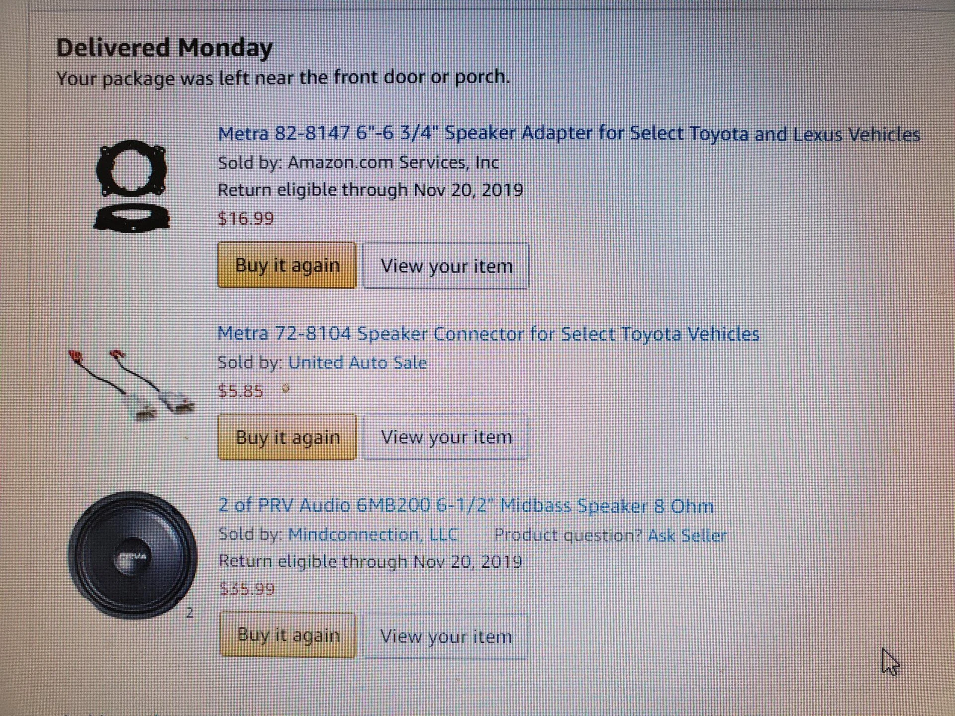

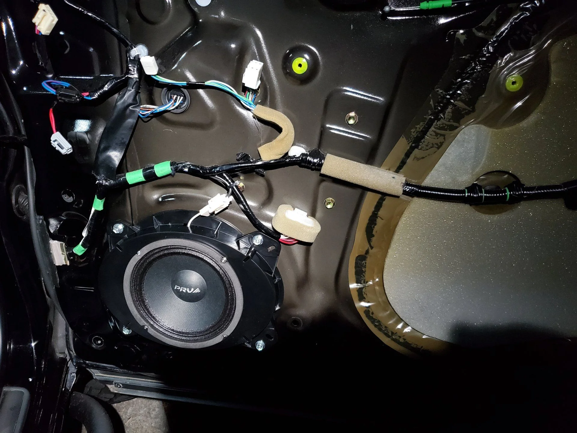

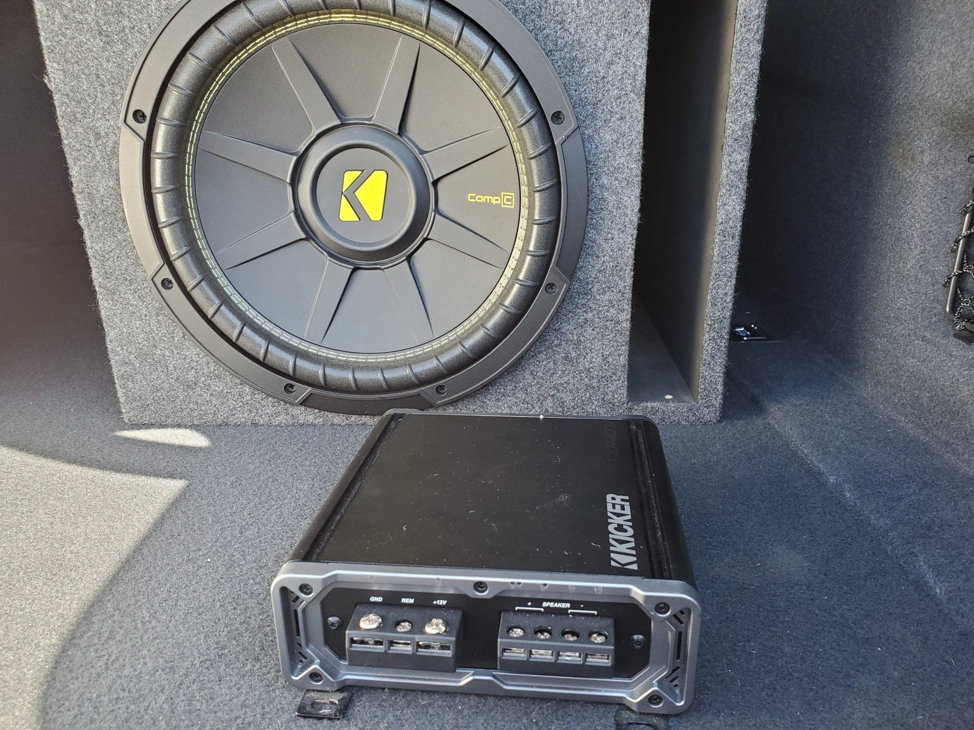

I had repaired the front door speakers with flex seal but after a couple months the passenger side gave me problems again so I found some 8 ohm speakers on Amazon and put them in. They sound great. Also picked up a sub and amp used for $120. Not sure if its going in the GX or my car...
Were those door speakers plug-and-play with the adapter and connectors? I'm going to attempt to refoam mine but I suspect one of them is actually blown and the refoam isn't going to solve my issue.
You know how speakers usually have one large terminal and one small one? Well these speakers had two large terminals so I was not able to plug the connectors in like normal. I did end up cutting off the red ends, strip back the insulation and attach through the holes in the terminal, twist, and tape. They could also be soldered but I did not. The adapters were a perfect fit.
