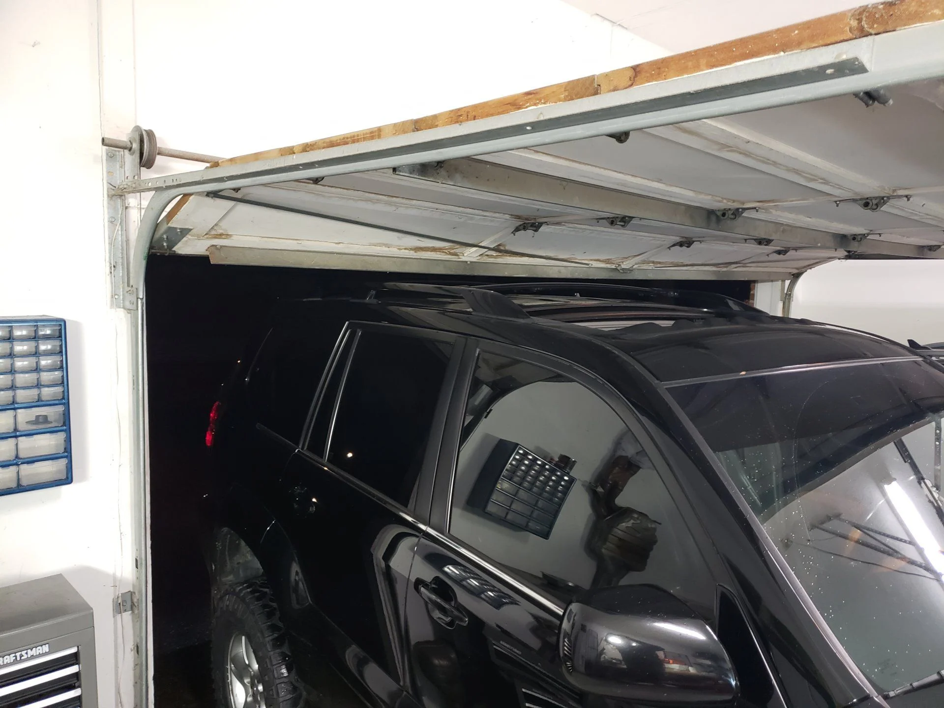

And a few more pics. Thinking the lift may settle a bit? I just barely fit in the garage although this one sits outside most of the time.

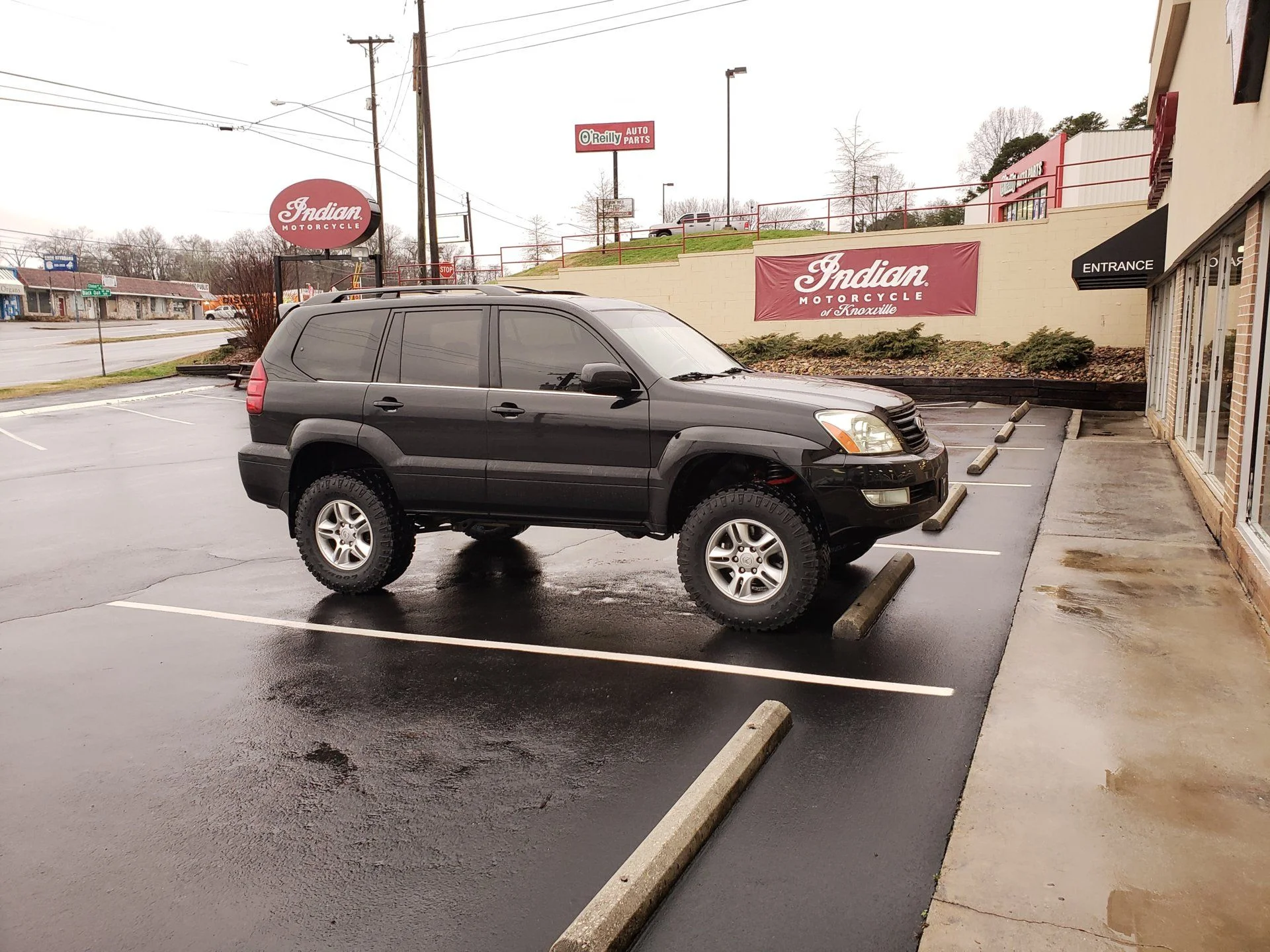

New GX470 owner, but longtime 80 series junkie. Picked up an '06 GX470 yesterday just in time for an ice storm early this morning. It's got that LC DNA to be certain.
For anyone who is interested: no nav, 163K miles and bone stock. I picked up all the fluids and filters today to begin the baseline maintenance work, and I'm scheduling the timing belt service for next week.

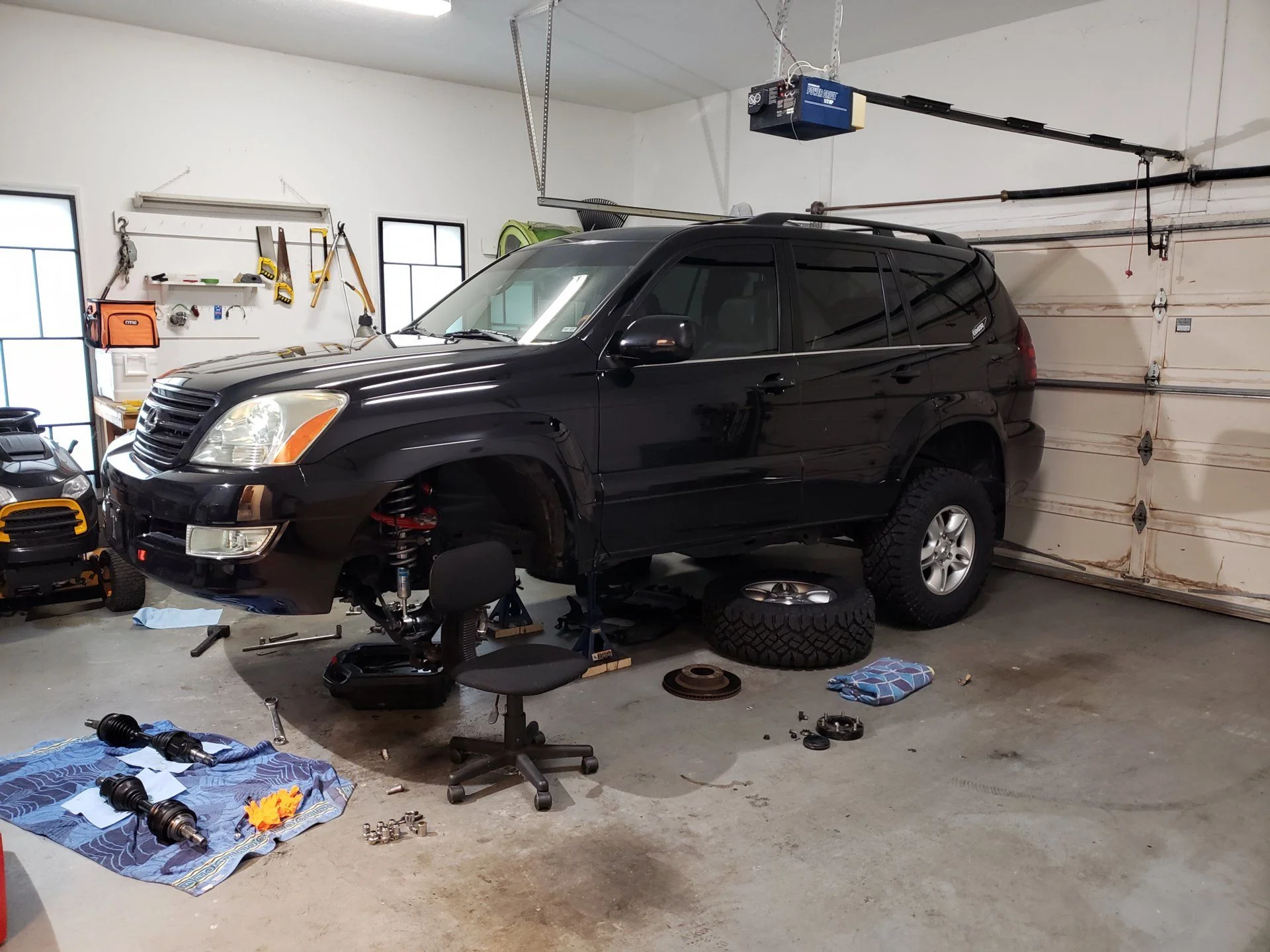

Update with some tips I picked up. I took her back apart to reboot the CVs. I also replaced the wheel hub bearing assemblies, and did the rotors and pads while everything was apart. I hope to drive it for a while now and just enjoy the new lift until the sliders arrive.
I wanted to stay with OEM CVs for strength and save some money. I ordered the Toyota boot kit, and replaced them myself along with doing a boot stretch on the inner boots. I match marked the inner CV joint so it went back together the same way it came from the factory. In hind sight I may have used CVJ for replacement CVs but I learned a lot and saved a few hundred doing the CVs myself. It is a messy job but not difficult. I probably would have ordered a high angle boot kit as well.

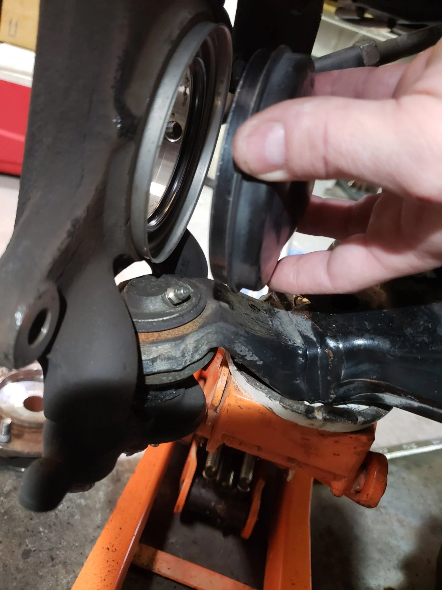

I had a vibration at hwy speeds that went away in a sweeping right turn. After replacing controls arms, bushings, ball joints, etc. I knew it had to be the left front wheel bearing so I purchased complete assemblies on Ebay with Koyo bearings <- THESE HAD COUNTERFEIT KOYO BEARINGS! DON'T BUY EBAY KOYO BEARINGS! THESE CAME FR0M SELLER 8 MAGGIE I RETURNED THEM FOR A REFUND AFTER HEARING AND FEELING A GROWLING NOISE THESE WERE REPLACED WITH BLUEPIT BEARING/HUB ASSEMBLIES SEE PICTURES LATER IN THIS THREAD OF GENUINE KOYO BEARING AND COUNTERFEIT SIDE BY SIDE. This made for an easy swap and it fixed my vibration.
The rotors looked like they had been through a couple sets of pads without being turned. My pads had about 30% remaining so I went ahead and replaced both. Everything up front is new now except for tie rods and sway bar end links and bushings. It really drives great. It was just time to freshen things up at 14 years old and 146k miles. I didn't take pictures of everything but here are a few along with a YouTube video with a couple tips.
I also polished the headlights with a 3m kit and applied a couple GXOR decals on the rear side windows. My pictures are out of order.
The dust cap that covers the axle nut fits perfect for pushing the outer axle seal into place. The inner axle seals don't seat against anything so you have to carefully push them in until they are flush. I happen to have a 54mm socket that did the job fine.

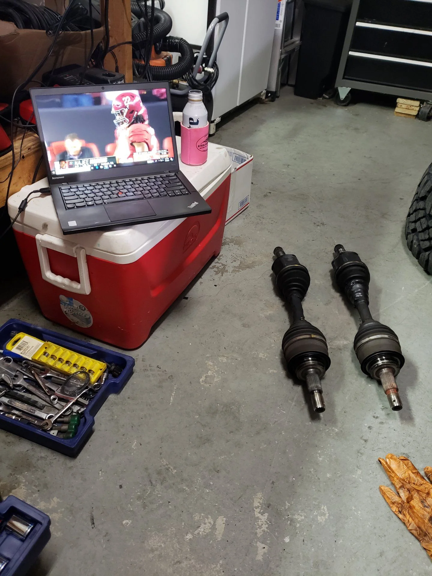

I had to take a break here and watch Alabama get whooped! You can see that CV on the right had some silicone tape around the inner boot. That was a solid repair for a couple months. We drove to the beach on it and my wife drove it daily. I just didn't have the time to fool with it. I didn't have an extra vehicle either. The newly installed lift made short work of it and it was time for a proper repair.
Check out some tips about installing CVs. I hope this helps someone.
