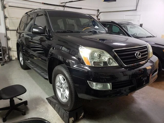

Hey Guys and Gals, I have enjoyed the info here as well as the GXOR FB page. I have had a few Toyotas over the years including a '88 Pickup 4x4 5 spd, '98 Tacoma sr5 Reg. Cab 4x4 5 spd, and an '06 Tacoma Dbl Cab TRD Sport. My wife was driving the GX but we got her a 2015 VW Touareg. I drive a 2012 Stage 2 Dual Pulley Audi A6 as my daily. The GX is a 2005 in excellent condition with 146,000 miles. We had the timing belt, radiator and water pump replaced a few thousand miles ago and installed Michelin tires. Other than oil changes and diff/transfer case fluid change, that is the service history since we purchased it with 123k on the clock. It was a dealer serviced one-owner previously from the Atlanta area. After a lot of research, I have decided on the following suspension / lift upgrades. I appreciate any feedback or suggestions regarding alternatives or installation tips. I beat up a pretty nice '05 Tahoe Z71 with 35s and 6"+ lift a few years back so I'm not looking to do that again. I do want to hit some easier trails occasionally and take the family on some outdoor adventures and camping. I'd also like my wife to be comfortable driving it if needed.

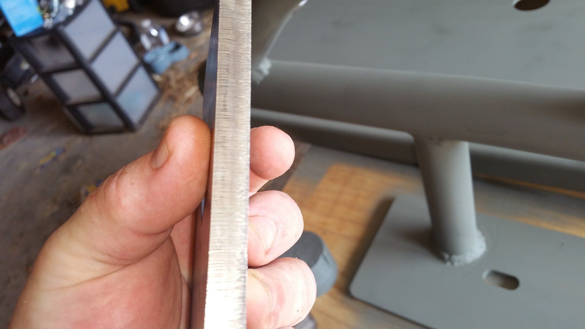

check out the budbuilt sliders.... they are extremely well built and bolt through the frame..... love the design and easy install. the second pic shows the material thickness of the backer plates for the through bolts.... thses suckers arent going anywhere.
View attachment 1842669 View attachment 1842670 View attachment 1842671
I like the simple rugged look of those for sure. Thanks for posting the detailed pics too. I had the Trail Gear Sliders on the Tahoe I used to wheel. I may even go with them again. What I save in the purchase I'd probably spend to have them welded on. Sounds like a lot of folks that buy the bolt ons end up welding anyways though...

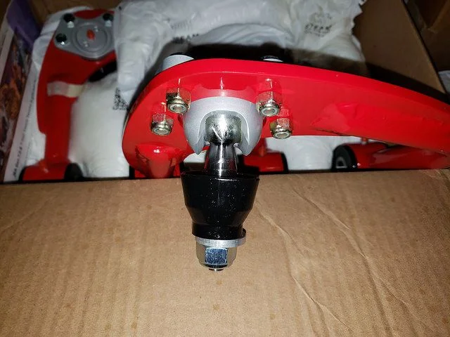

My JBA control arms arrived today. Of all the parts that have arrived these are definitely the prettiest. I called to ask them about any holiday specials they could offer but none were available. It was Marlin himself that answered the phone. He was very knowledgeable. I ended placing the order after we got off the phone. The packaging was nice and the quality is obvious.
Why did you opt for the standard UCA instead of the high caster UCA by JBA?>
Both the Std and HD have the same high caster settings. The HD is just built stronger to take abuse from jumping and higher speeds offroad. For a daily driver on 33" tires and mild offroad trails these are more than enough. The HD arms are a couple hundred more as well. It looks like they do offer a std stock replacement too. I updated my build list to show the arms as "std high caster"

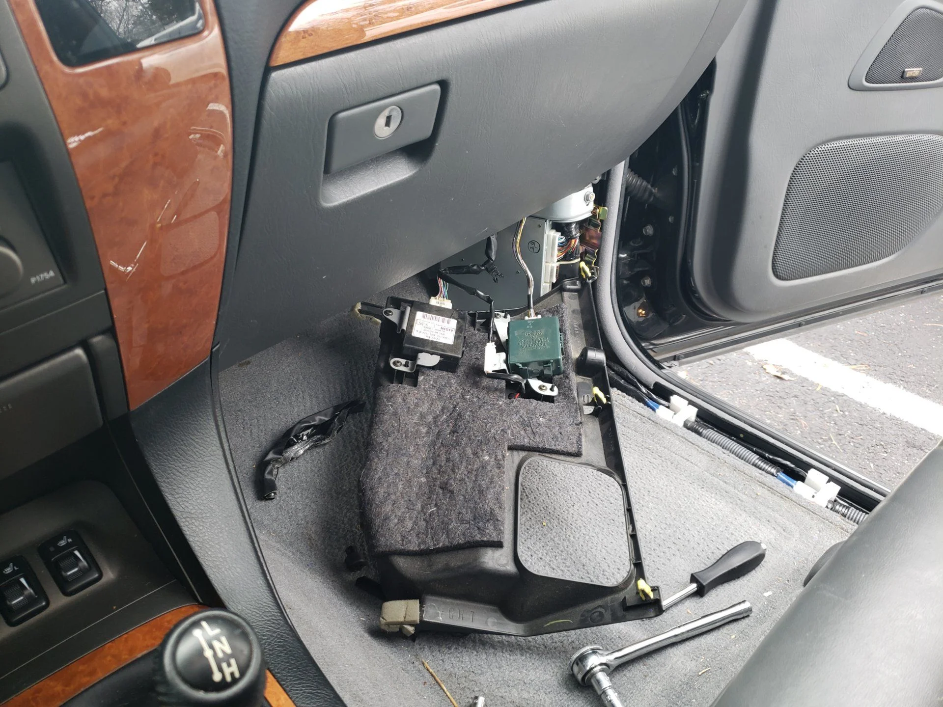

Yesterday I removed the running boards. I'm happy with the cuts made to retain the upper portion of the running board trim for a clean look. The pictures don't show it well. I also had the TPMS light flashing after a trip through the car wash this morning. I checked the tires. I checked the switch below the steering column. If you remove the cover under the glove box and unplug the harness going to the green tpms box you can cut and ground the blue wire (#6). You ground the end that runs up through the harness. No more TPMS light. A quick google search showed the bypass in another forum.

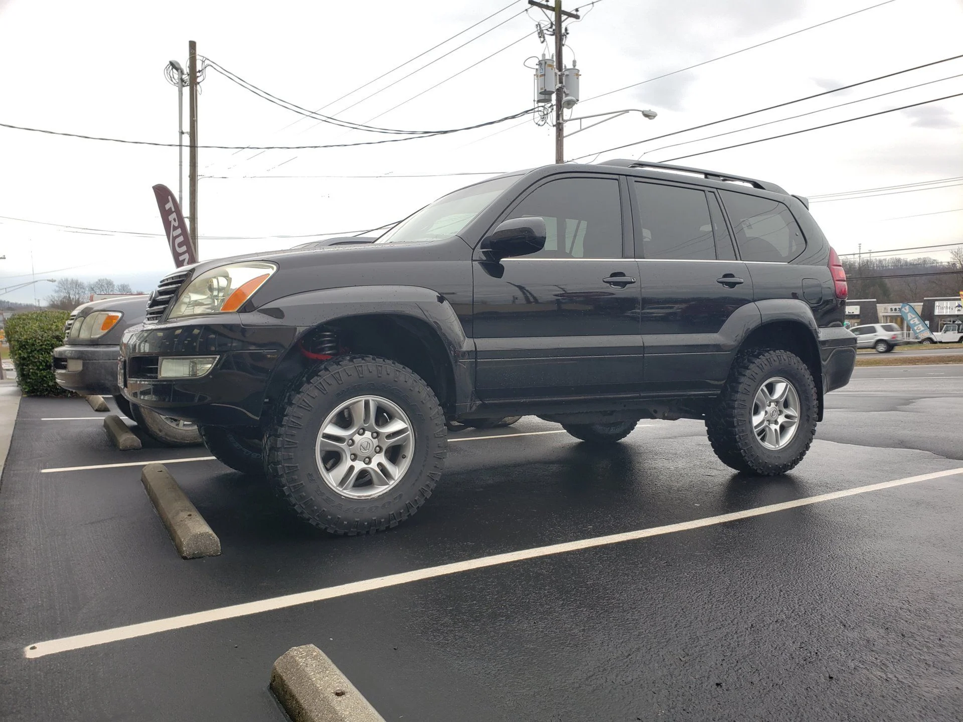

My 285/70/17 Goodyear Duratracs arrived so I thought I'd bump this thread with a picture until I get to turning wrenches. The Duratracs are labeled at a full 33" vs others that are 32.7". They look aggressive but in reality most of my use will still be on pavement. I am interested to see how they do off road compared to the Coopers I have run in the past on other vehicles. I am staying with the stock wheels for now since I have some G2 spacers I bought a while back but never installed. I actually gave them to a friend to put on his 4runner. He gave them back after selling the 4runner to his mom.

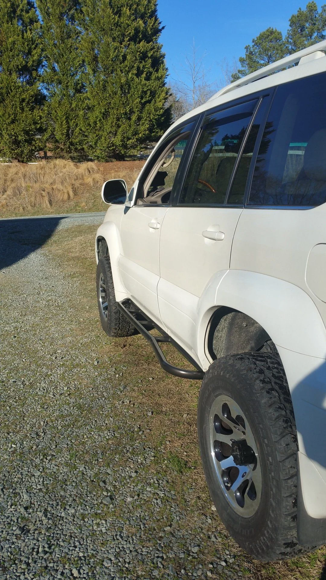

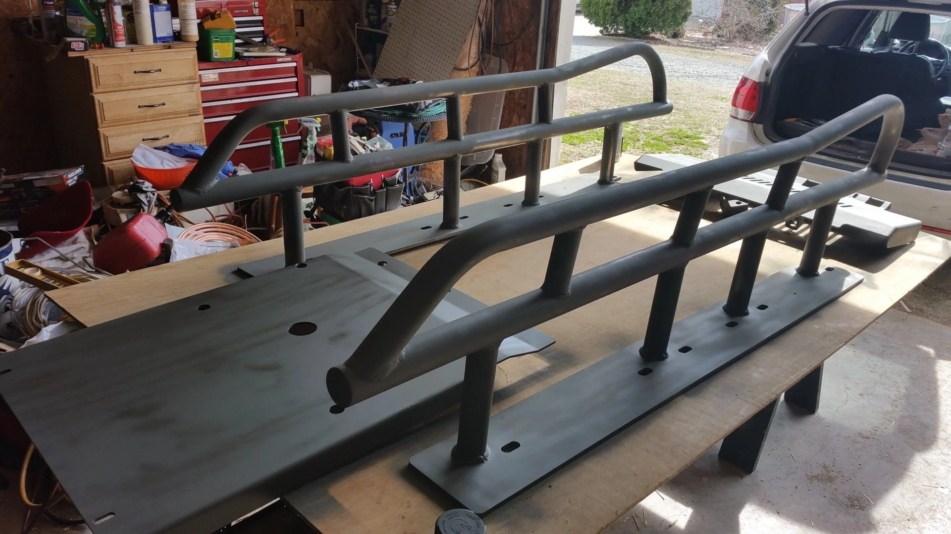

After a lot of research and looking at pictures I decided on the White Knuckle Off Road sliders. These should be here in a few weeks. I am super stoked about these. They have a rectangular slider with tapered ends available in HREW or DOM steal (I'm getting DOM). They have a kickout but not too pronounced. Plus you don't have to drill any holes in the frame (no nutserts). They mount with clamps that go around the frame. This makes them completely removable although I will probably weld them on later. They also angle up slightly and just have a clean look to them. More to come...

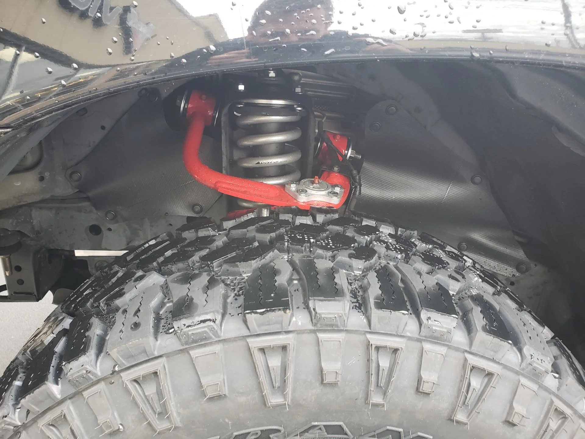

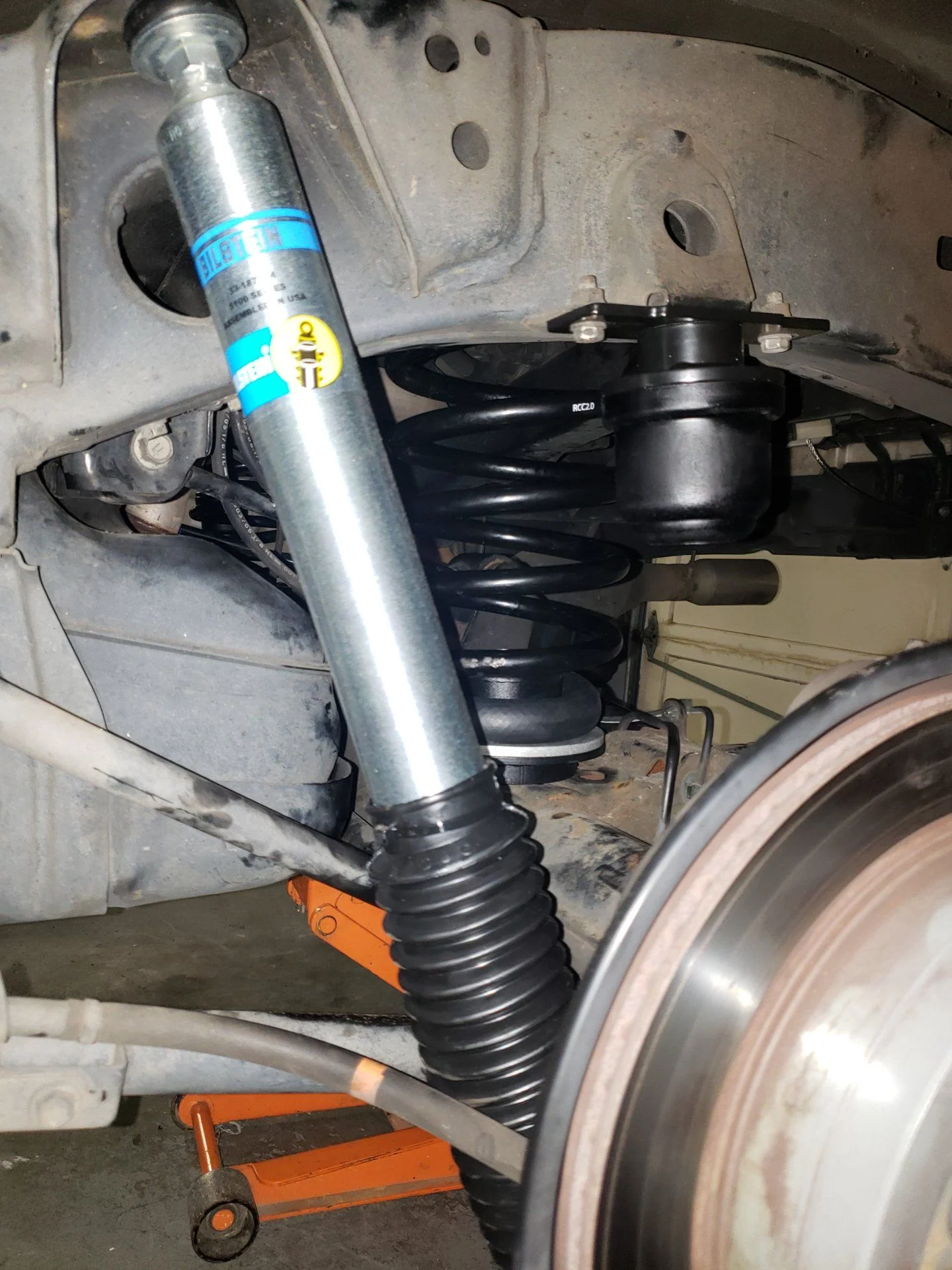

Well the time finally arrived. I was on break last week and had time to work on the GX. I installed the lift and did some general maintenance. the first post shows my parts list. In general this was a Bilstein/Toytec 3" lift with Duratrac 285s. A couple takeaways. Don't try replacing bushings on your oem LCAs. Buy new control arms. I was not able to press out the old bushings so I took them to a shop and they even had a hard time. I saved a couple hundred dollars I suppose... Also I'm kinda proud of the fender liners I made. I took out the old brittle liners that go on either side of the UCAs and traced them out on some vinyl flooring I found a Lowes. They turned out great. I have maybe $10 in the set of 4 with new fasteners. I did the fender mods for clearance. I found the SSO coil conversion spring perch bumpers (the red part) were worthless. The diameter was too small for the Toytec Superflex springs. I trashed those and slid some 3/4" radiator hose over the bottom coil on each side. I removed all the old air tank, height sensors, compressor, etc. I have a fully inflated 33" spare tire in the stock location. removing the clip which holds in the rear air bags was super easy. Just take a coat hanger and put a little hook in one end and slide it between the frame and body and hook the clip and pull. Pics below! Can't wait for my WKOR sliders to arrive! Maybe I'll do some rock lights and such. I'd like to put a locker in the rear but I'm not sure which way I want to go with that yet. Hopefully the next pics I post will be off road somewhere.
Looks great, nice work! The Superflex make for a nice too.
It rides great! It really rides better than stock but stock had 146k and 13 years on it. Superflex in the rear and the Toytec 521600 in the front on the bottom perch. I could not be happier!
