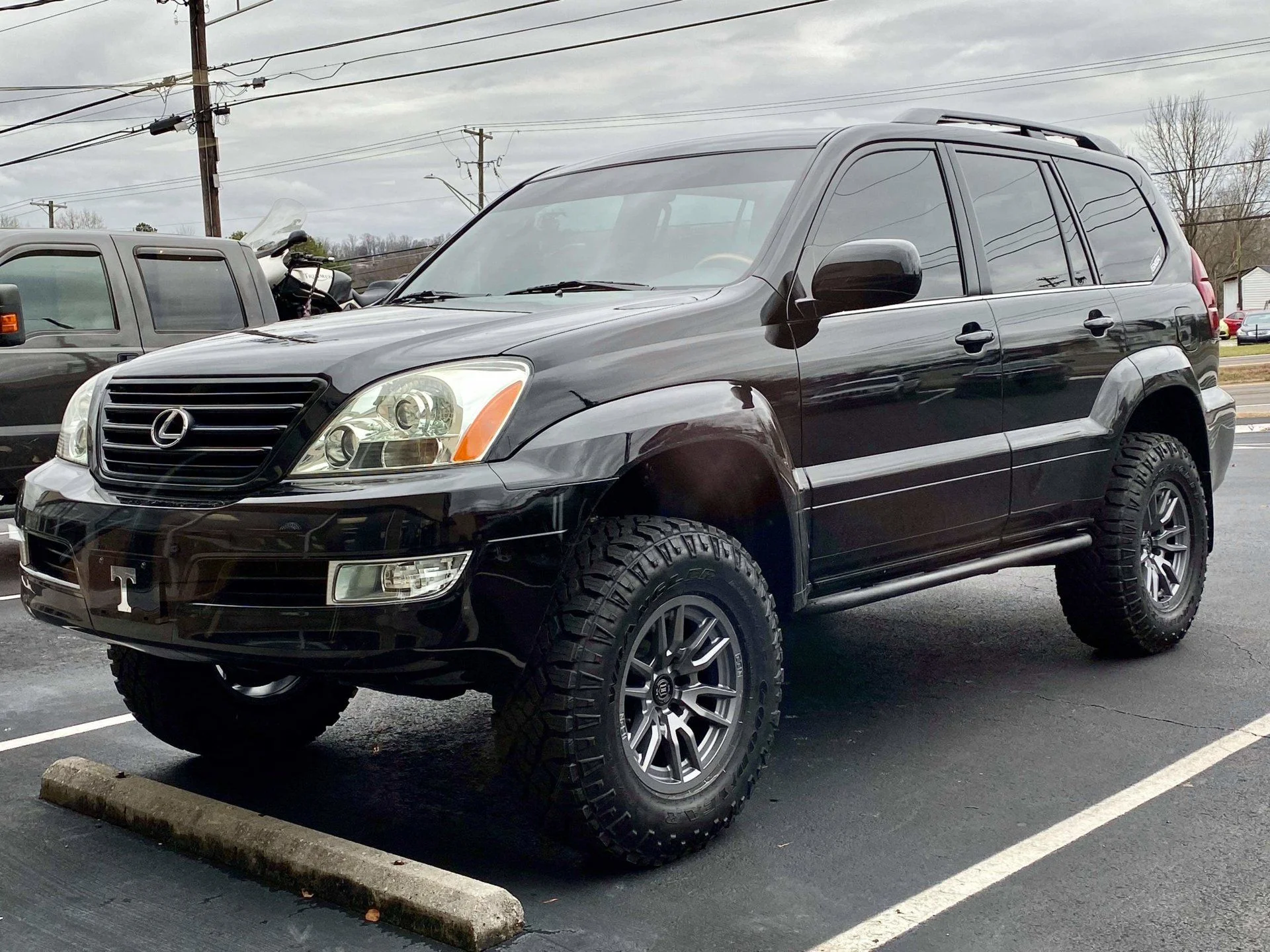

These went on yesterday. Titanium Icon Vector 6. I have 5 stock wheels for sale now and 4 G2 1.25" hubcentric spacers.
Depo Sport headlights and foglight tint are next.

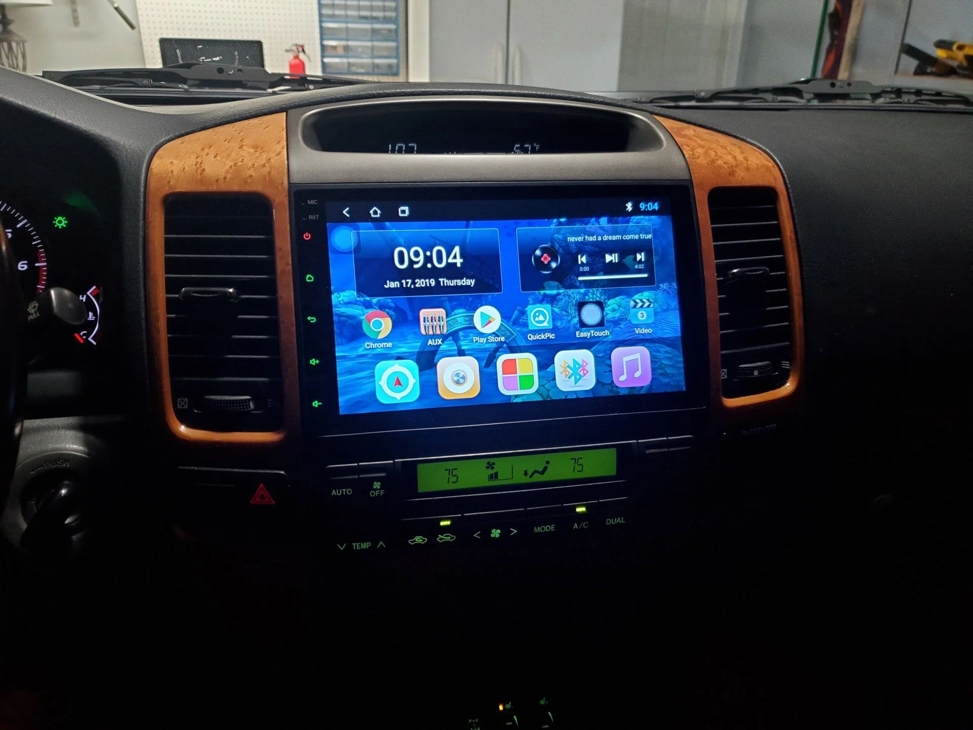

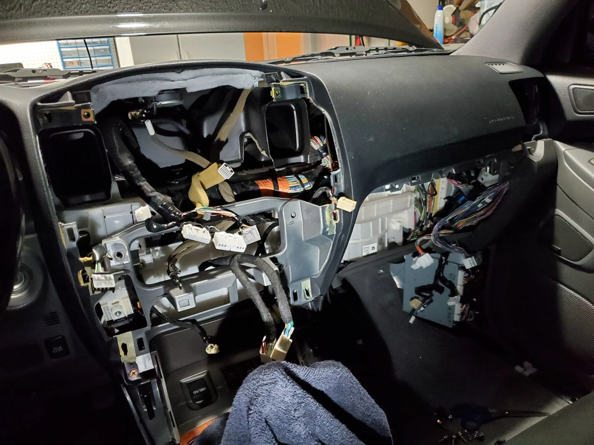

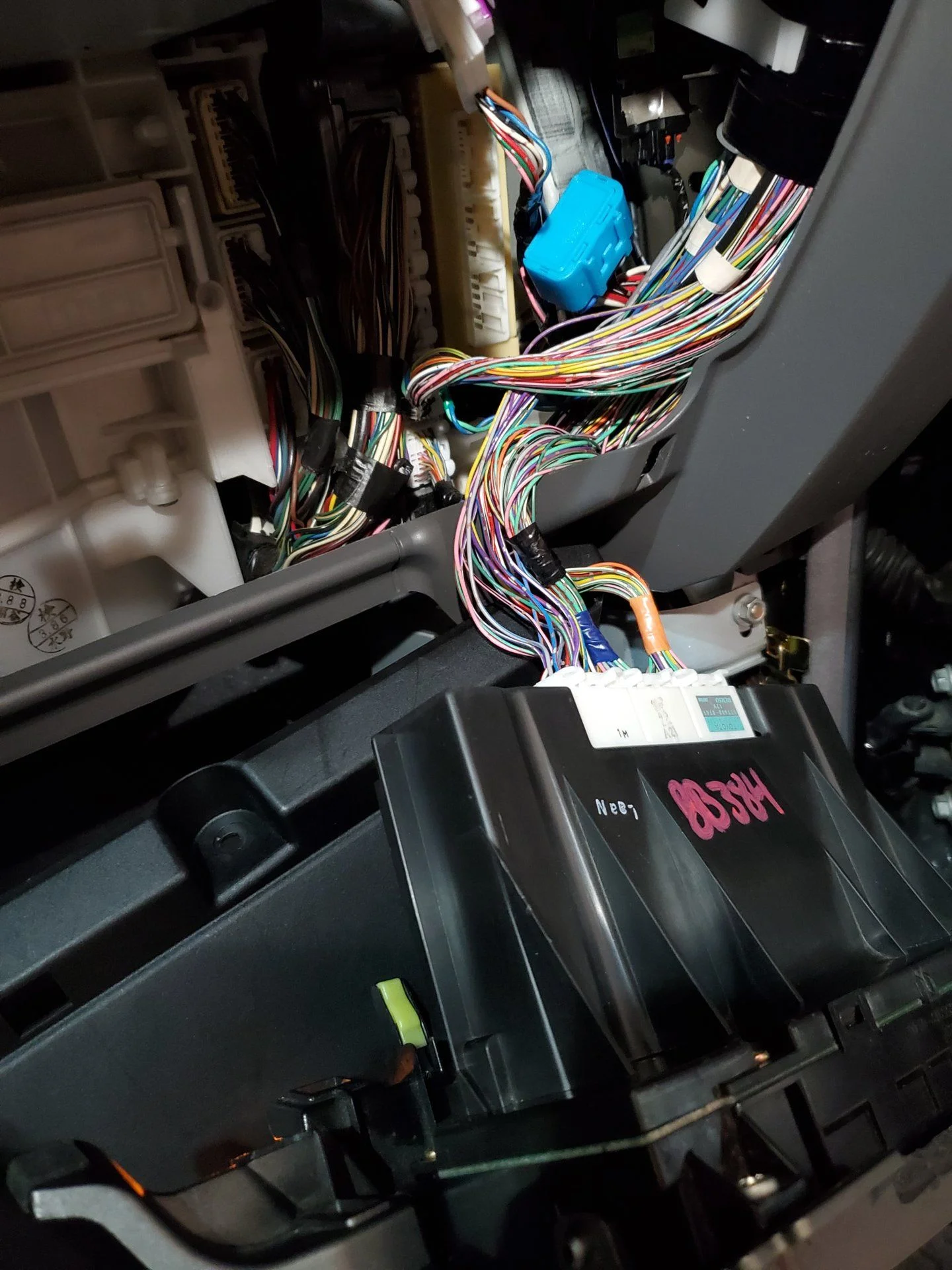

I finally got around to the non-nav conversion and installing the 9" Android unit I purchased back in the Fall. I still need to wire a new backup camera. I think running a new one will be worth it in terms of clarity. This is the camera I ordered. While I was at it, I installed a Kicker Comp C 12" sub and Kicker CXA400.1 amp behind the 2nd row. I am Very happy with the installation and sound quality so far. The subwoofer RCA out on the back of the head unit is very poor quality but the 2 channel RCAs are working fine. I was not sure of the RCA preamp voltage so I installed a line driver just in case. Will update with more pictures. The tutorials on FB GXOR page were very helpful.
