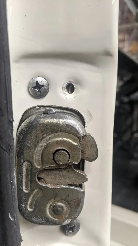

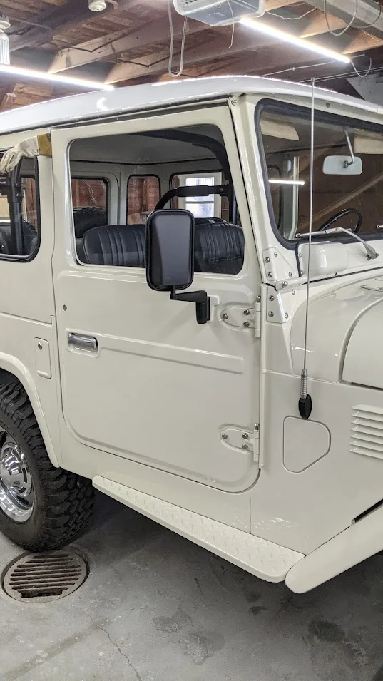

Front doors are both hung with weatherstrip and latches...no glass/regulators yet. Longer day than expected...the hole for the latch on the driver's door was, er, not even close to correct, and I didn't catch it before paint. I knowingly took a gamble by not completely assembling the doors...I assumed some degree of basic competency there on the factory, and I was wrong. 🙃 OEM weatherstrip went on nicely at least...slow and tedious job, but stuck well with the 3M Super Black.
The screw holes are the wrong distance apart, the opening needed a bit of clearancing open (was too small for the latch), and it's punched way too high and also somehow pushed/dimpled too far in. There's no way to move that pocket, and really not much you could do pre-paint either. I ended up slotting the striker plate and running a spacer to get the distance up and outward for now, and I'll likely just have to make a custom striker with the hoop shifted up and out a bit. The latch was fine on the passenger door, though...again, just really spotty QC.

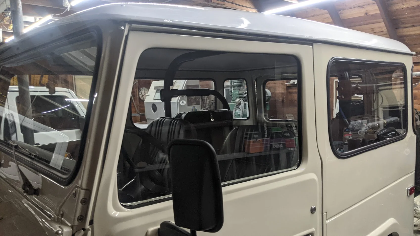

Dabbled getting the Britpart/Defender mirrors on as well - prototype adapter is looking good so far. Debating whether to run it more body colored (like in the photo) or with the adapter in black to match the mirror. I'll crank out both and see I suppose...

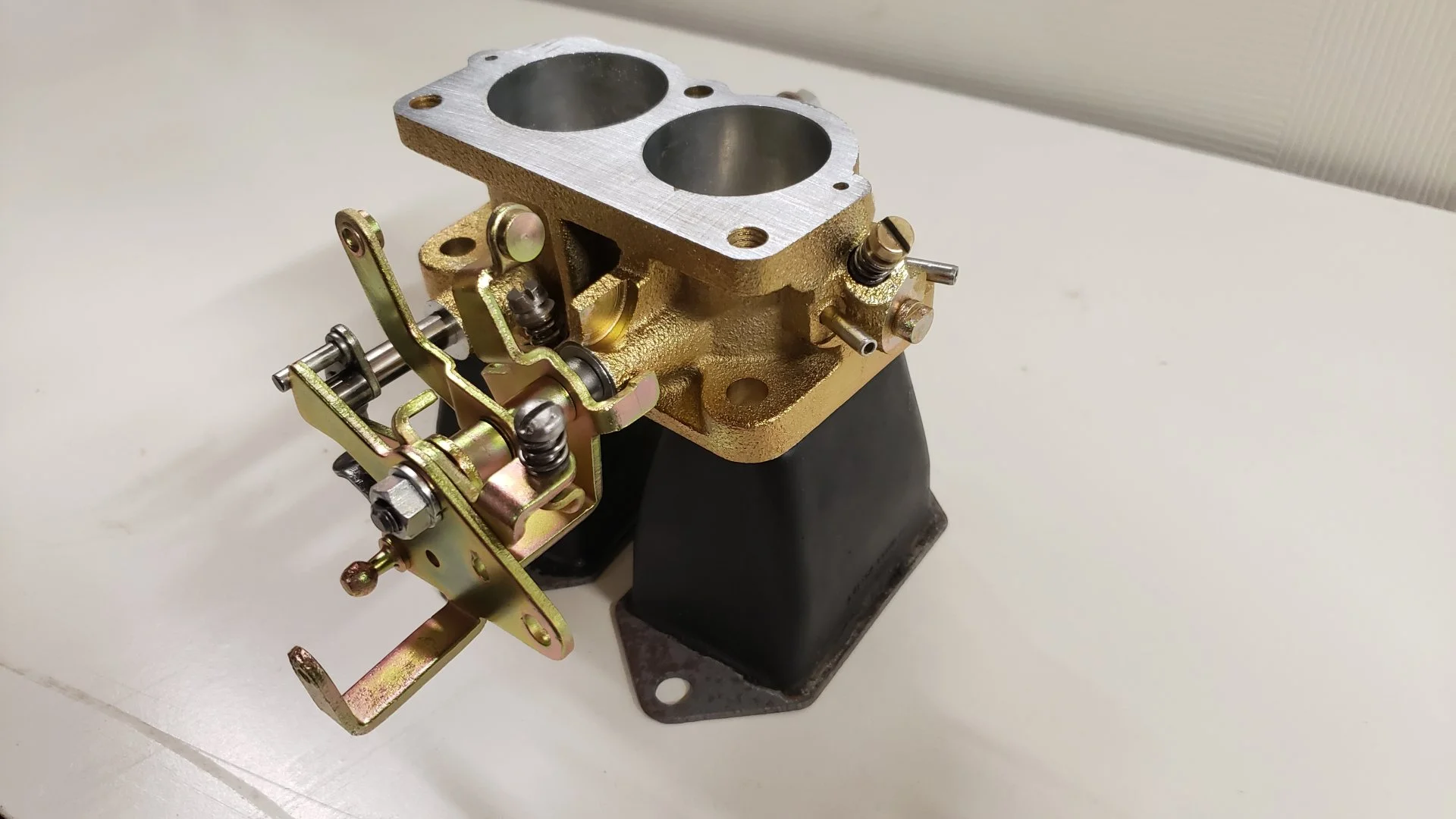

I did a mix of replating, replacement, and painting depending on what the part was or how rough it was...everything got blasted at least. I only ran a 1-gallon bucket for my plating, so that limited how large I could do. I just used my bench power supply and the typical vinegar/epsom/zinc strips, then used the Cadwell yellow chromate. Some parts ended up better than others...if you're doing a lot, a tumbler would be pretty handy.

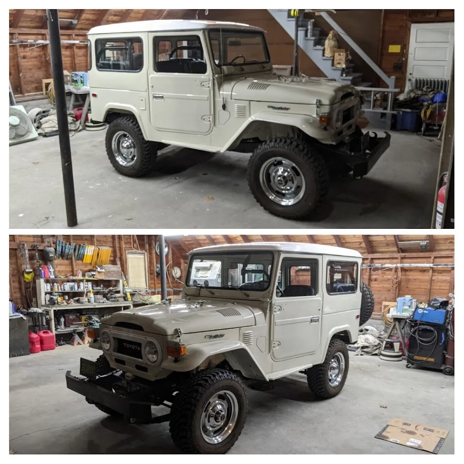

Good day today...front door cards went on, which were the **LAST** parts in the parts bin. The official "last part back on" was the passenger door strap.
Ended up taking just a few days under a year - pulled it into the shop and started disassembly on Nov 4, and today is Oct 28. Now just need to drive it while I can before the road salt flies - hoping to get it over the 500 mile mark this weekend. I'm sure there will be a few minor tweaks as it gets some miles, but definitely nice to have it 100% whole again.

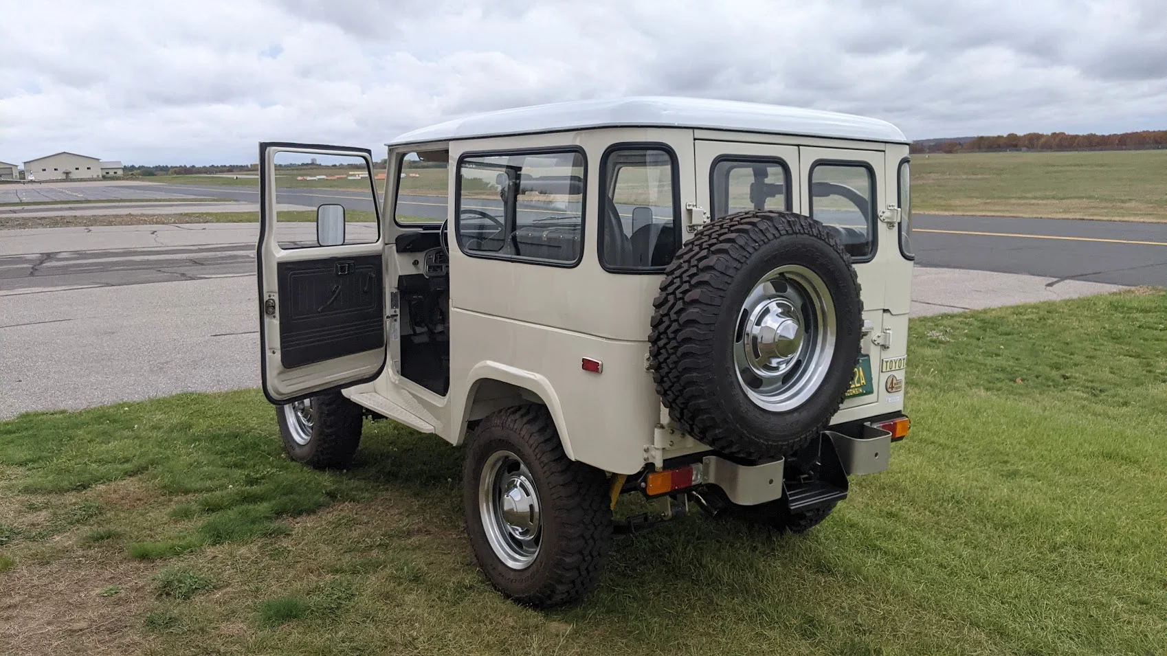

Indeed, the flares were hand-fabbed out of some sheet steel and a roundbar anvil...JDM part inspired, but I shifted them up so they matched the arch (vs extending it lower like the JDM part), and had them bolt on to the inner lip for any future removal.
Pretty happy with the two tone white so far as well - keeps with OEM, but also has the more classic two-tone look than the correct all-cygnus.

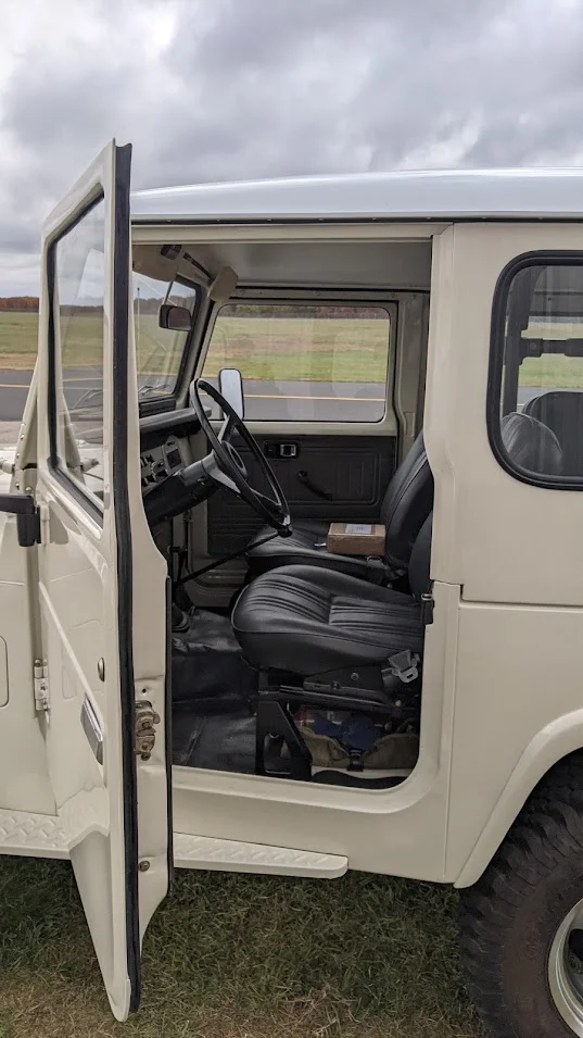

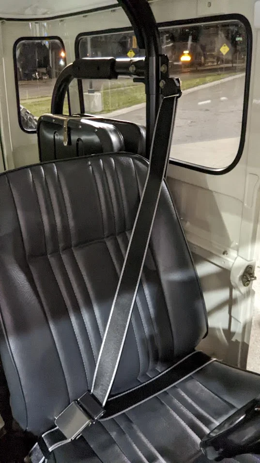

One last re-do...the shoulder belts from SeatbeltPlanet finally showed up, so fabbed up the roll bar brackets and dunked those on. I went with the flap-style latches and the soft strap for the inner mounts (vs the rigid), just to be a bit more like the originals. 125" length seems to work ok, rolls back up fine but also has room to extend.
