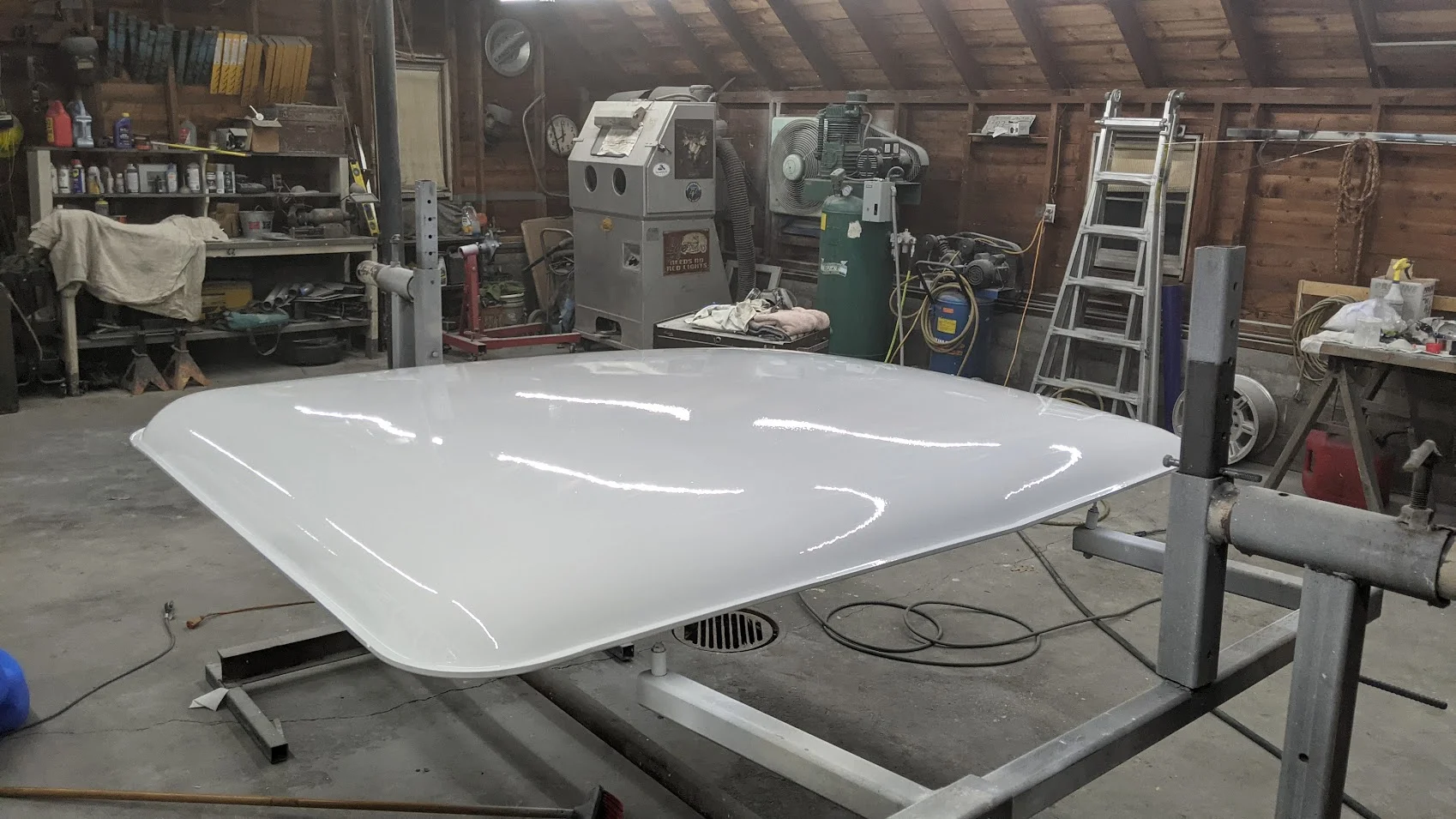

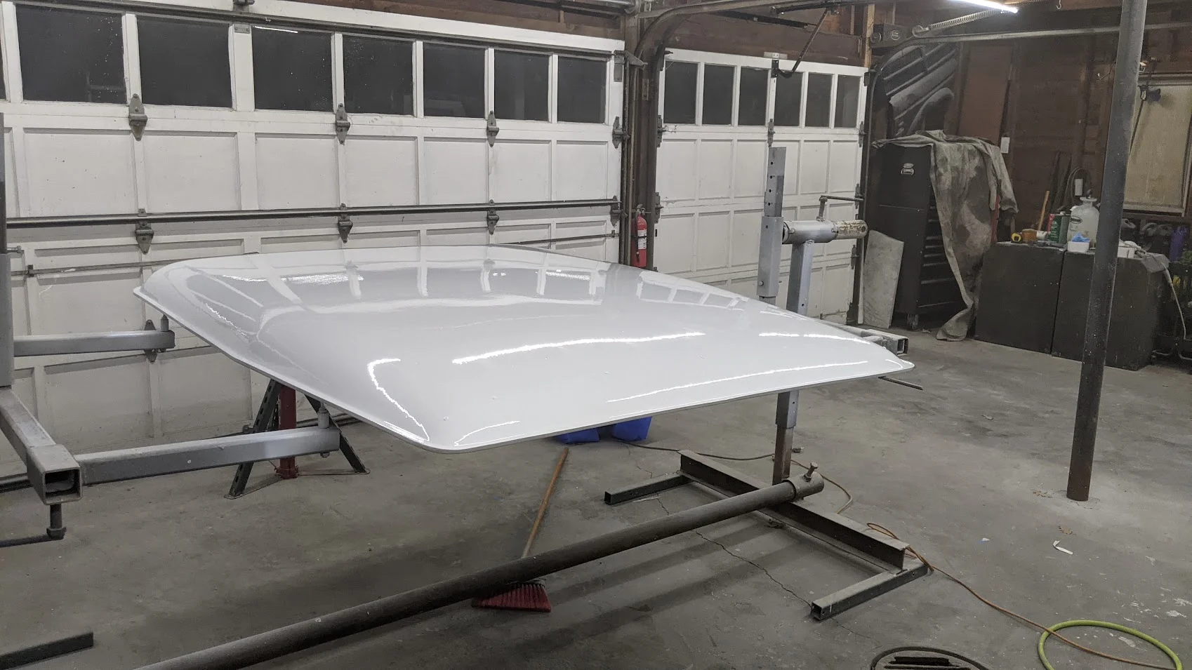

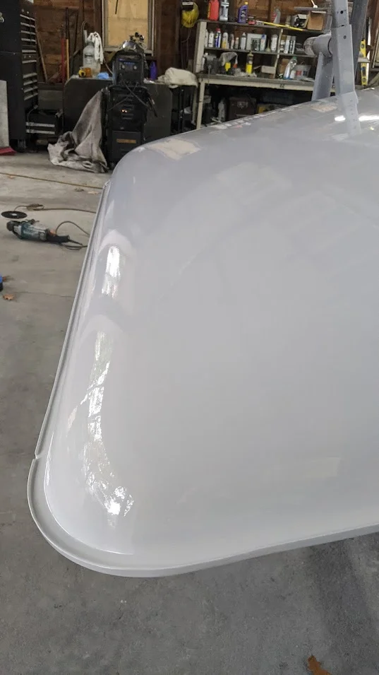

Top all painted...long afternoon, but came out nice. Should only need a very light cut and buff, but will see on Monday or so after it cures a bit. It is a white-white vs Cygnus, but based on the bib it should look nice with the off white Cygnus body. It's like a paler version of the two-tone desert tan rigs. 🙃
Flat-head rivets look nice, and the self-leveling sealer ended up pretty nice after paint - you can actually still pick up some dimpling of the rivets, which is a nice bit of a reminder of the original-original setup.

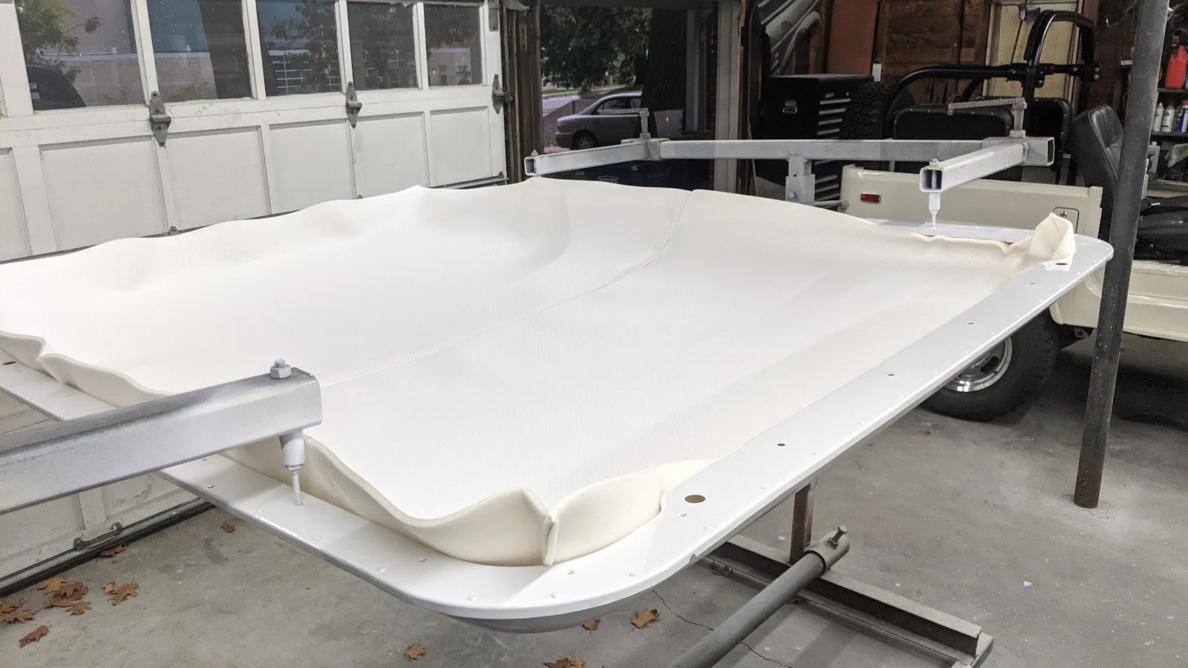

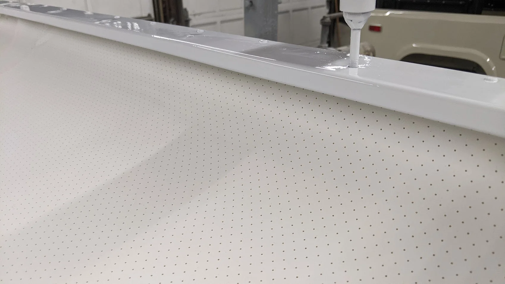

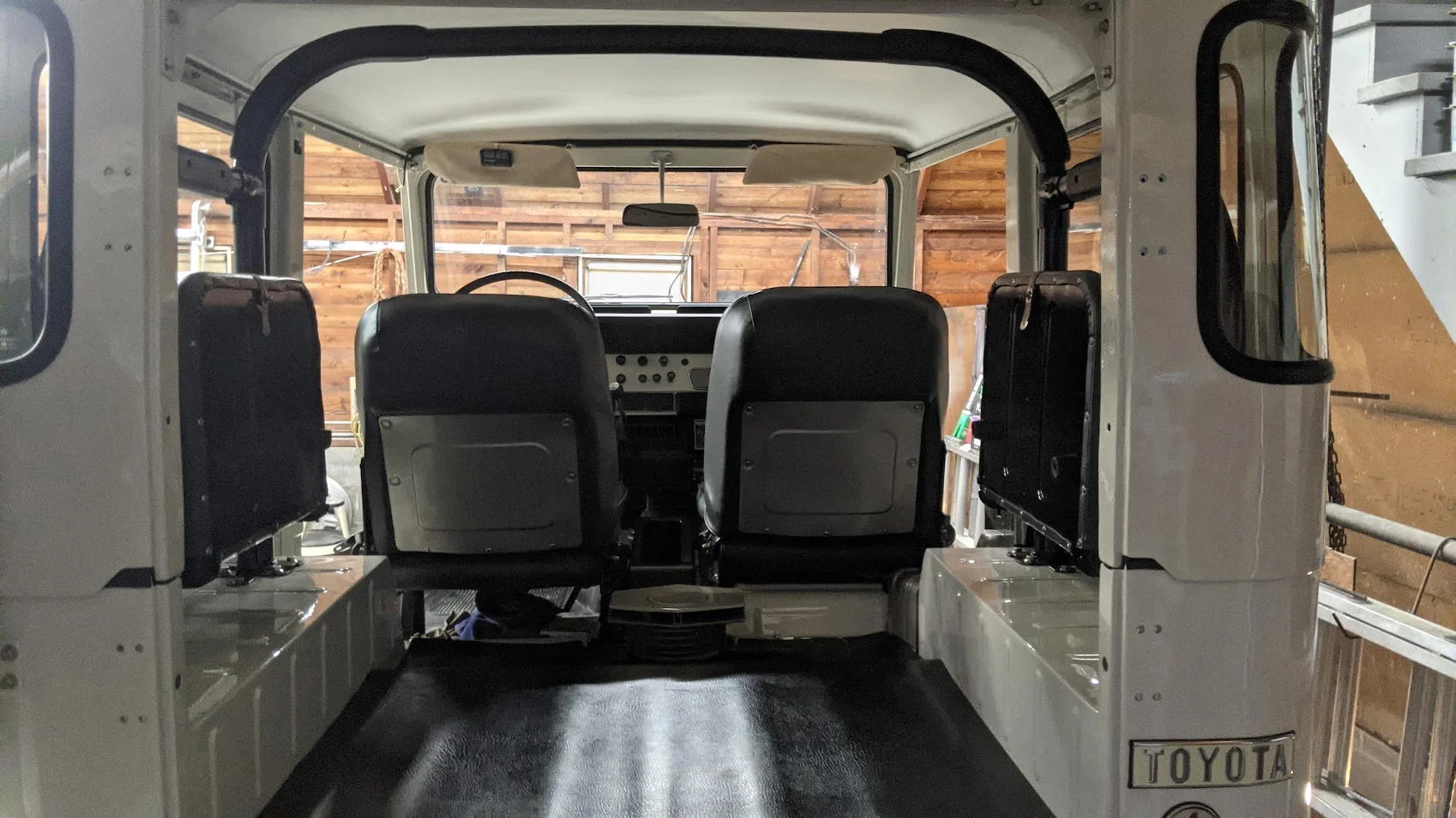

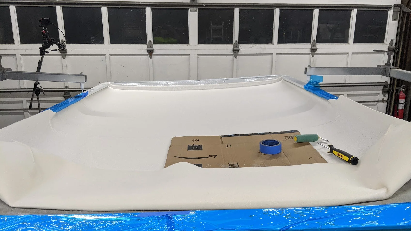

Headliner all in, laid down well but overall a slow job...worked in parts, and made sure to let the glue (3M headliner glue) tack up well. A stiff-napped roller with the 3/4" barrel works very well to be able to reach under the folded headliner, as well as to avoid finger marks/dimples...gives a nice, even press.

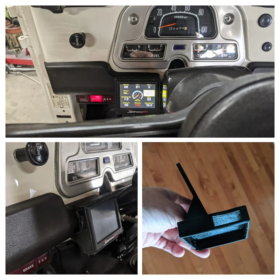

150 miles in...chugging along. Fabbed up Version 2 of the Sniper dash mount, works good - STL attached for any interested.

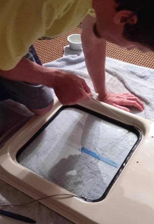

Hardtop glass in - that was a bugger and a half to get that new weatherstrip to form to and stay on the curved rears...but got there. Had to use some Gorilla tape to keep the rubber from shifting and popping off. Living room rug made a good workbench, though. 😆

Facedown on a rug is definitely the easy way to install it solo - hold the near side with your knee to keep the glass in place, and start from the far side. Doesn't work for the two curved ones, though. 🙃

The windows are pretty simple, though - I used paracord (it's big enough to grab on to, but small enough to not be a problem, and it's naturally a bit slick). Dunk the cord in the gap, overlapping the tails. I used a bit of dish soap on the gasket...just keep the window centered to start and pull the cord to the middle. The 40 Channel has a bit on it, although he did it on the rig....I think CityRacer's site has a link to a vid on the installs too. Highly recommend doing it before panel install if you can, it went pretty well using a flat rug to work on. The glass (pre-install) sits proud of the frame, so laying it face down on a flat rug keeps it tight to the frame with fairly even pressure all the way around.

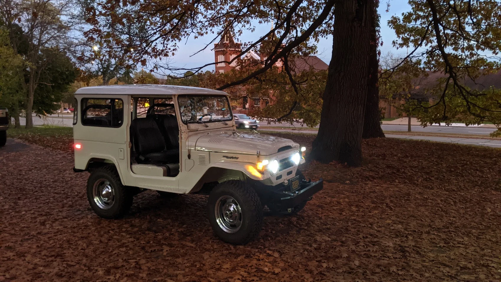

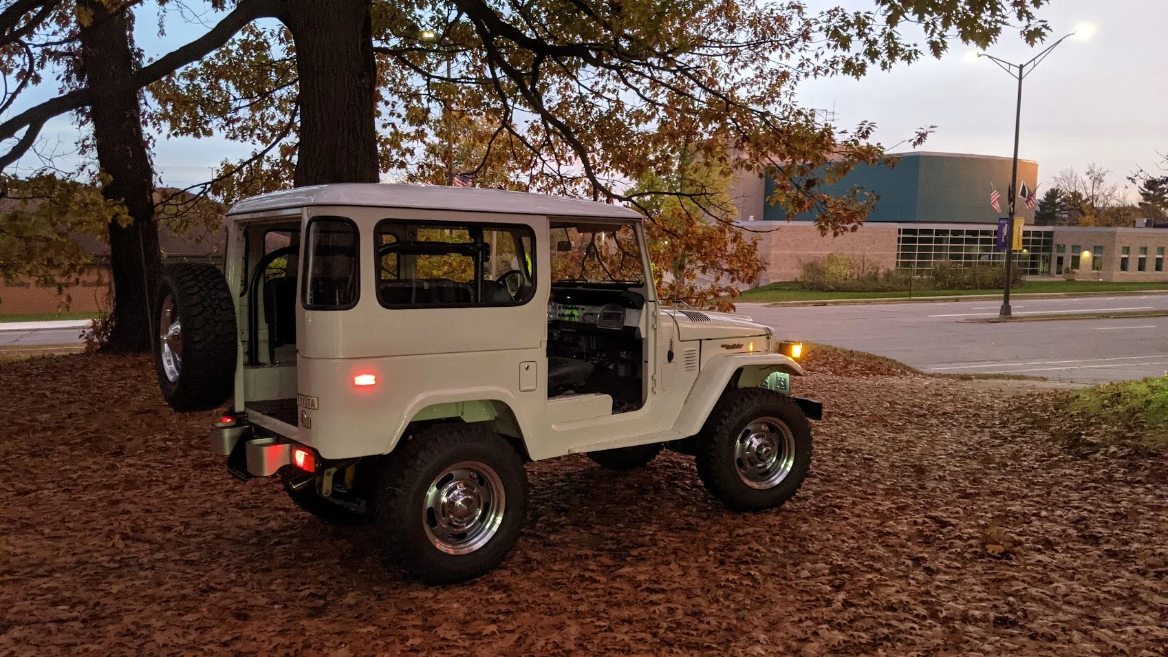

Day of rest today - bit of exploring, and managed to get to 300 miles on the overhaul. Trying to get past break-in before road-salt season is upon us, and not many open-top days left here either. Drives pretty good humming along at 60, and the only real complaint was the rear spare carrier latch needs some adjustment/snugging. Getting about 10MPG on the back highways, about as expected.

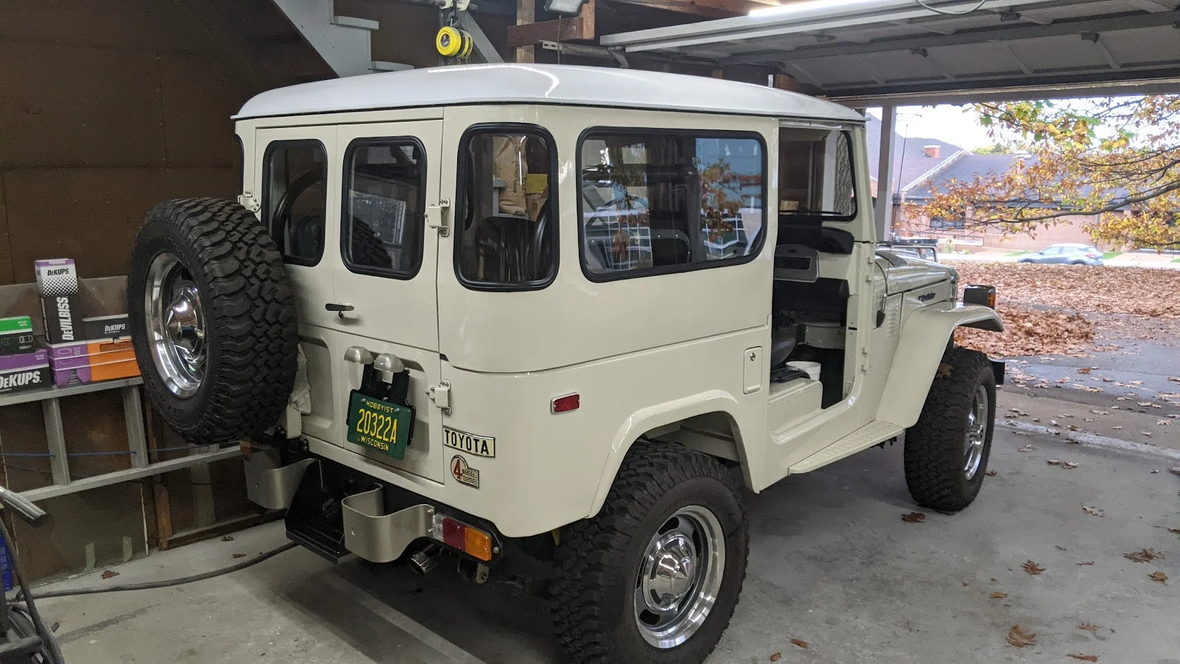

Back to work today...hardtop went on (sans doors) to make some room in the garage before the rain blows in here. Took some fiddling, but sat in ok...ended up working front to back, but that windshield gasket was a bit fluffy so that's why I started there. Happy with the white-white for the classic two-tone look, even though the body is Cygnus. Only a couple inches to spare to clear the garage door.

It looks truly amazing. Great job. All your hard work on the top really paid off.

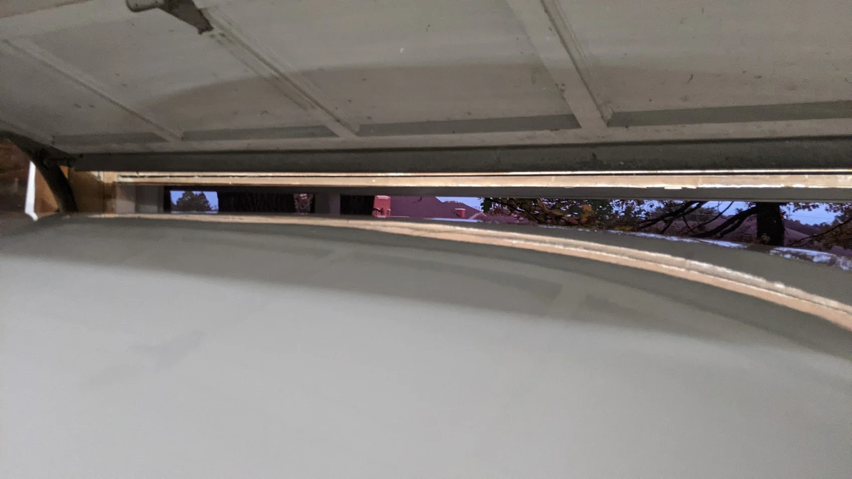

Your lucky on height. My hard top rubs the weatherstripping at the top as I pull it in the garage.
After doing the 2-1/2" lift, ours just barely clears the bottom of the garage door. (I sure would have felt pretty stupid if I couldn't have backed out of the garage.) I told my wife that we had better not add any air to our tires.
Right. I had to inch it in and keep checking to make sure it would work. I do have about 5” of lift and 35” tires though. I’m lucky the garage was tall enough.

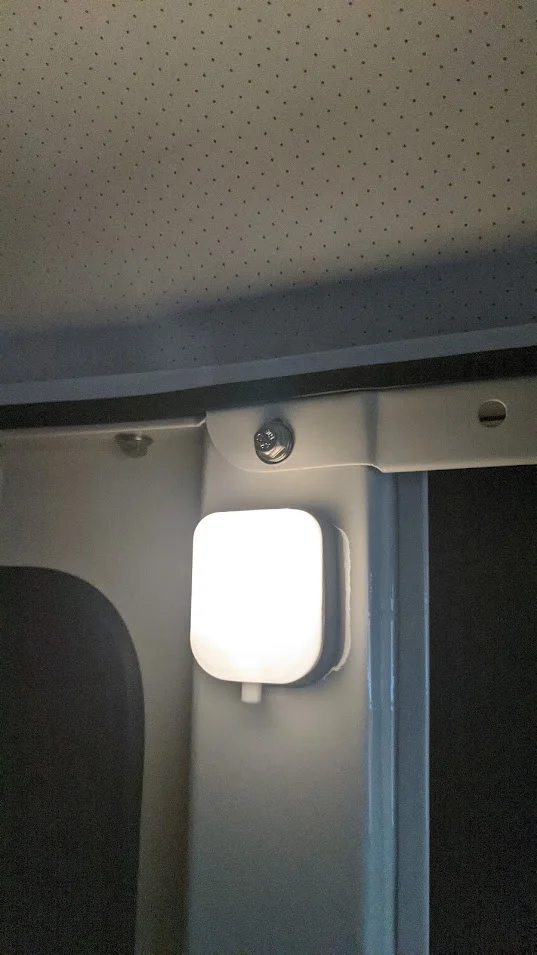

Dome light back in as well...the parts pile is shrinking smaller and smaller.

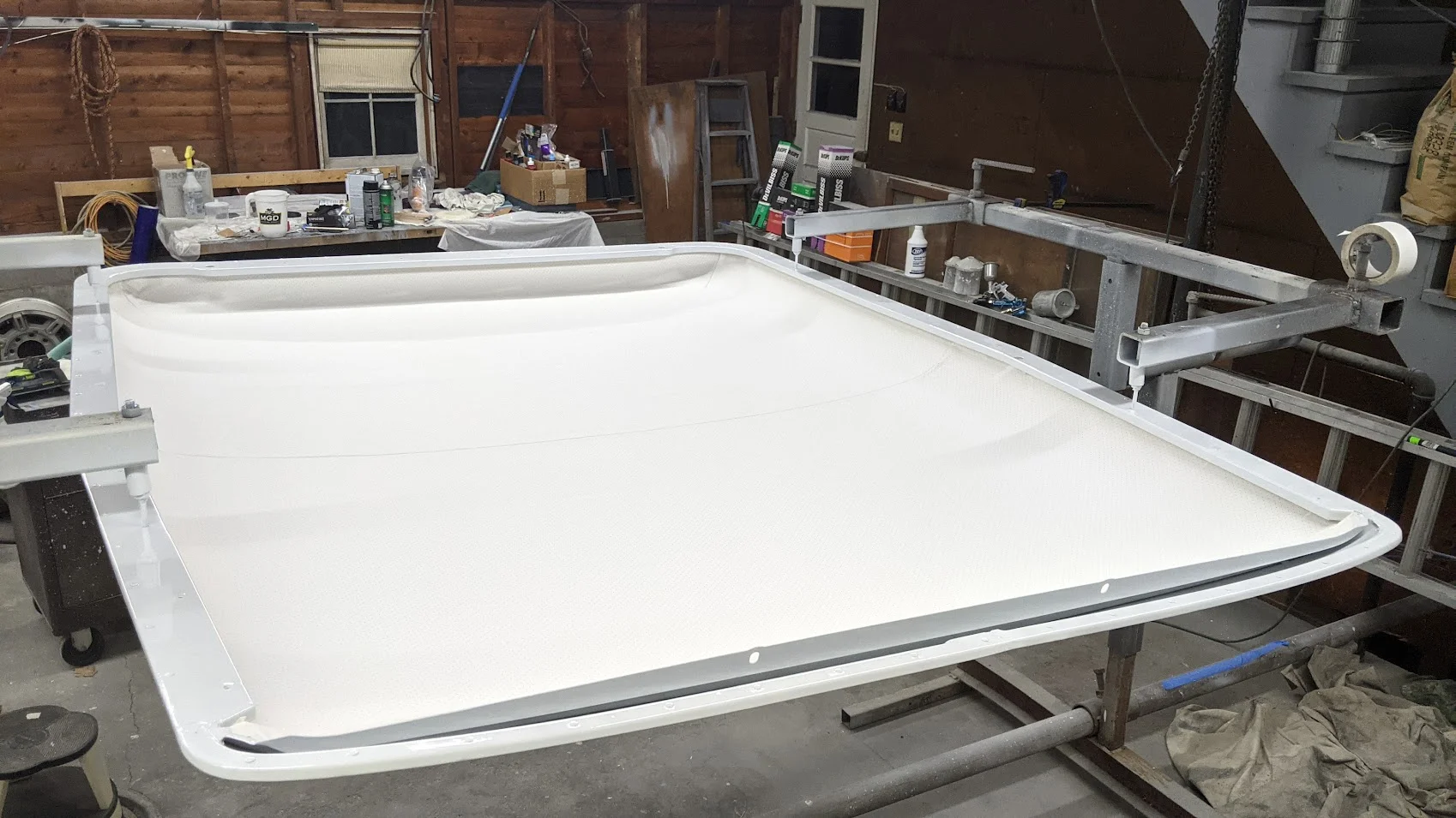

Matched original - up the vertical part and partway across the horizontal. I also ripped some white cloth gaffer tape I had on hand in half (1" wide or so), and ran a strip of that down the horizontal lip just to help keep that edge down...I didn't want to plaster that cross brace with glue everywhere. Ideally, you'd run it to that second 90 degree bend (up the vertical, across the horizontal, and stop), but it can be tricky to trim and it really doesn't matter...the windshield lip actually runs up that vertical bit, so as long as it makes halfway across the horizontal or so (and sticks), you're good. The corners are a bit fiddly too, but you can nibble them a bit once the top is on the windshield.
