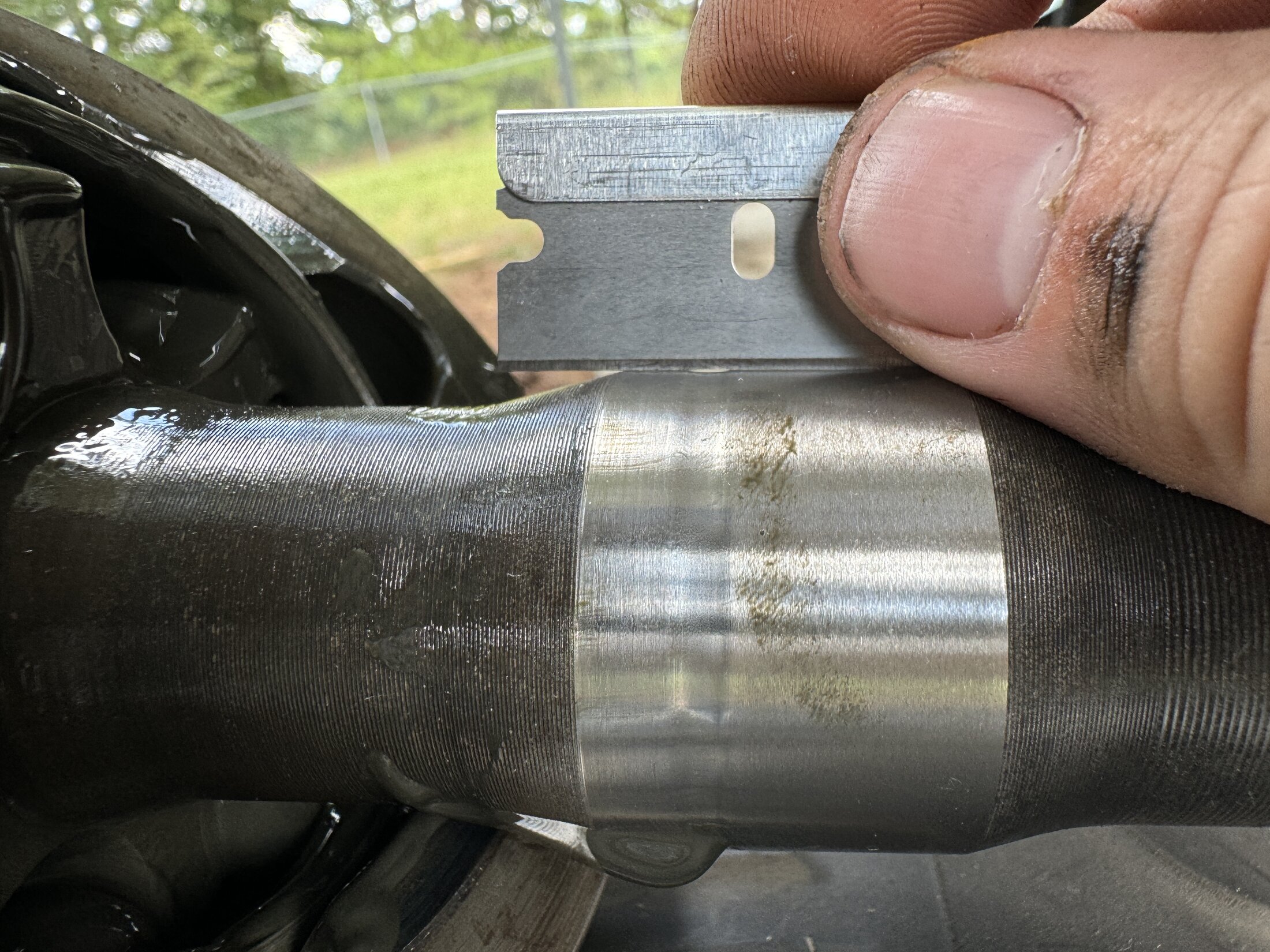

So I ended up deciding that I have no need for the chromoly set. Today I started on the project, and I have noticed some wear on the factory axles. Here some pics, I don’t have a set of calipers with me but I can get some if anyone happens to know tolerances for wear at the axle seal.
Inspect the splines on both ends.
If they aren't showing a lot of wear, speedi sleeve will fix the seal surface.
