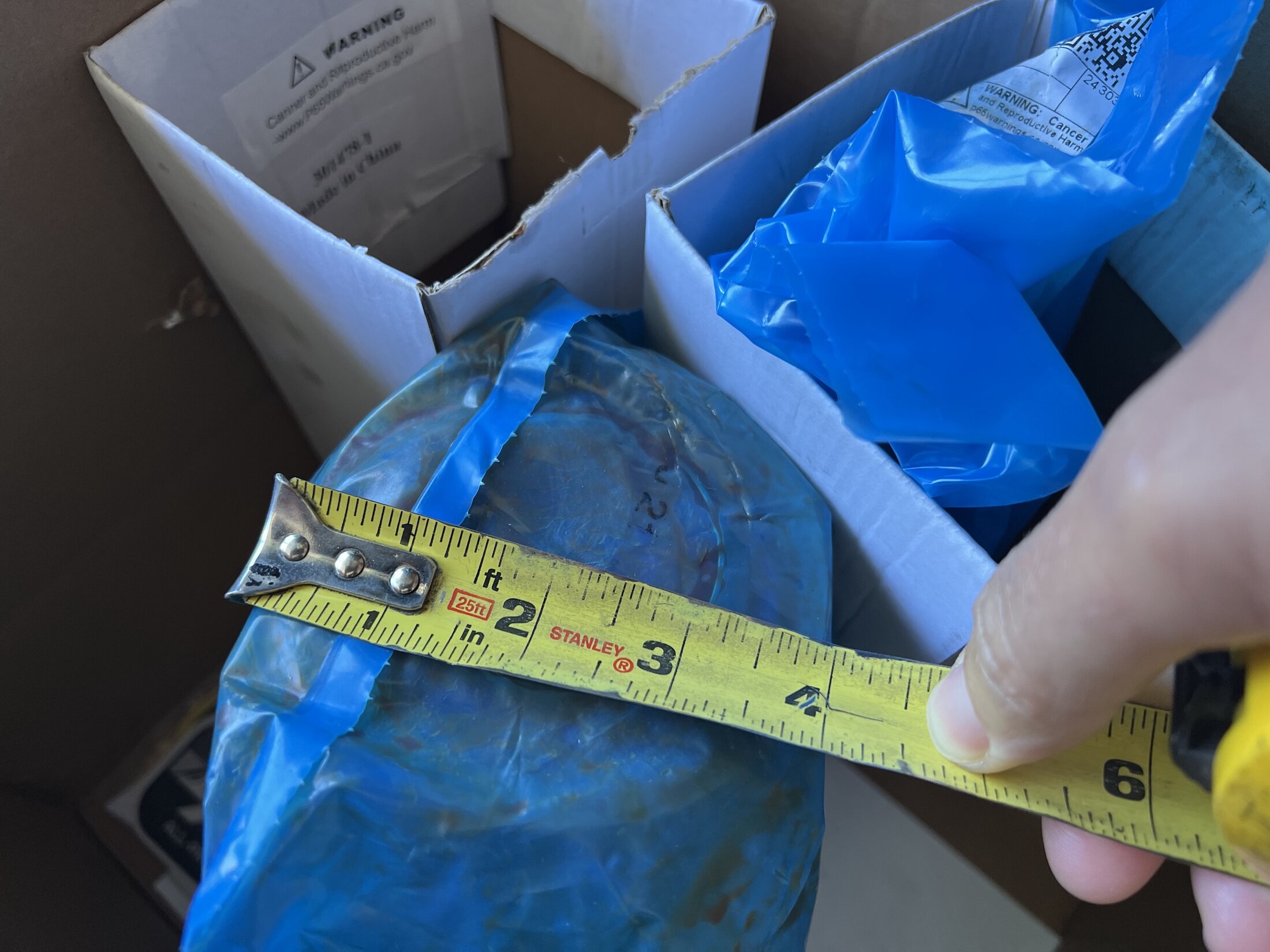

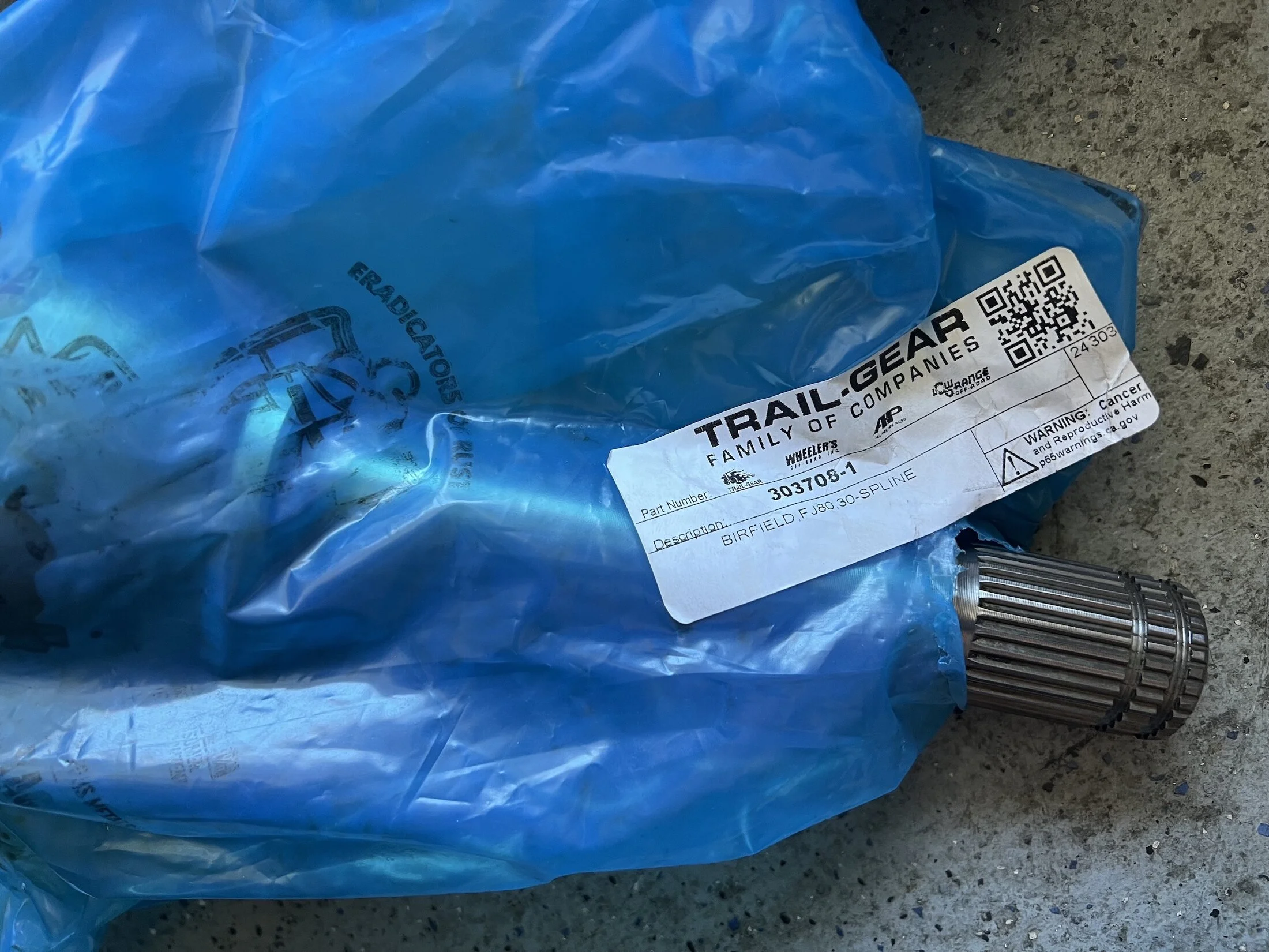

When I saw the Longfield's were on sale I ordered the 30 spline gun drilled birfields. When I got them they seemed smaller than they should be so I measured and they are only about 4" diameter. Stock 80 series are 5" right? Are Longfields and maybe also RCV a little smaller than stock and just use stronger materials? Or they sent me the wrong Longfields? I think 4" is to big for the mini truck and 60 series though? And these are the longer ones with two c-clip groves at the end. The part numbers on the bags that the birfields are in match and say FJ80 30 spline. I emailed Trail Gear and they asked me to send photos and haven't gotten back to me. I should call but wanted to post here so others would know about the sizes once its all figured out.

Following up on my post. Trail Gear replied and said the 4" bell diameter on their FJ80 Longfields is correct. Not sure why they make them an inch smaller than stock. Anyone else have older Longfields (pre Trail Gear) and know if they have always been that way, or were they bigger before?

They were fullsize before they were bought by Trail Gear. Send them back and buy RCV
