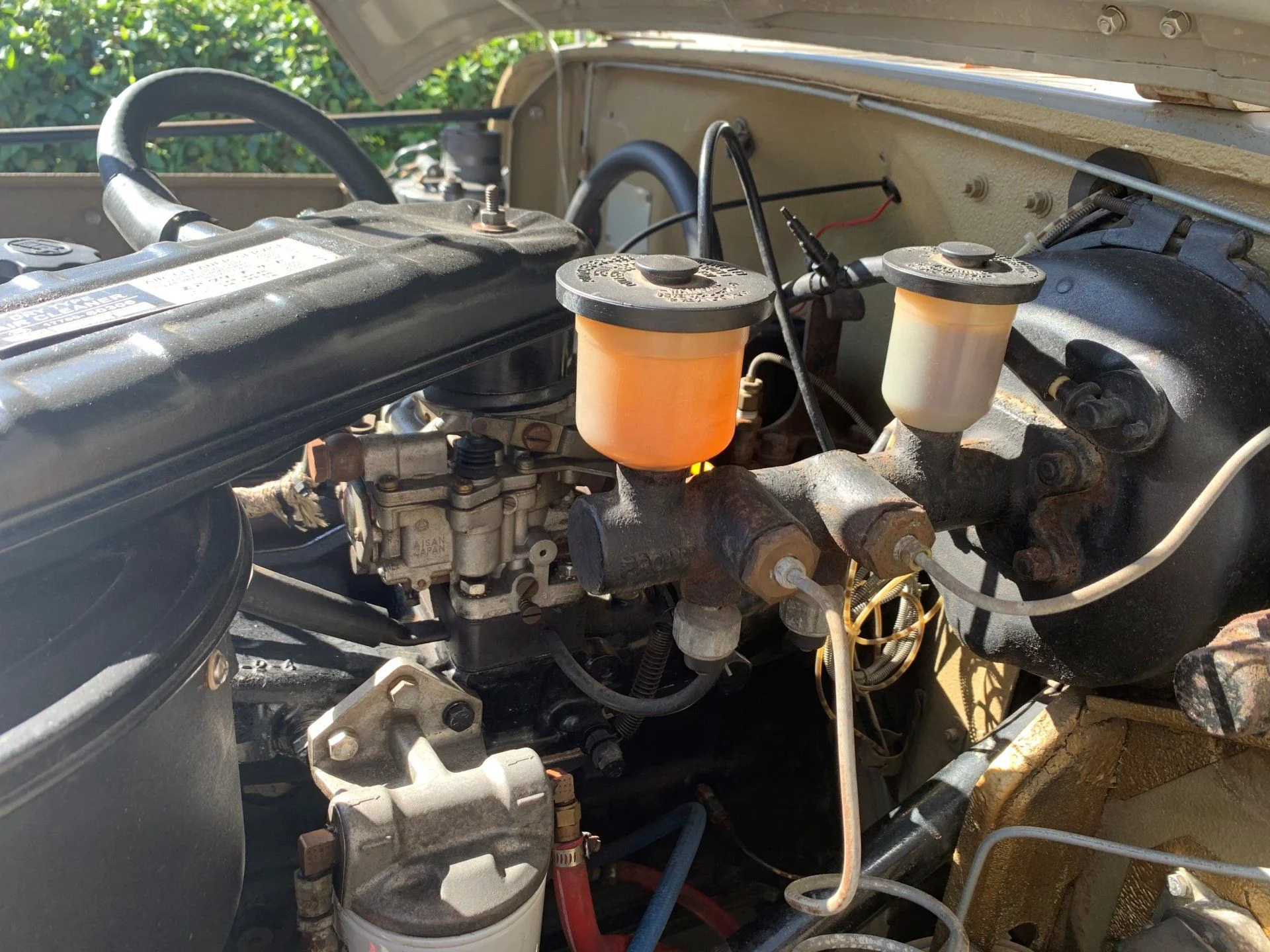

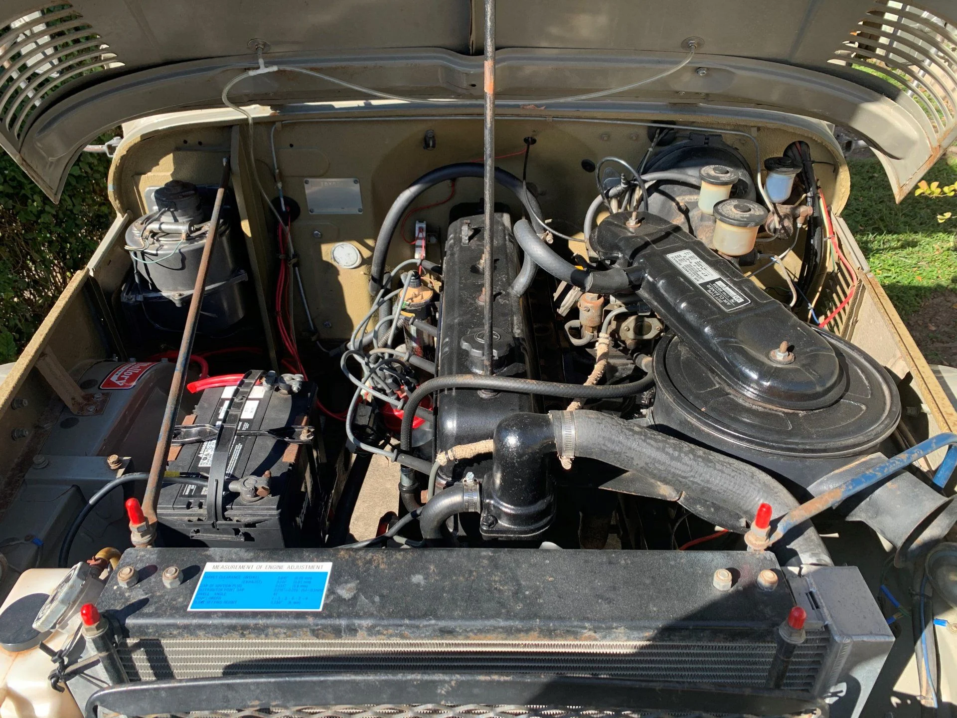

pics of the engine.
Nice pics. Good job. Looks like the stock carb which has the sight glass on the front. Not always easy to see and might need some cleaning or even a flashlight but you should be able to see the fuel level in the bowl. The normal bowl level should be close to halfway in the sight glass.
While you are waiting on your filters, and if you can get the problem to repeat, do not try to restart when it stalls out but rather have a look at the fuel level. If it looks empty, that will confirm that fuel delivery is the issue.
That's not a 71 carb. Here is info on what you have. Early 69 Carb Questions

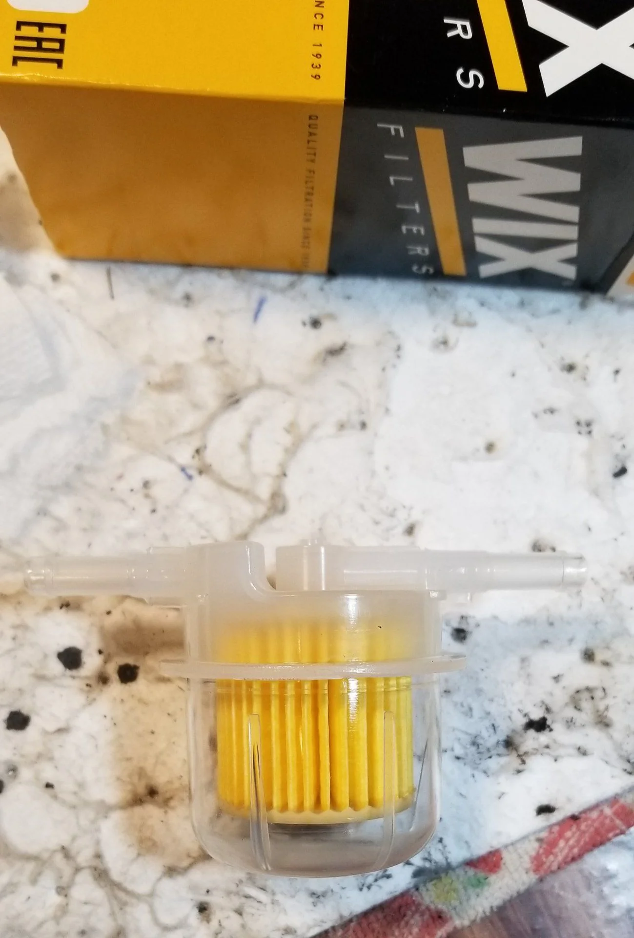

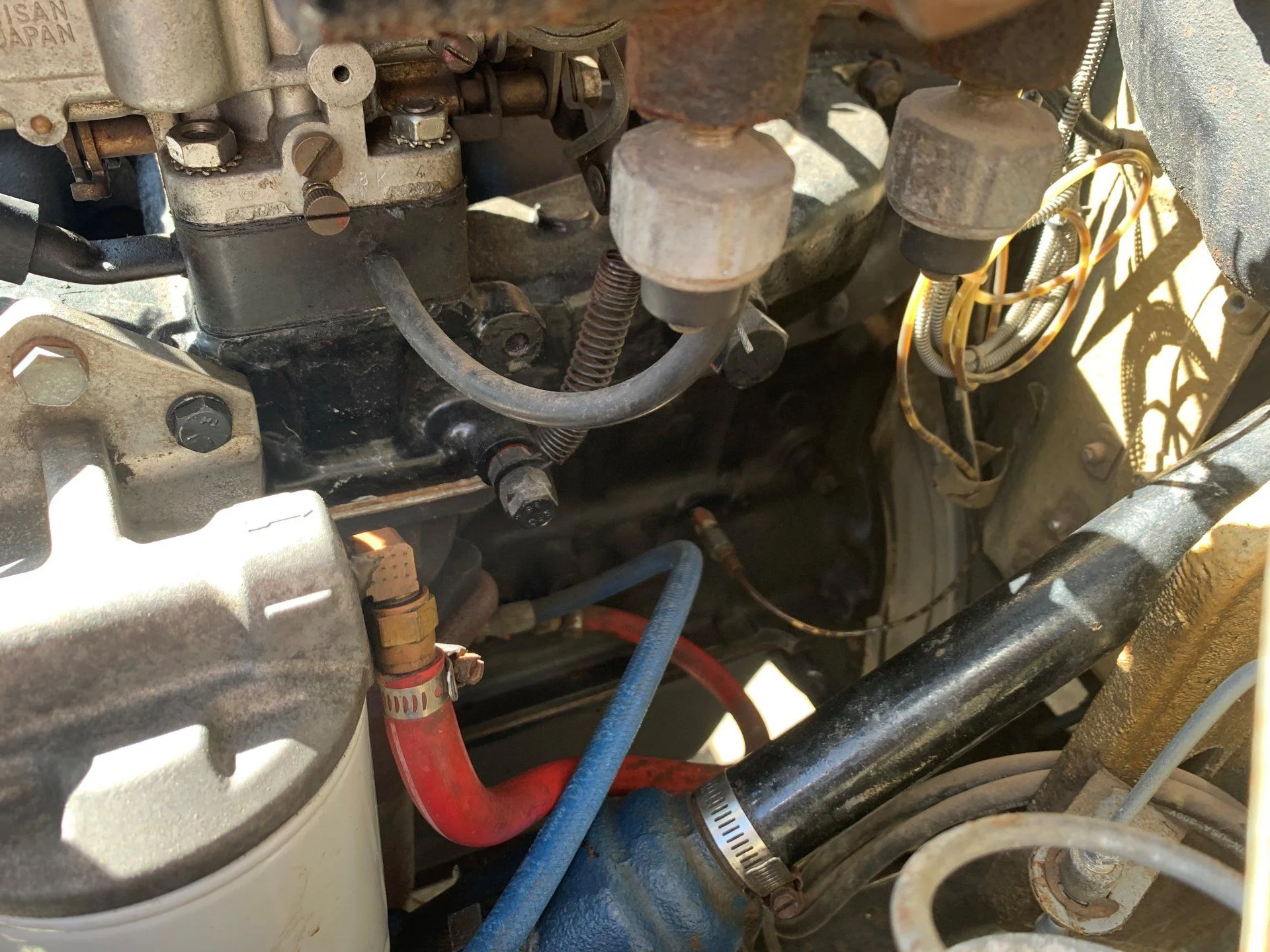

i am having the hardest time finding a filter with nipples on both ends like the one in the first pic.
the first filter i ordered had one threaded end.
the second filter (plastic) was too small for the lines and leaked.
i am going to order the filter with one nipple at a 90 degree angle and see if that fits, unless there is another recommendation.

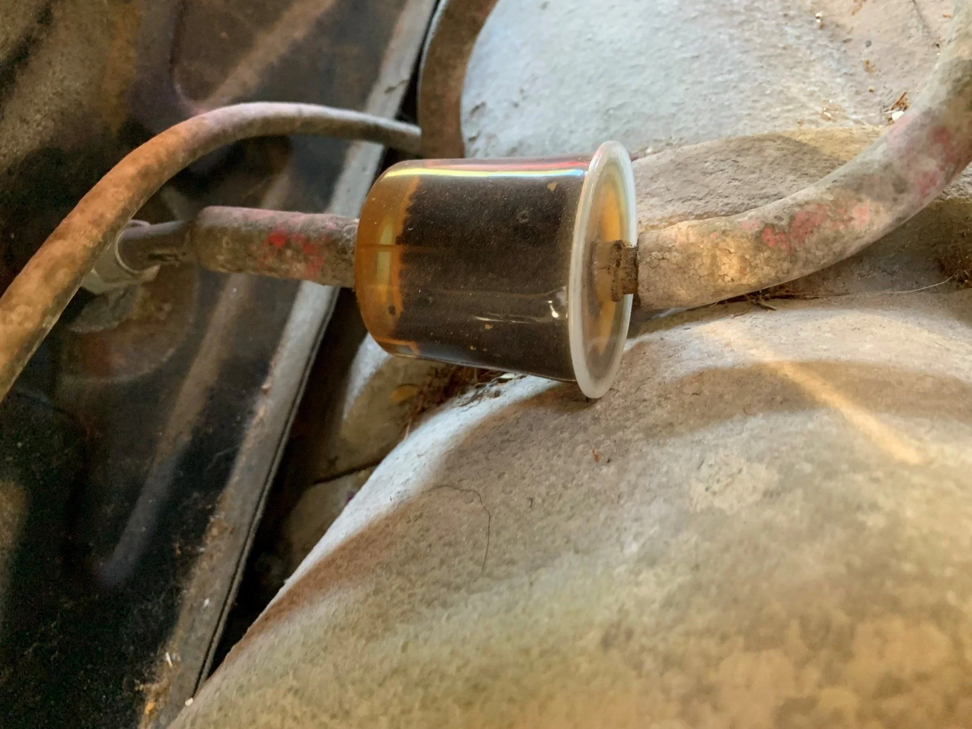

also, under the seat, right off the tank, is what looks like another filter (second pic).
what is that?

That is a added on aftermarket filter. Possibly a Fram "3". Pretty dirty by the looks of it.
This would be a good after market from Wix found at most car parts places. You should replace both filters.

WIX 3302, assuming it's 5/16 line (equivalent to the original toyota, which was likely metric).
Amazon product ASIN B000CSD28M
In the second picture (under the seat?), line looks AWFULL condition, and there are not clamps on it... Not good.
And that filter is dirty as !@#$.
Suggest replacing especially that filter. Wix filter listed is transparent (plastic) so you can see it get dirty. Use hose clamps. And consider replacing a lot of that fuel line. And, beware, once you pull that apart you're likely to have whatever gas is left in the tank run out that hose. General method would be to clamp the line from the tank, but that line looks like it's about to crack and fail, and it short... (clamp with needle nose vise grip, or the fancy pancy harbor frieght line clamps or similar)
Unfortunately, that filter is right off the tank, and is probably that dirty because the inside of the tank is rusty. Start by changing it and see how long it takes to get dirty.
There is a drain on the bottom of the tank, if original, I'm told. Beware of it being rusty and breaking off.
The other filter, metal one, under the hood, probably oughta replace also, you have no idea what's going on inside it. Could be nice and clean, with the first filter catching everything... Could be clogged, with a bunch of dirt that wasn't replaced before that filter inside was added.

i am very worried about the lines cracking if i clamp them.
the tank is pretty full.

If you're worried about the line cracking, you should replace it.
On my FJ40, that line is rubber from there through a hole in the tub (with a grommet) between the seats and then connects to a metal line under the tub which runs up the frame rail.
Easiest is probably to cut / pull apart the rubber line under it, somewhere that you can put something to catch it. And, remember gas is kinda volatile, and can melt some plastics... DOT approved gas can is probably safest.
Or, maybe easier, if it runs long enough, burn it in the engine. Next time it dies try just shaking that filter.
Or some of both.... (hard to find a gas can larger than 5 gallons)
