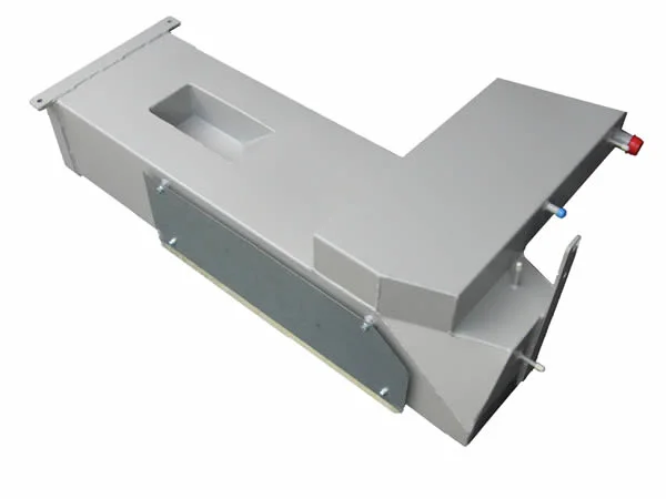

I would guess that it would and maybe I'll try asking a different way. It looks like there is a cable or something in the way under my fj60. I guess the main question is if the catalytic converter is in the way. That section of the crusier shouldn't be any different between left-hand and right-hand drive, right?
I think the main part of the tank sits between the exhaust and the driveline. It is four feet long which puts it about six inches into where the catalytic converter is. It sounds like it should fit but I just sent them some more questions for clarification.
Ive seen one of these tanks on a rig. they fit on the right hand side between the drive shaft and the frame.
it does not matter if they are right or left hand drive... Or, is that even the question?
This is what I am looking at from the original site -
http://www.thelongranger.com.au/60serieslongrangefueltank.html
Fitting Location:Under Vehicle, Between Exhaust System & Right Hand Side Chassis Extending Up Over Prop Shaft
Exhaust Modifications:Minor Modification To Heat Shields & Exhaust Bracket On Some Models. Exhaust Pipe & Muffler Left Standard.
I think I have seen pictures of that one but I can't remember where. I am mainly interested in it as a second tank for a dual-tank veggie system. You are supposed to connect the aux. tank to the original tank but I think you could leave them disconnected and set it up as dual tanks. Don't know if the tank hangs down too low though. Seems awfully exposed.
