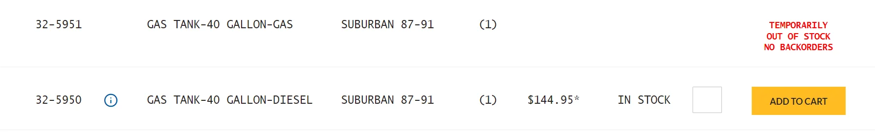

Edit: link to the 89 burb tank @ lmc truck
better to post tank part number as that particular site's links give you a drop down menu instead of taking you directly to the correct part. leaving room for error. plus, links go dead.
You're right, using a menu to select "1989 chevy suburban" is hard!
This is just an example, and clearly they're out of the gas version. You can find an '89 burb tank anywhere on the internet.

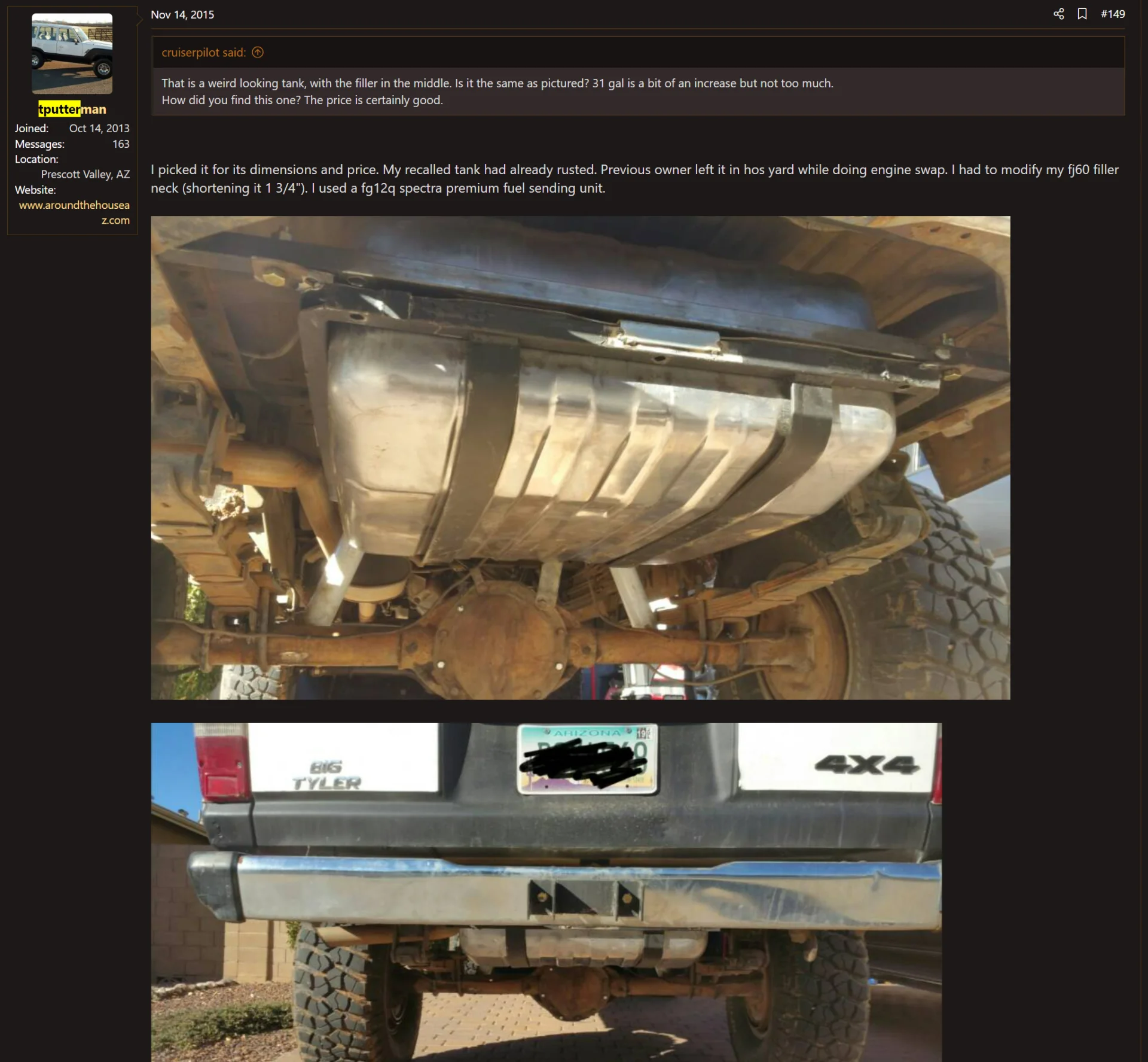

Ah, found it. In one of the other threads searching for a tank to put in, and a guy @tputterman put a spectra premium gm14b tank in his 60. From googling around, this appears to be the late 80s suburban 31gal tank. The late 80s subs came with either 31gal or 40gal apparently. I thought it hung down kinda low, but that might just be the way the guy hung it.

I got ahold of him, and took some pics... the install was a bit redneck if you ask me. it does work so i will give him his due, he did it, but drilling holes in the floor for backer plates isn't my speed. I'll post pics when i'm not 1/2 a bottle into some laphroig. .. in exchang for some partts hes gonna give me a tank for my next build. I'll make some more copacetic straps from some toyota pieces/parts and while no more effective, less hokey. .. i mean hes feeding a 383 with a double pumper from a 42 g tank sucking it dry, and had an accurate fuel gage, and its solid, but just not my speed, for appearance.
How low did it hang compared to a stock 22gal tank?
I'd say level with the frame or close to it. If youre a 2" body lift kinda guy for 35's like me, I'm guessing you could use a flat piece of sheet as a skid plate and have some room for distortion from impacts. I'd rather have jerry cans than low hanging un protected fuel tanks. I've never seen anyone destroy a tank, but the ones on my Gwagon and Trooper always seemed kinda low, like "oops we forgot we needed a tank for this design, so let just stick it right here". not a fan.
