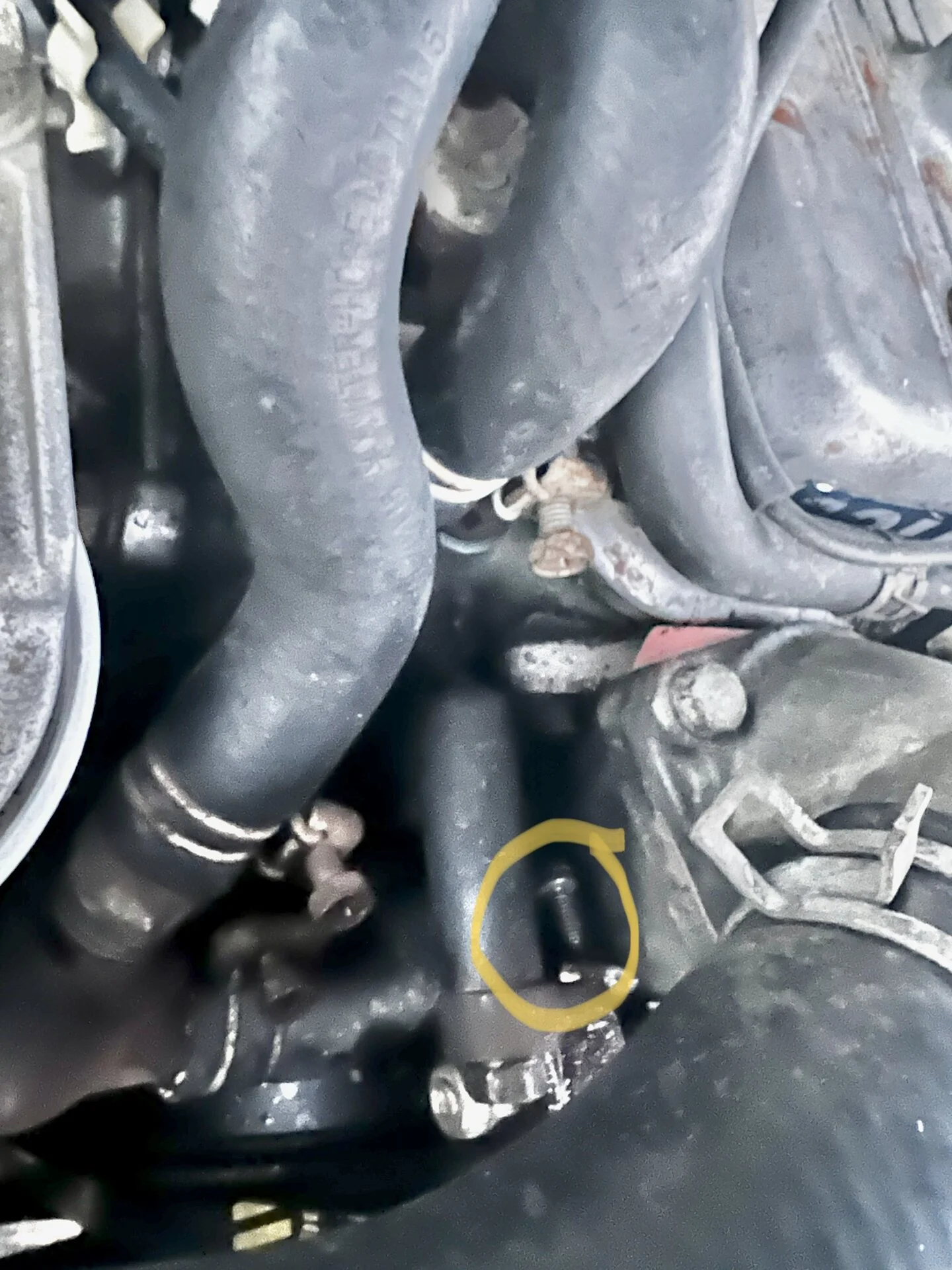

@duncanrm - THANK YOU for the advice. Drained some oil, and zero coolant came out. It took about fifteen minutes of prodding around the engine with a flashlight to find the source of the leak - looks like i loosened one of the clamps on one of the hoses going to the bottom of the thermostat housing too far while replacing the tensioner pulley, and the screw slipped out of its place. When i went to tighten it, it just bottomed out the screw without actually sealing it, while feeling plenty tight. Had to pull the whole tensioner assembly to get the damn thing back together because it's so tight in there.
I had a spare t-stat and gasket sitting around, so I did a boil test, confirmed both were opening at the correct temp, then reinstalled the older one after thoroughly cleaning manky old gasket off the t-stat housing/cover with a razor blade. Good to know my spare is functioning correctly when/if I need it.
I then refilled oil and coolant, started up the truck and ran it for a few mins. The puff of white smoke from the exhaust manifold/valve cover is still happening, but no coolant drops. Going to test again in the morning when i can see better, but things are looking good.
The hose itself was in poor shape (clearly overtightened by the PO since I haven't touched it), so I added a couple to my megazip order to replace now and have a spare for the future.

Super! Sounds like thats the thermostat bypass hose you're referring to.. It would be worth taking the time to replace this when time permits - and fresh hose clamps.

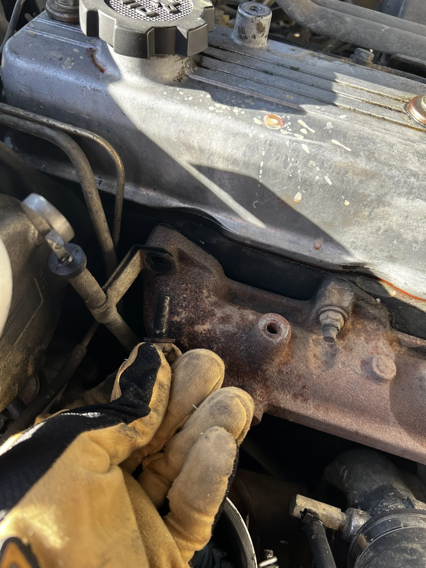

Well, my exhaust manifold job just got a lot harder. Pulled the heat shields with no problem, and once the intake crossover was out of the way enough to pull off, I noticed this exhaust stud was just pre-sheared for me 😭
Nice and deep in there too.
