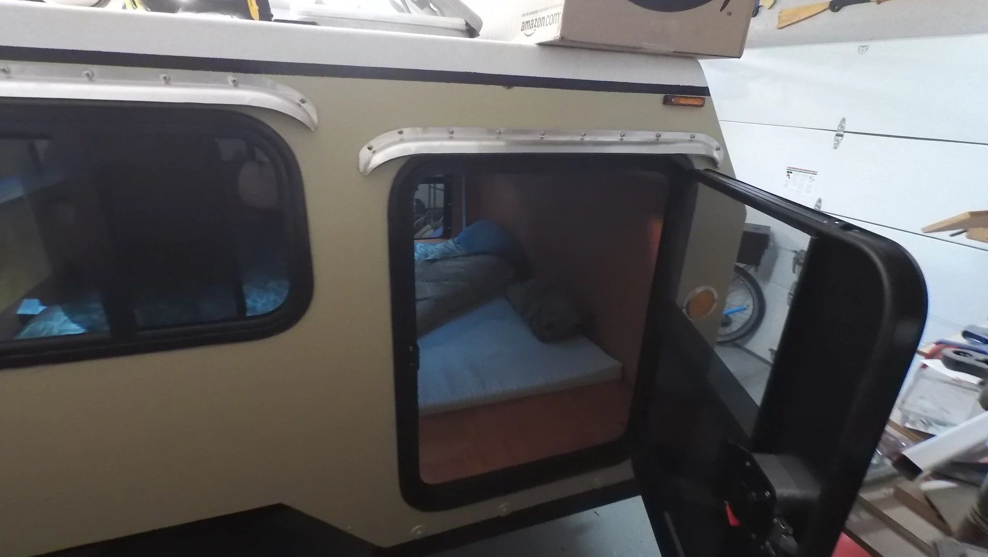

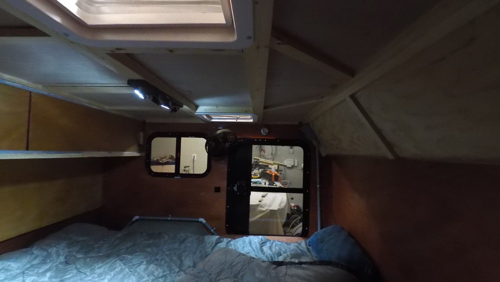

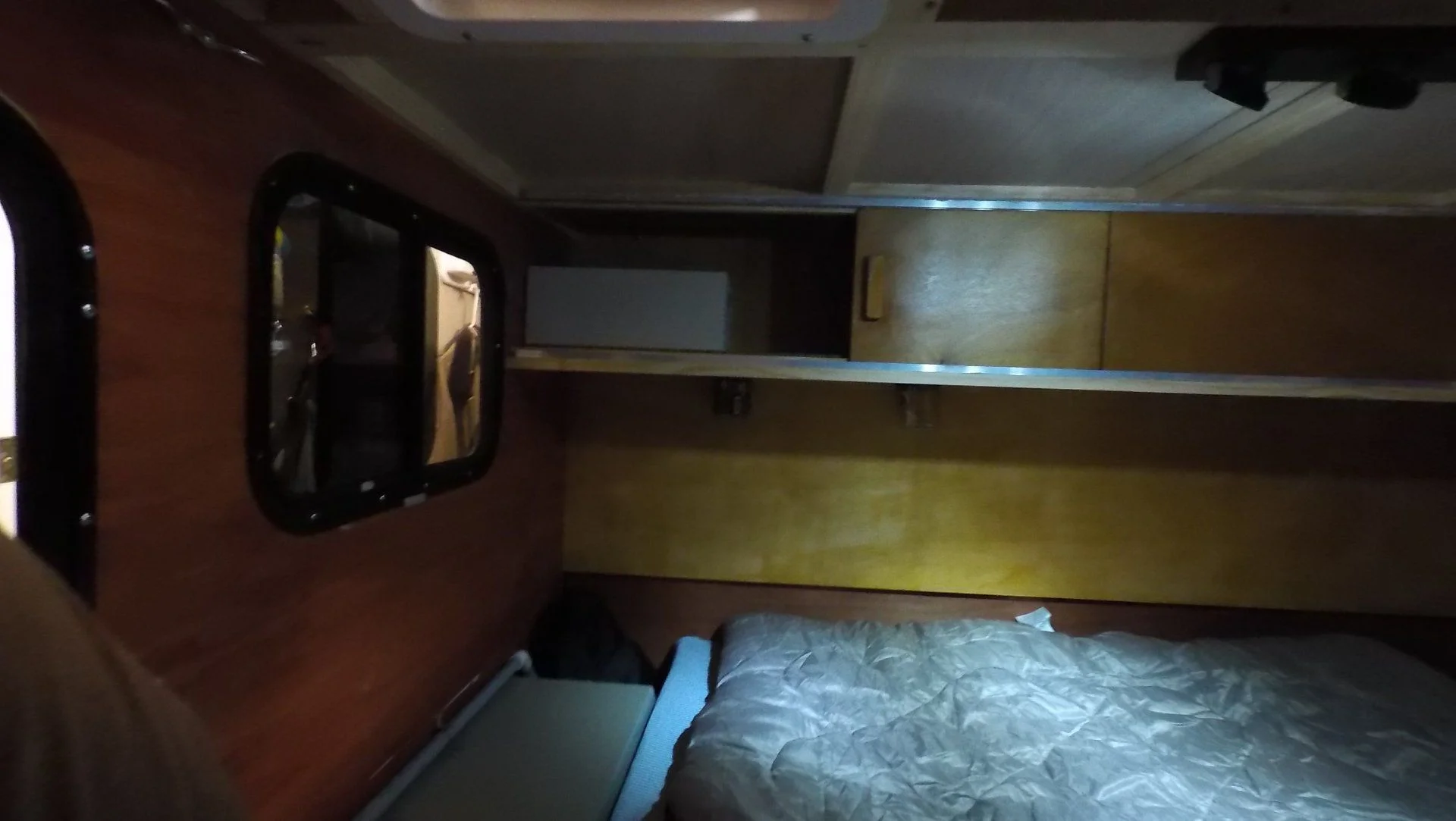

A few interior shots. Not much to see. We will need to camp in it a few times to decide what else needs to be in there like additional shelves and such.
· Going in from the passenger side. Shows the box just inside the door that serves as a nightstand/pocket dump and platform to get in and out so you don't have a 1/8" aluminum edge up your backside.
· Custom sized mattress just slightly smaller than a queen by an inch or 2 but a lot bigger than a full.
· Ceilings left bare purposely in case a leak develops I can find it fast.
· Gotta keep cool in the summer. 10" fan for each side.
· Sliding door cabinets to keep them from opening while driving. Possibly adding a shelf in there down the road depending on what we discover we need.

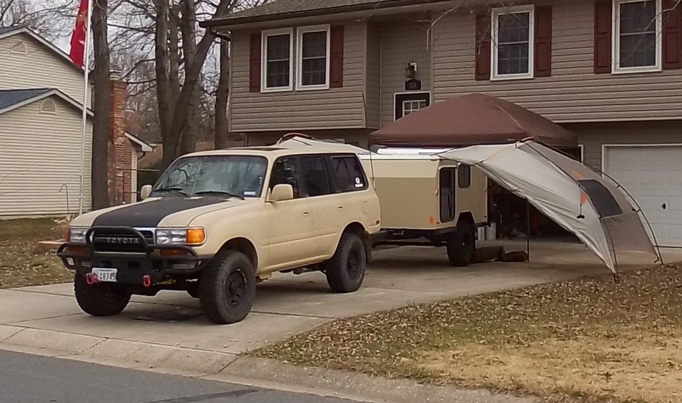

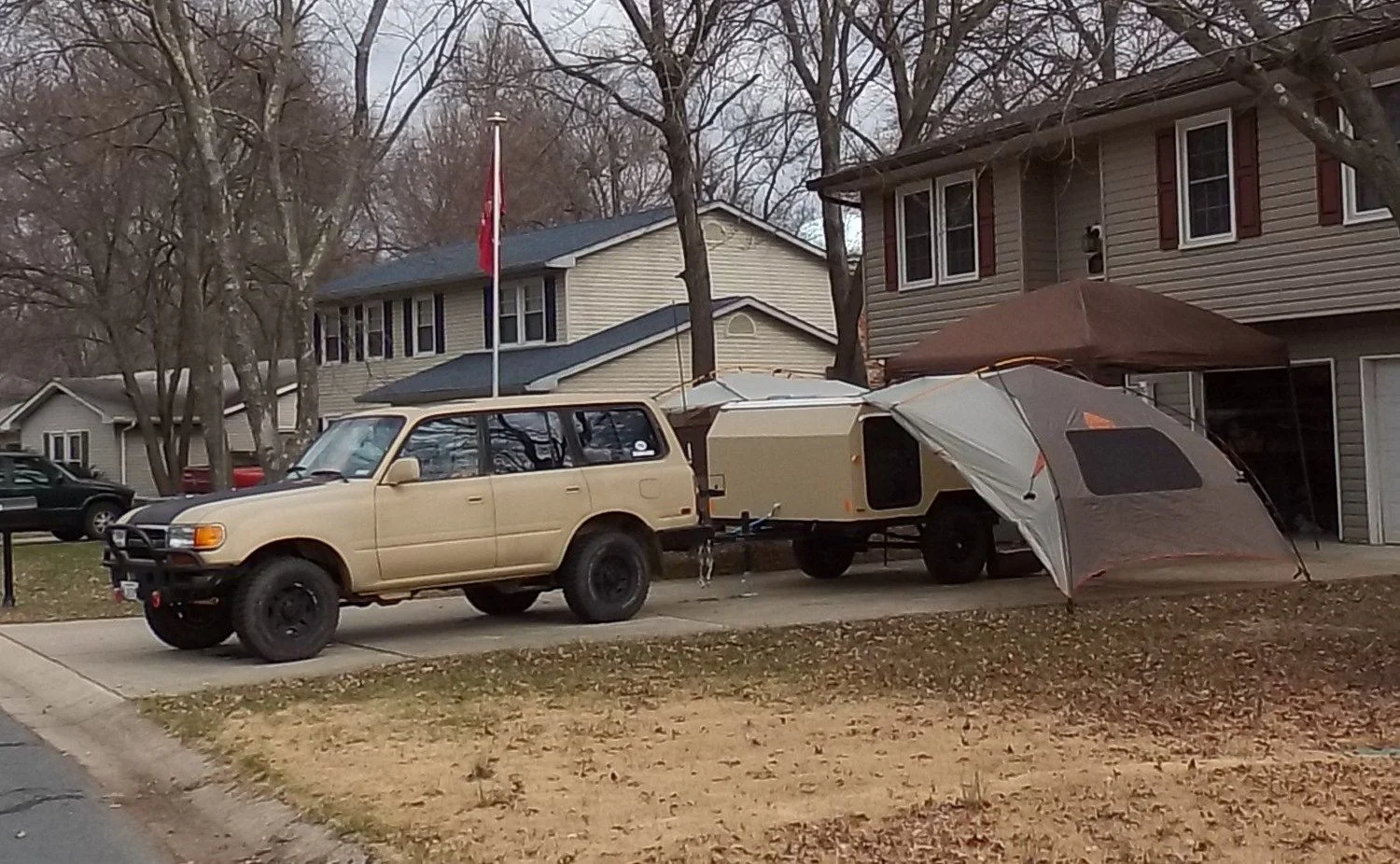

Haven't weighed it. I would guess around 1100lbs based on other trailers i have had. Doesn't even phase my 80. Only notice it because it blocks the rear view mirror. No plan to extend or change the hitch at this point but needs can change over time.
Love the grill! Wonder how many drivers you come up behind think that thing might be a bomb you'll be trying to ram up their arse! LOL!
Nice work! Plan to keep gravel spray from tearing into the trailer nose?
Great job Josh!! Outstanding attention to detail!! Now go out and enjoy it!!
Love to, seems every occasion I have had to get going something else came up at the last minute that took a much greater priority :bang: Cancelled 3 trips already since Feb. I will get out dammit, I will. :rolleyes:
