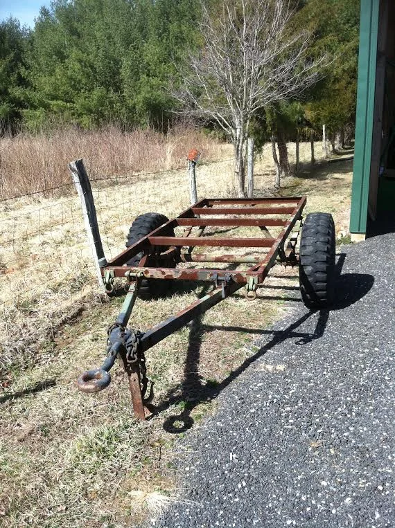

So back in April I bought this for $100:
full

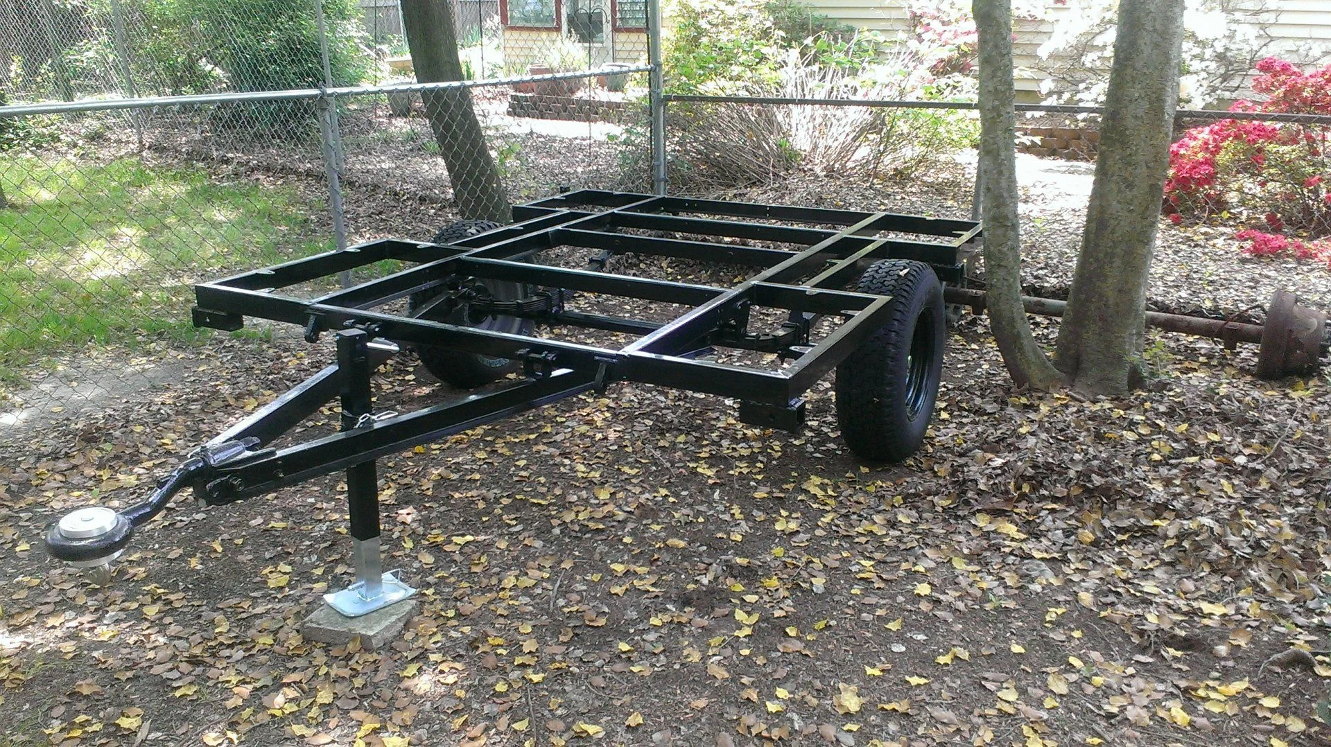

And after a few deals with a fabricator friend of mine she looked like this but ended up sitting until the end of June:

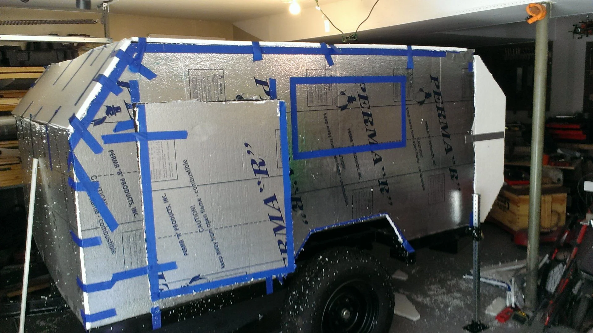

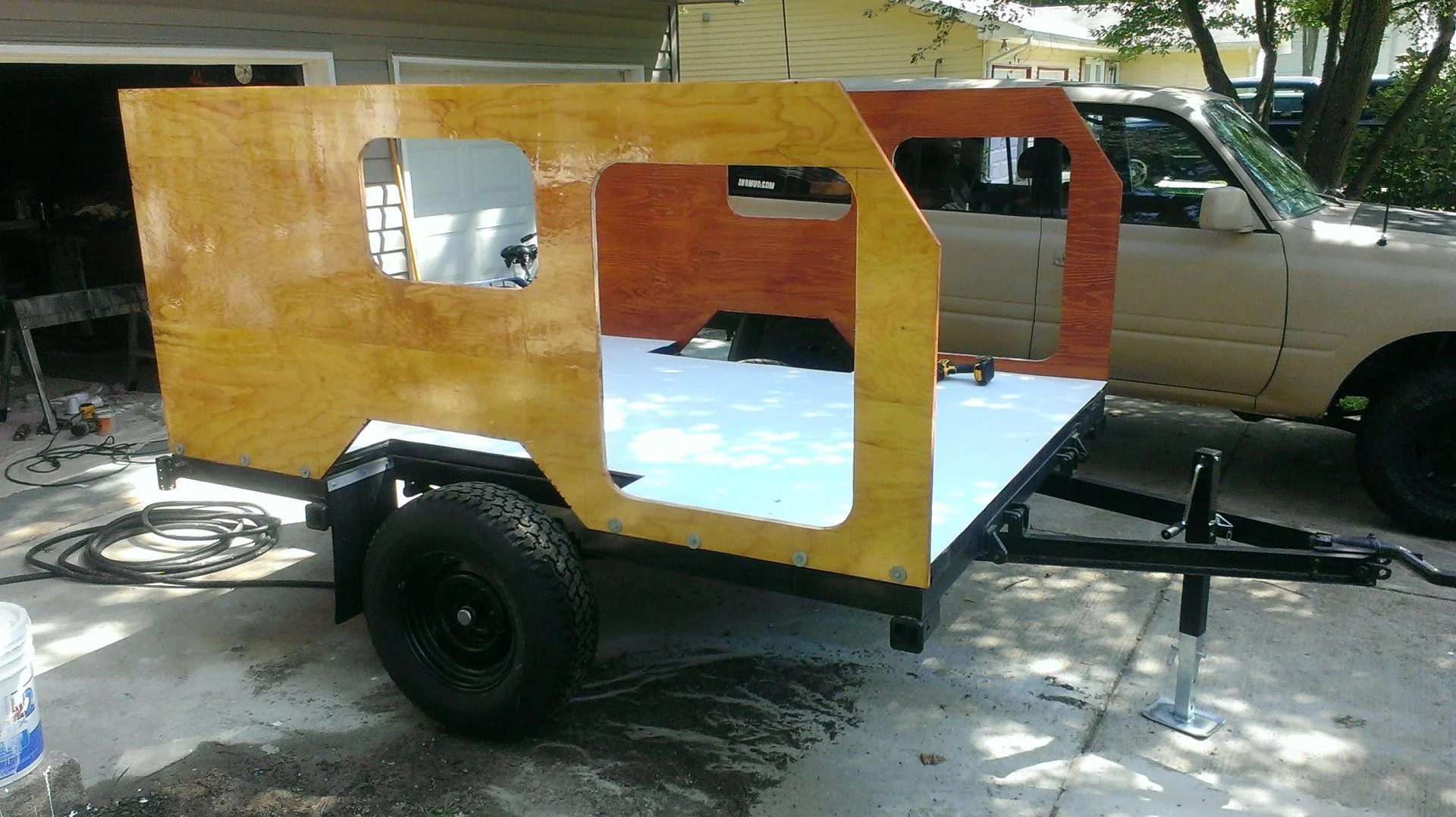

And then the build began...

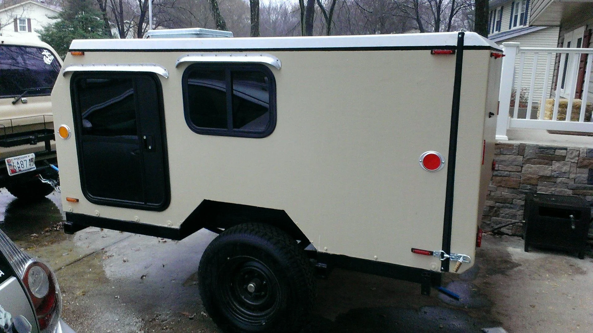

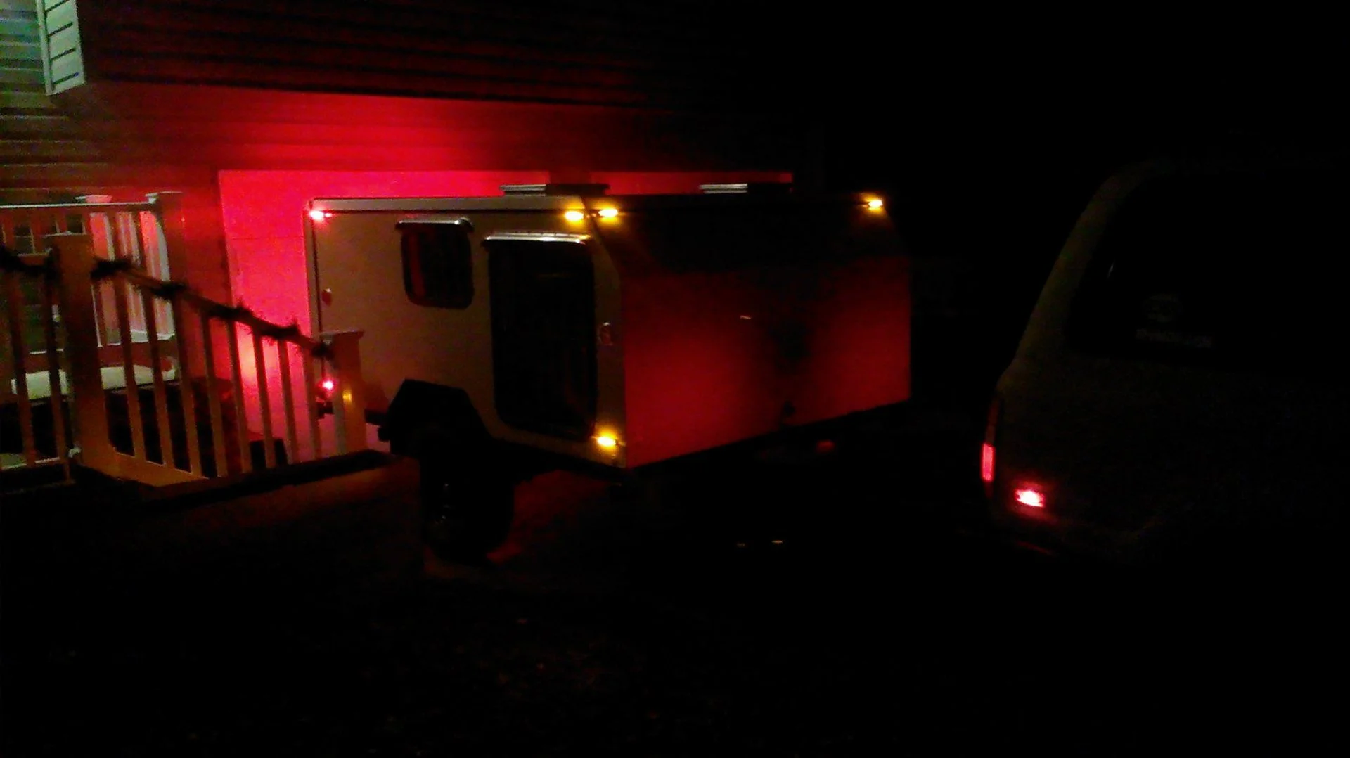

And that's where she sits today. 95% solution and just about legal. Will be roadworthy within the next 2 weeks and camp ready before Christmas. Steel frame coated with POR-15; treated lumber wood frame, covered in Thompsons, then roof flashing, then plastidip; marine grade plywood; 4 coats of marine fiberglass; 2 coats of marine self levelling primer; 3 coats of tan paint; 2 coats of rubberized heat reflective white roof paint. Every seams fiberglassed on the outside and caulked with silicone on the inside. All lights are LED. 3500lb axle with a 6 lug pattern to match my truck.

I think you did a great job...although I'm a bit concerned about the weight of the fuel and water that far back over the rear axle. I think that could equate into some serious sway issue, maybe when you least expect it.
Make sure you seal the crap out of any seam or perforation of the exterior skin...water at 60 mph can get in anywhere.
Looking forward to more progress shots!
that thing looks soo cool! i love the angled edges . very nice work too.
i have the same concern about the weight in the back, wouldnt take much to counter it tho; i . e . a battery and or some fuel cans on the tongue.
cant wait to see the interior .
Already noted the cans were just there to see how much I could stuff in there. The fuel cans ride on the rack on the back of my truck anyway and the water cans can ride inside of it. Lawn chairs and canopies fit very nice in that spot on the trailer and weigh next to nothing. Not a single hole that pierces the outer skin that hasn't been pumped full of silicone.
