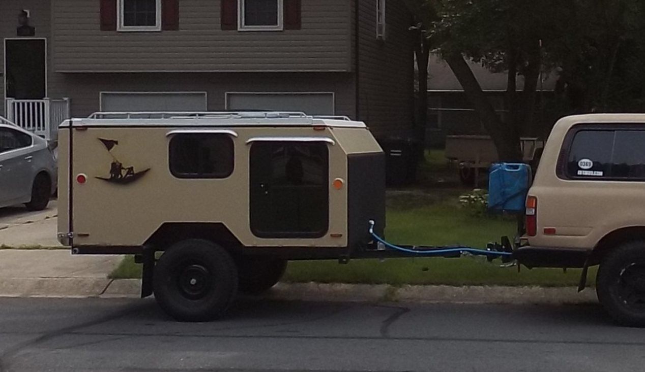

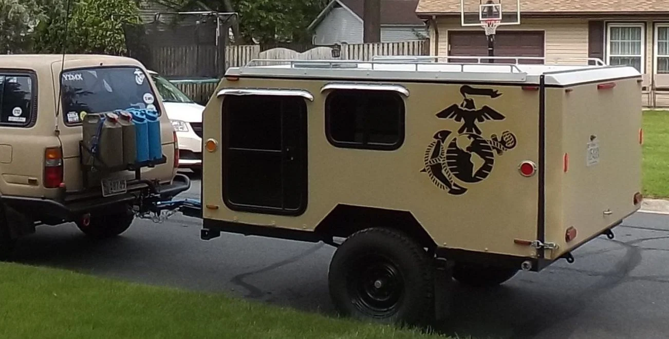

I would have definitely rethought the back hatch. Since I fiberglassed, I could have made the back hatch out of foam rather than thin p-wood. It has never been impacted as best I can tell and foam would have been lighter and easier for routing wiring. Having lived with my design choices I like the fenders on the inside since it gained me a lot of room, but fenders on the outside would have been easier. I built this to be as durable as my truck, so overbuilt. I could have built it lighter overall with similar durability. I do want to build another, but still have this one so unless I get around to selling, likely won't. Otherwise I have been considering a tongue rack for additional carry space. Overall we are still very happy with it. I aimed for utilitarian durability and have that. Since I mentioned building lighter, that is not influenced by the overall weight or effects on my truck. As a woodworker, I have learned techniques that I would like to apply. The challenge of lighter weight with similar durability is appealing.
