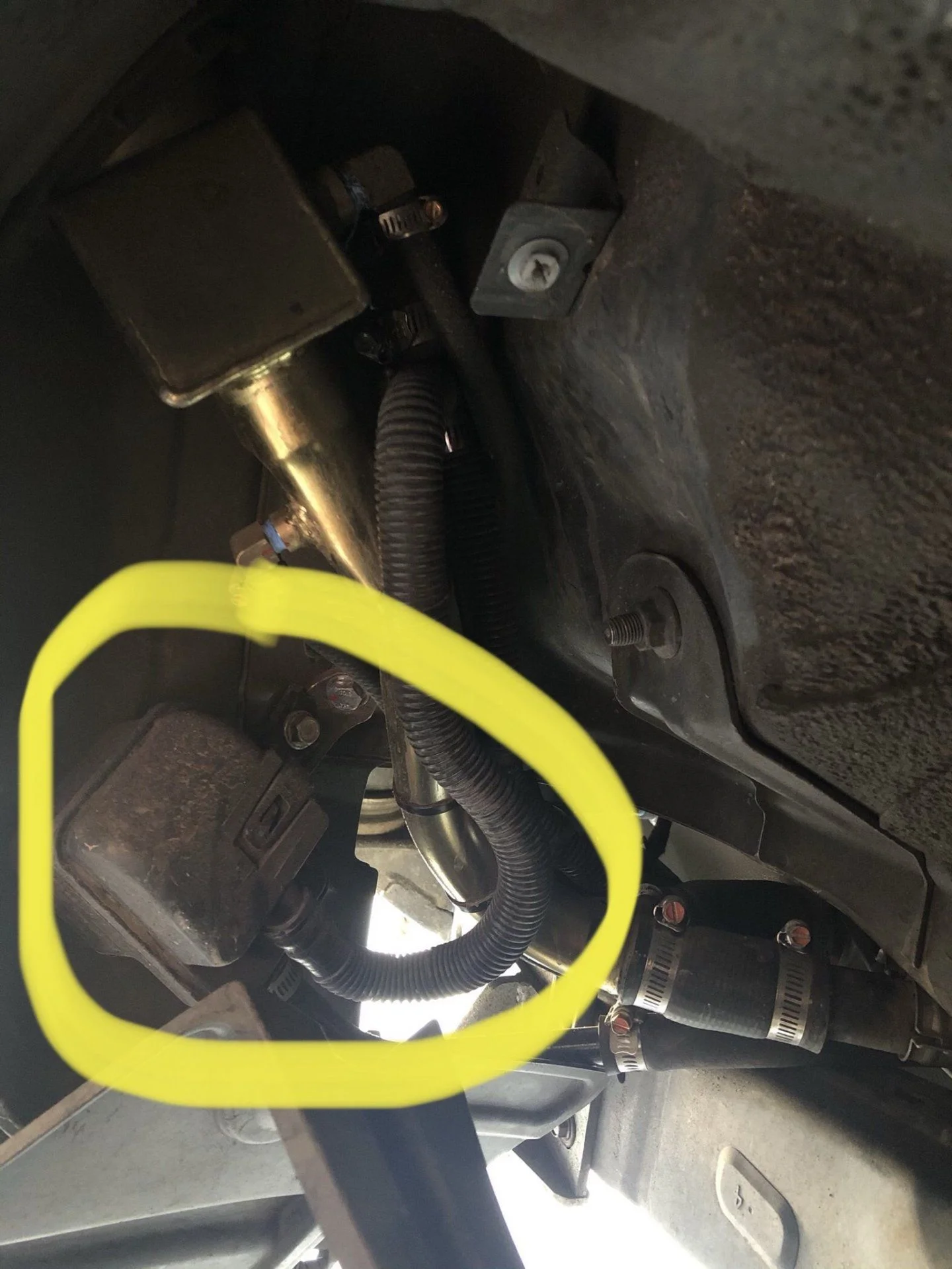

Can you fine gentlemen confirm if this was part of your install?
is this a new part on the 2016+ cruisers?? There have been quite a few small updates even after 2016 that have not been advertised by toyota. Wonder if they have new checks / nannies on the fuel system to monitor for added tanks n such?? I am by no means an expert , just speculating I guess
