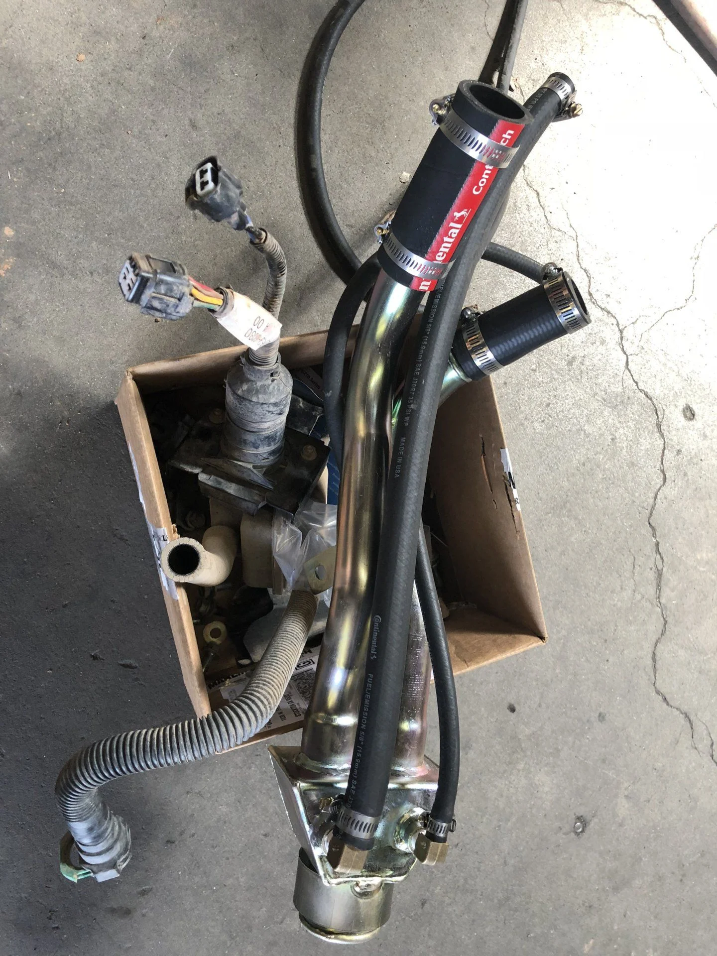

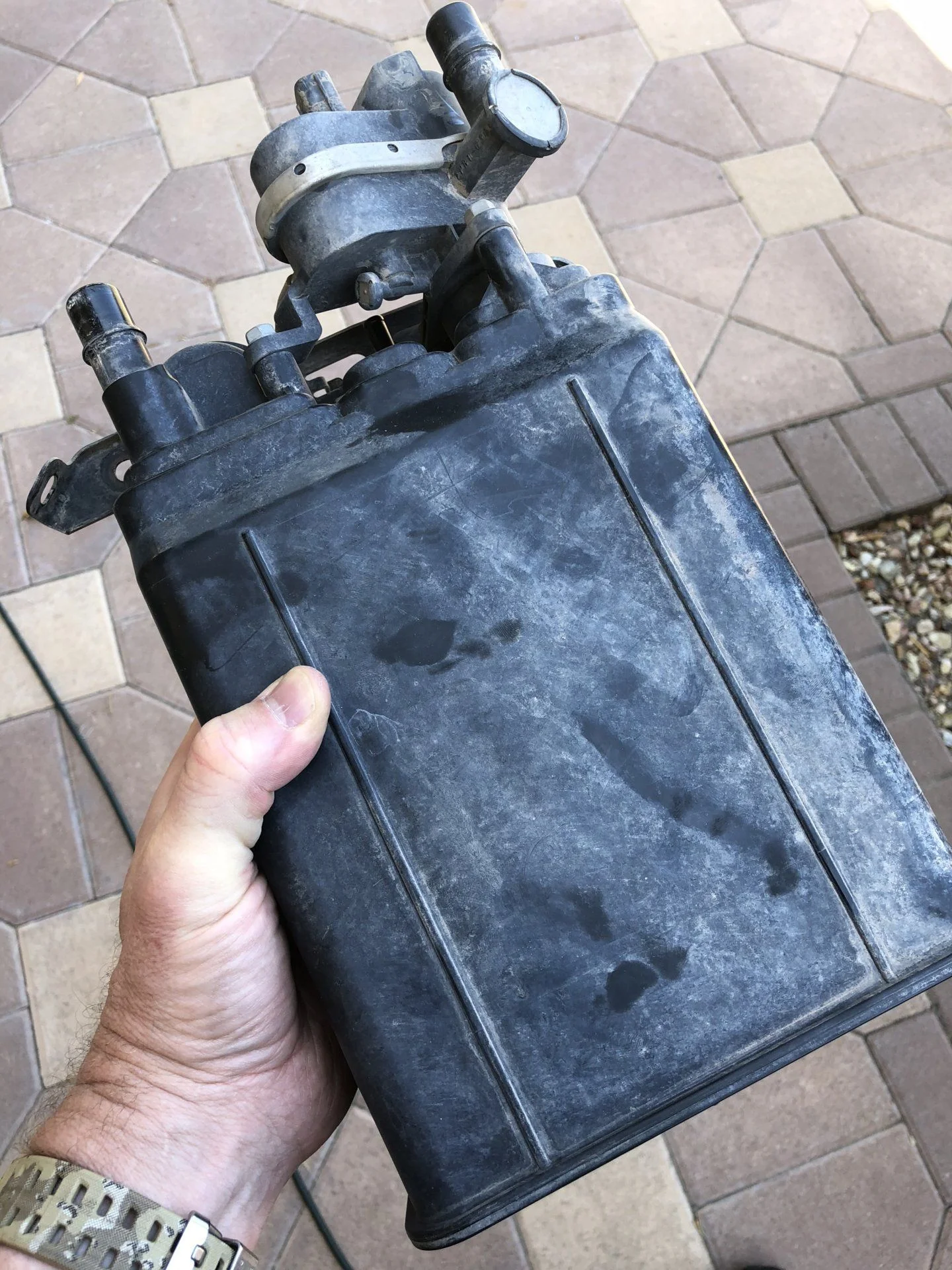

New charcoal canister and replaced fill tubes.
Sheesh. Finally!
Bad news is canister is EXPENSIVE...
But glad I can stop my routine with the code reader/reset. :hillbilly:

Fill tubs, are they for an auxiliary tank?
Yes indeed!
And I gotta say...this 24 gallon tank is really nicely tucked...and also up-armored.
It was now or never on the canister since getting to it now means tank removal...so I’m glad we were able to source it in time.

Mark, Kamal, were there any visible signs of cracks/failure points on the canisters?
or is it something internal?
Interesting. How is it that the evap codes started occurring? Seems to be several cars that have this problem?
Boiling gas in extreme heat and altitude in Moab. We believe it fouls the charcoal canister, but there may be more to it...such as a fuel filler hose that is not air tight.
