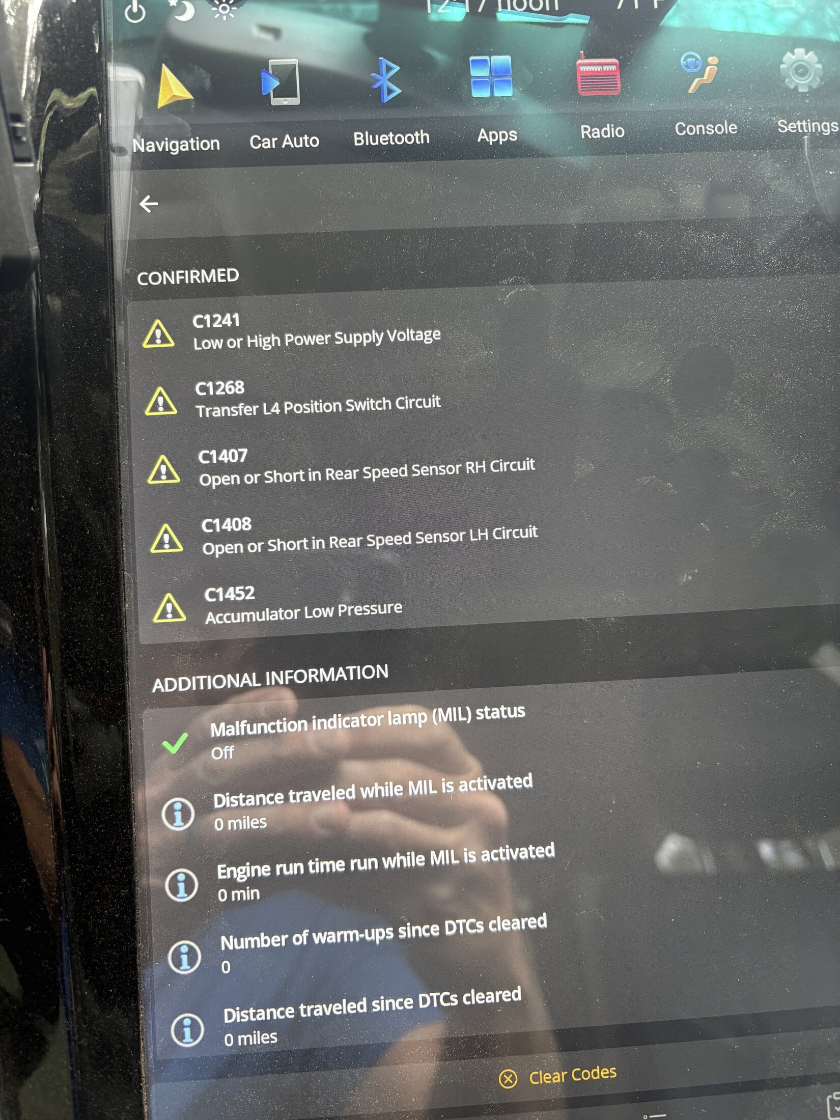

Just spent the week at COTR and the truck ran well. Started it up this morning and got a blinking center diff light and it would not go into 4lo. I scanned for codes and got some pending evap codes and cleared them but still blinking center diff. I sanded tranny related codes and got this:
I cleared these and am back to normal with no blinking light and can go to 4lo and lock/unlock center diff.
I’m just going to monitor it for now and Claire McGann if it happens during the rest of our trip. Anyone had these codes before? Anything I should be doing about them when I get back home?
Someone else our first day had the first two codes IIRC. Definitely the second “position” one. We cleared and I don’t think they came back for him. Silverton gremlins.
If it comes back I’d look at the connectors and the ground strap, and then start looking those codes up in the FSM to see the descriptions and if there might be a correlation.
I’m not sure what the last one about accumulator pressure means on an LC?!?
