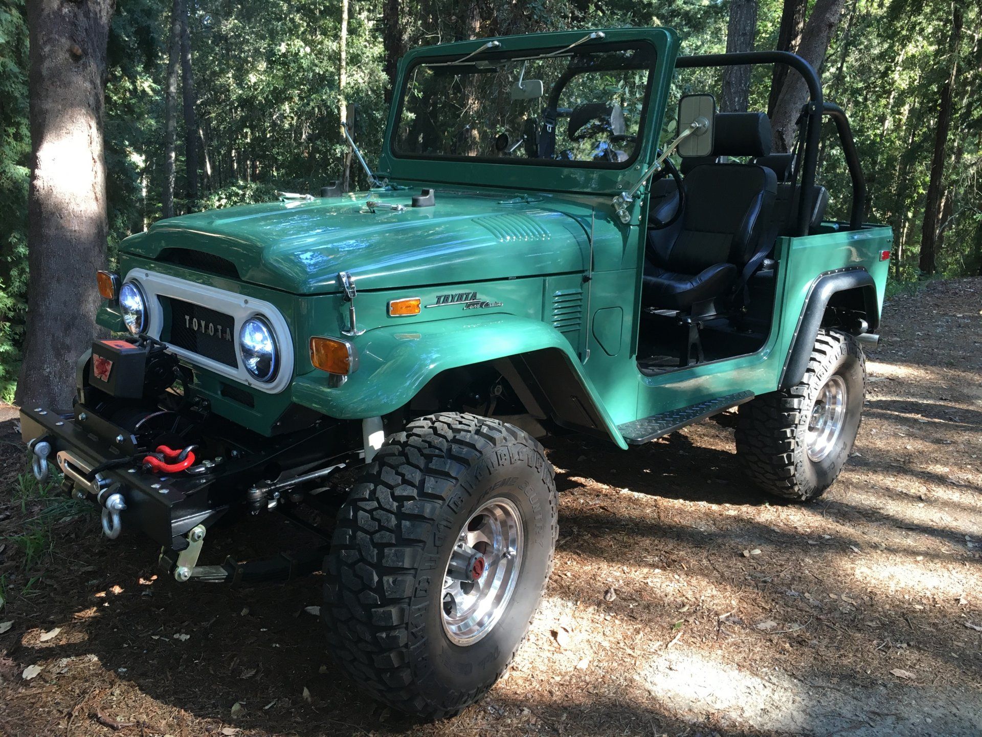

Here is what I did.
1. Apply epoxy primer over clean bare metal. (Media blasted)
2. Apply filler where needed within the working window of the epoxy you use. You can also shoot a primer surfacer over the epoxy also. You should plan this step out carefully or you will have to abrade surface again and reshoot epoxy if you miss the window 5-7 days depending on epoxy.
3. Block Sand block sand and block sand. USE A GUIDE COAT.
4. Seal with epoxy over all body work again with a thinned epoxy primer.
5. Shoot your topcoat writhin the working window of epoxy (without sanding) or wait till epoxy is fully cured and scuff with red scotch bright, clean and shoot top coat.
Hope this helps a bit
I by no means am a professional but this worked well for me. I'm still working on my hard top and doors. In fact I sprayed my sides today. Good luck to you.

Thanks! Your rig looks great by the way!
