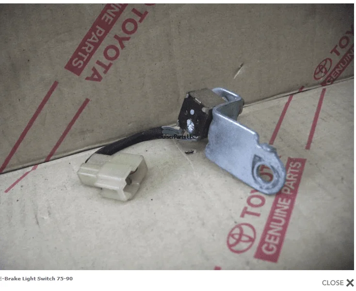

Maybe the switch is getting a little wonky or what ever part of the hand brake that pushes on the switch plunger needs a little adjustment. The picture I got from cruiserparts.net. They show the same switch from 1970 to 1990. If the bracket is used on FJ60, it might need a little tweak.

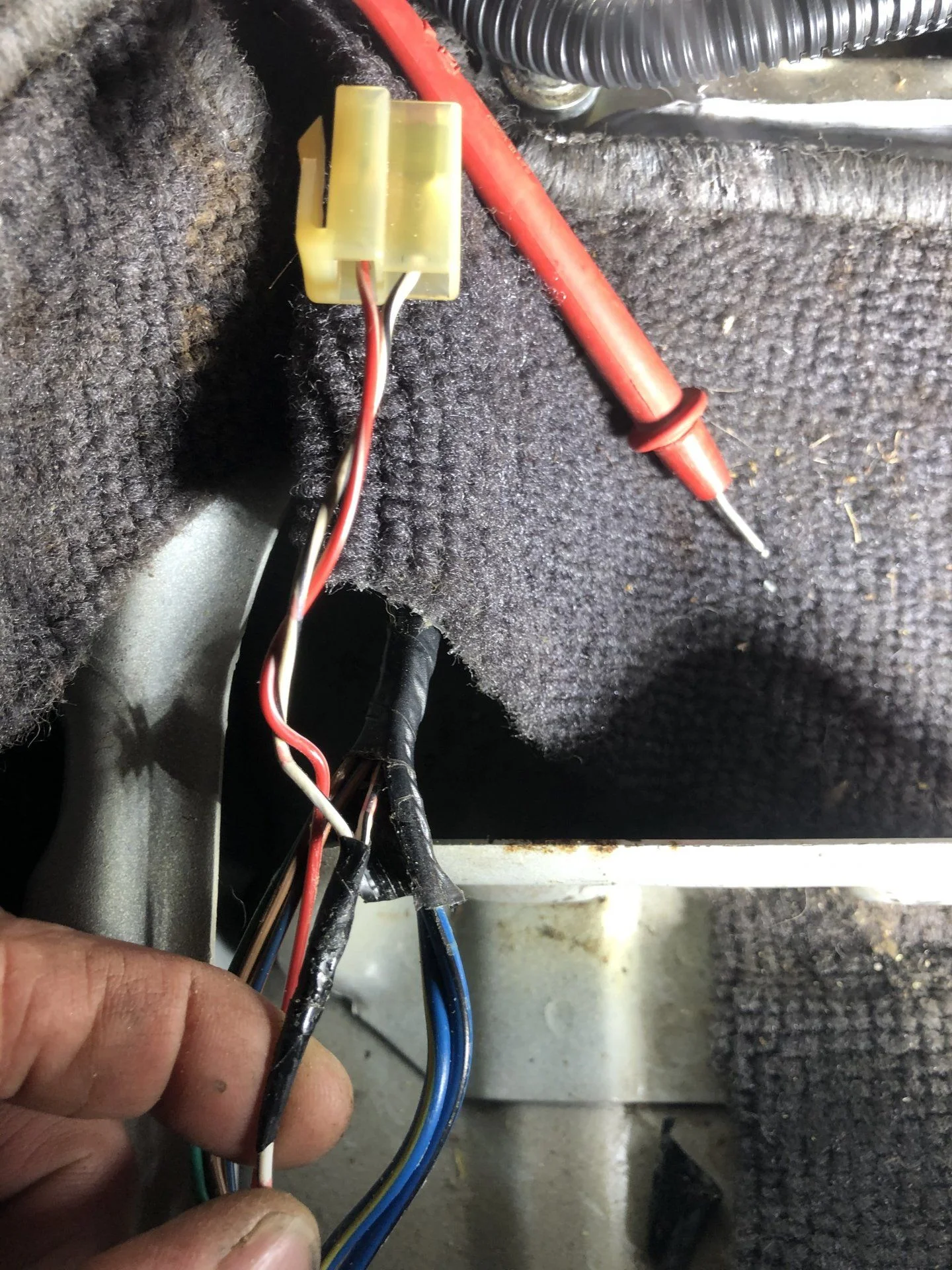

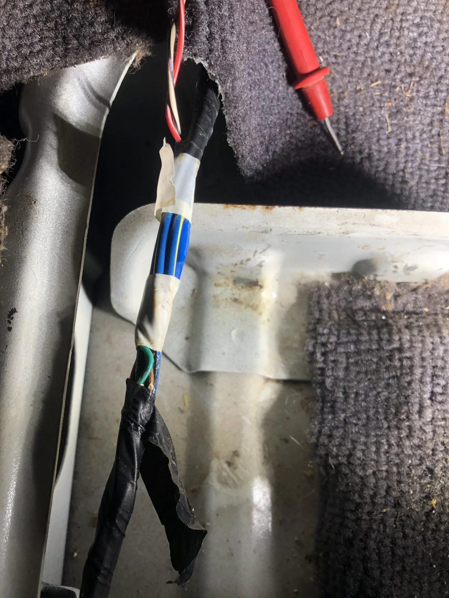

Testing with my ohm meter. Testing only the switch and it’s got continuity when parking park switch is on and no continuity when brake is off. Switch is functioning. Checked the other side of harness and have continuity. Removed the gauge cluster and disconnect the wiring harness. No continuity. Check each wire terminal at harness to eBrake switch. No continuity to ground on red w/ yellow tracer wire but have continuity to ground on the white with black tracer. Plug harness back together behind gauge cluster. Wires have continuity with each other and both with ground.
Removed the drivers seat to start inspecting wiring.
Found this area that looked suspect.
The white w/ black tracer is connected to two wires going toward the passenger side.
I’m wondering if this is the negative and does the eBrake switch ground the BRAKE light circuit?
E-brake is a GROUND SIDE Switched Circuit in a fj60
Thanks for the response. So what I’m wondering is why the BRAKE light is staying on with the harness to the eBrake switch disconnected. Under my seat as seen in my pictures above I have the ground from eBrake harness and a splice with a white w/ black tracer from the passenger side. I have not blown any fuses. Power somewhere after the BRAKE light must be grounding. I have the brake fluid switch removed and has been so for years now, no issue.
