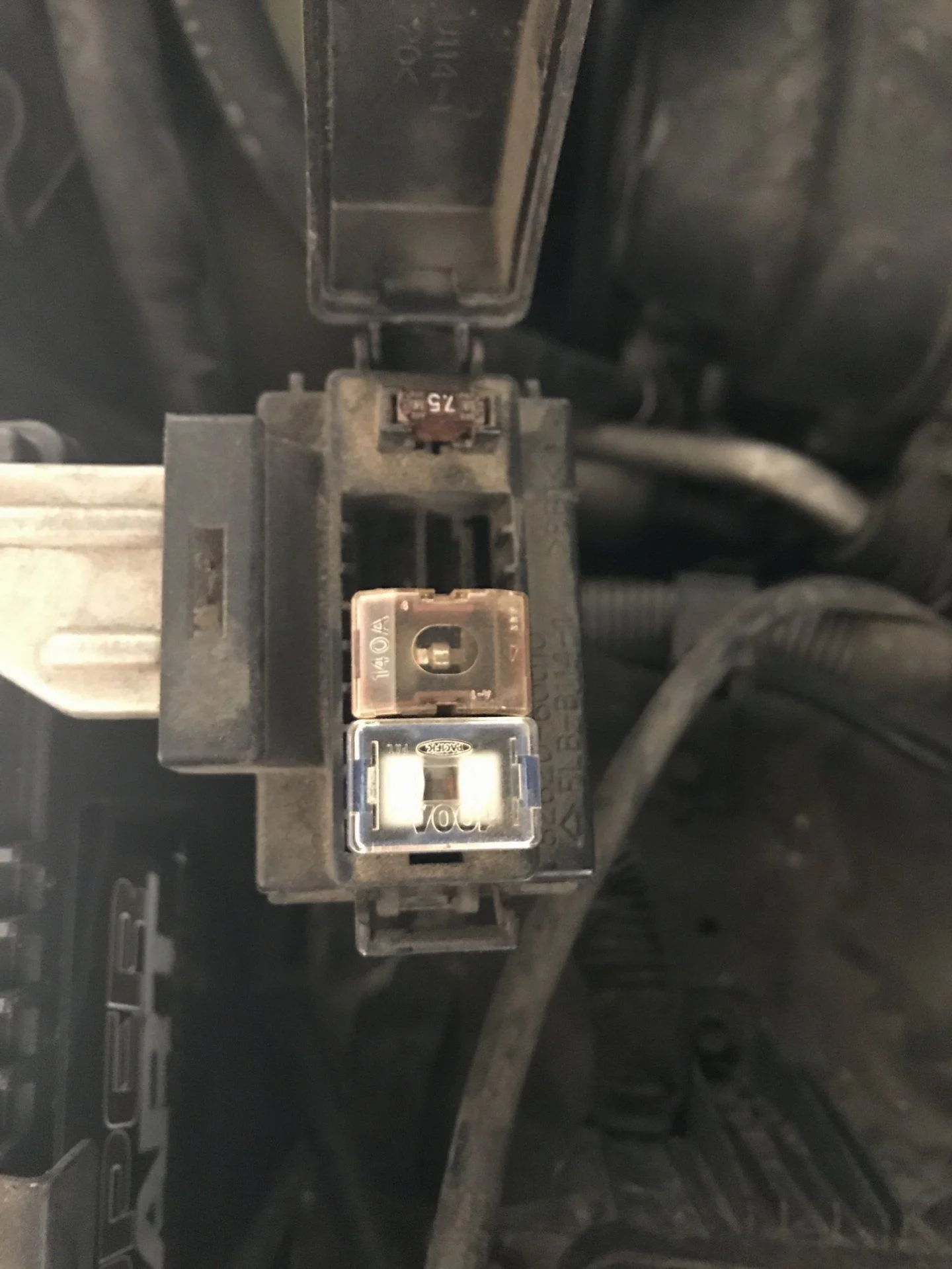

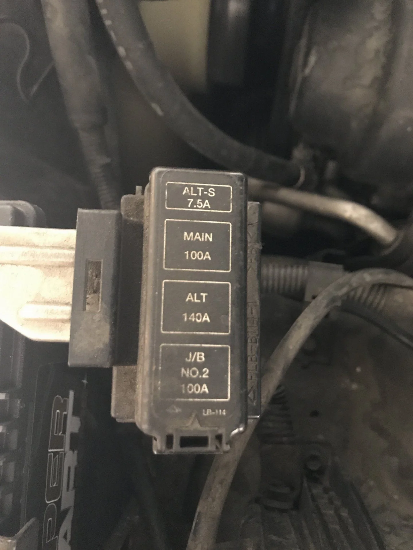

Cleaned battery terms and bought multimeter. Getting 13.42 while running with ac, lights, and radio off. 12.7 and dropping with everything on. Thoughts?
Does it matter that I'm missing one of these fuses? Now down to 12.3 after running for a few with everything on.
Check your various cables, even if your terminal / lugs are now clean. The copper wire could be corroded. I've been replacing the ground wiring with tinned marine cable and new lugs as part of the "big 3" upgrade.
Also did you clean the main alternator lugged cable before attaching it to the replacement alternator? I would also clean your alternator plug with some contact cleaner, it's possible the alternator sense connection is poor.
