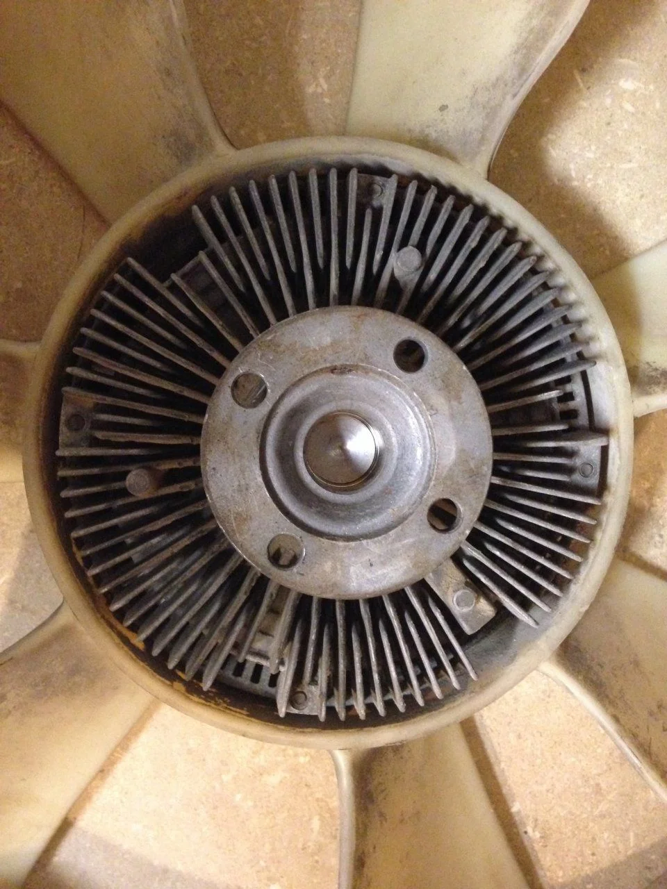

Doing some searches, it appears people like the Eaton better, but only because the Aisin is inconsistently calibrated? I think I have the Eaton. Could someone verify? Thanks!
Yes, it's an Eaton.
Thanks! This was a surprise to me. First time I've seen a stock Toyota one not be an Aisin.
