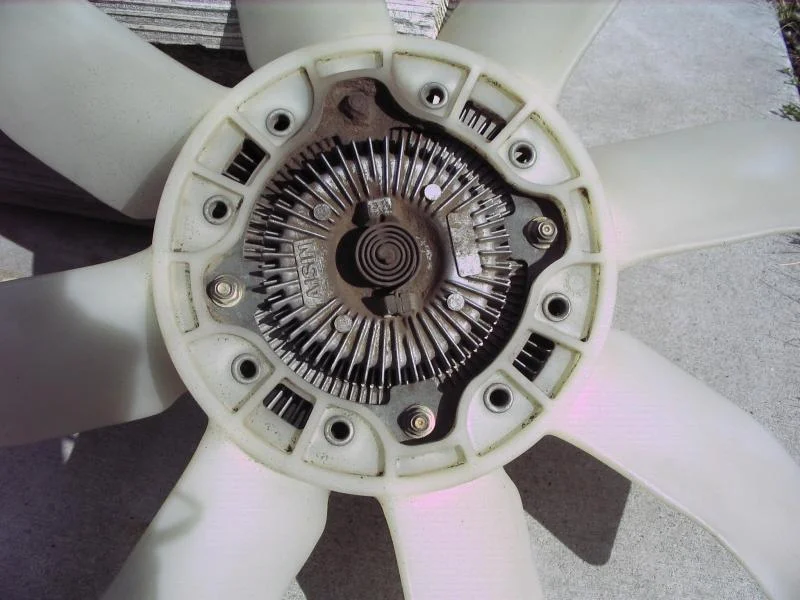

I pulled my fan clutch to verify the type and condition due to my '94's mileage and also recent cooling system work that I've been doing. I've included a couple of pics. I started brushing off the dirt around the thermostat/spring and than thought, maybe before cleaning it up, I should ask about what looks to me to be a possible leak of fluid starting. The top-most fan mounting screw in the pics has an accumulation of greasy dirt. Is this an indication of a leak starting? The bearing appears to still be in excellent shape, at least by feel. I'm going to continue cleaning it up and remove the fan. I can include more pics if needed. Thanks for any light you can shed on this!
In cleanup and after fan removal, several Phillips head screws appeared to have small amounts of greasy dust on them. Not a whole lot and it easily cleaned up with an old tooth brush. I'm pretty much decided to crack the clutch open and replace the fluid. I'm going to try the 10k due to the climate here and research I've done. I've heard that over filling would cause constant lock up. How much fluid should I be putting in?
From what I can see, wouldn't worry about that seepage, they almost always seep a bit around the spring. As long as it's not getting goo all over the fan blades, I run them. My normal fill for these is ~50ml, adjusted for how well it was drained.

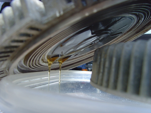

I found my old clutch so I decided to open it. It doesn't say AISIN or anything Toyota. No markings on the outside of any kind. It was held together by 4 torx m25 bolts.
Is this one worth keeping or should I mess with the blue clutch instead?
to open the front half slots, twist the coil
all the fluid came out of here, poured out pretty quickly
the orangey fluid is what came out of the front half, the little dab i'm pointing to is what came out of the back half.
I have 10K and 7K fluid. I think I'll try the 10K and see what happens.
Is the fluid orange from old age/breakdown or is that just the color it came?
I don't know if it broke down, the viscosity seems similar to the 7k fluid but that's just looking and seeing how fast it runs down the bowl.
