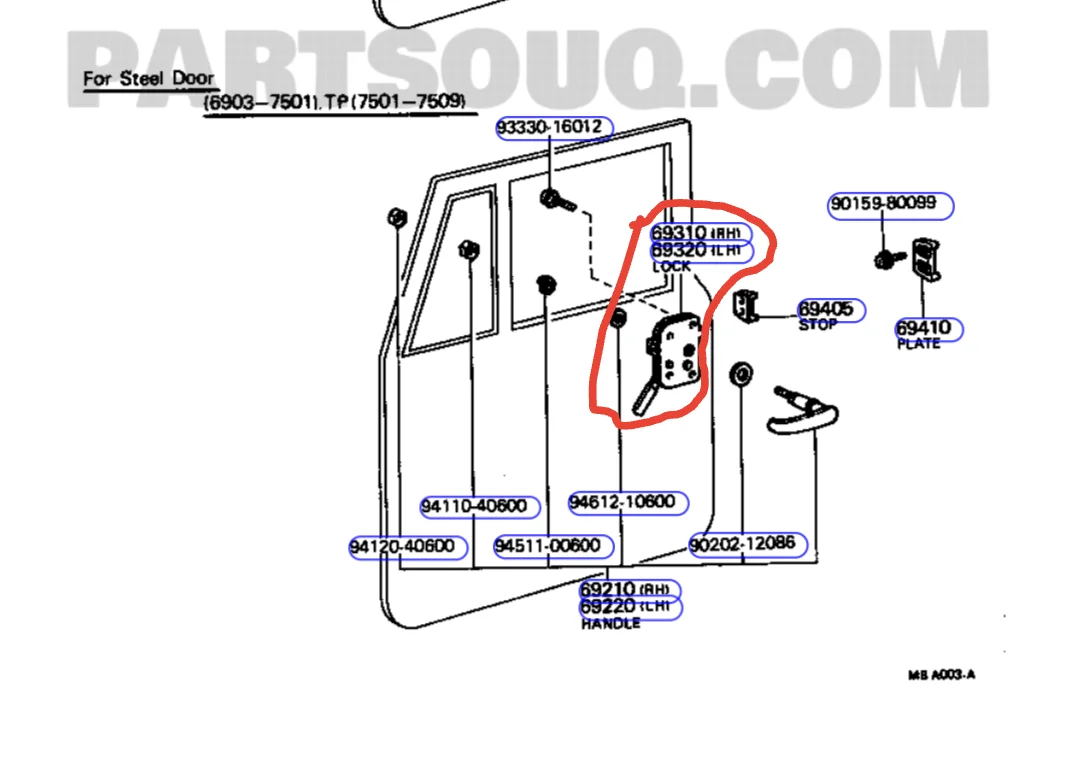

I've spent much of my summer chasing down the little rattles and other noises that seem to vex me during my drives.
2 Sources of rattles seem to be my inner door handles. Looking around it appears that the LH door handle is dc'd, and RH is available at the usual sources. I've also seen the Thai after market ones...anyone have any luck with the aftermarket handles or better yet have an OEM they want to part with?
LH - 6932060031
RH - 6931060031
Has anyone had to replace these recently? What did you go with and are you pleased with the result?

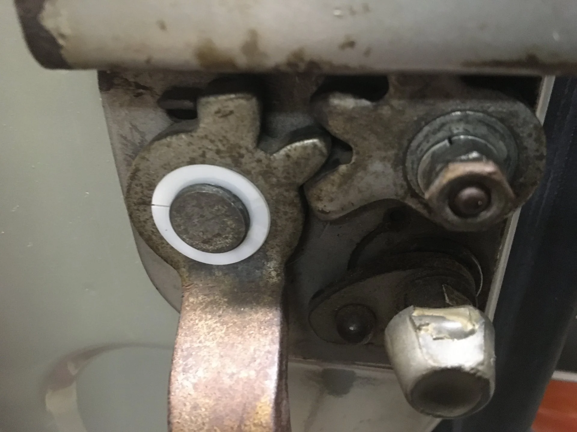

I rebuilt mine. Worked a charm. Cost me a couple dollars in spray paint, some bolts, shrink wrap for the plastic handles and some elbow grease. Blasted and sprayed with the Hammerite Rustoleum that looks very close to the silver metallic Toyota used for the pocket, seat backs, etc.
I bet the plastic handles could be 3D printed foe cheap cheap.
I just used a c-clip from the hardware store to eliminate the slack and rattle on the interior handle. :meh:
A split nylon washer or two work great as well for rattles. Absolutely does not help the missing plastic handle.
I hadn't thought about the washers or c-clips.
Did your handle have any play in the tongue of the assembly? Mine seems to have play there as well as the handles.
The gear teeth are worn on mine. Only one side has OEM replacement left. Think that is an ambulance door part. Other side is NLA.
