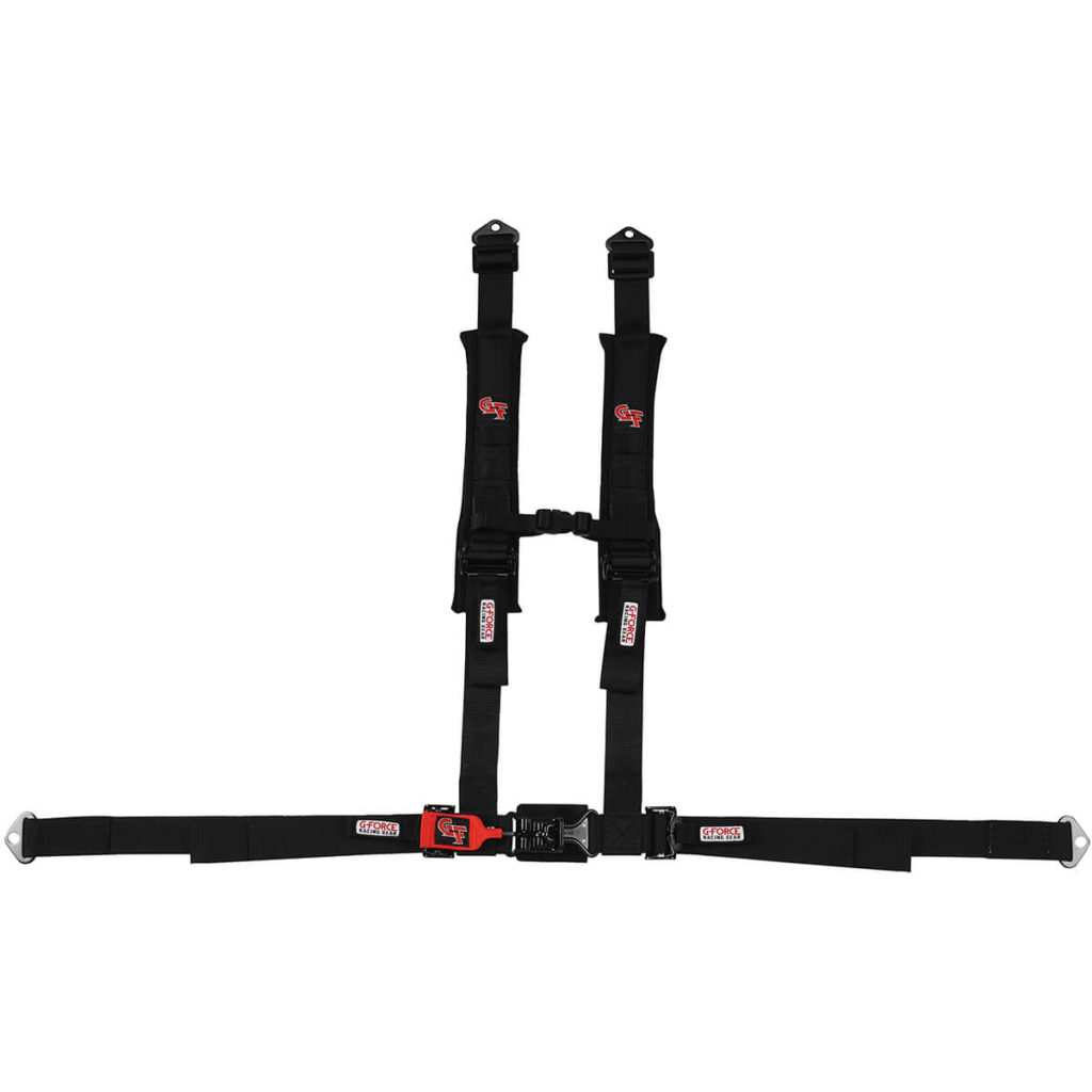

Does anybody have experience with the harnesses and recreational wheeling? Should I just stick to lap belts or upgrade to a 3 point? I don't plan on getting too crazy wheeling with this cruiser as I don't want to be driving a raisin, but there are some obstacles and lines on local trails where it would be nice to be more secure.
I ran a 5pt harness for years on my street/trail rig. Its super easy to slip the shoulder belts off to reach for something or move around. Definitely more work to get strapped in though.
I recently switched to a 4pt with one buckle, similar to this, and its much more convenient than a true 5pt race harness.
