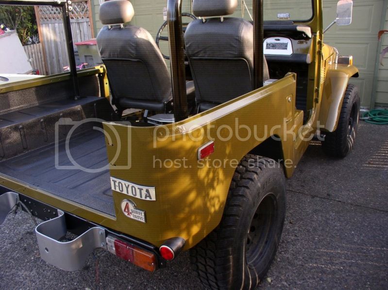

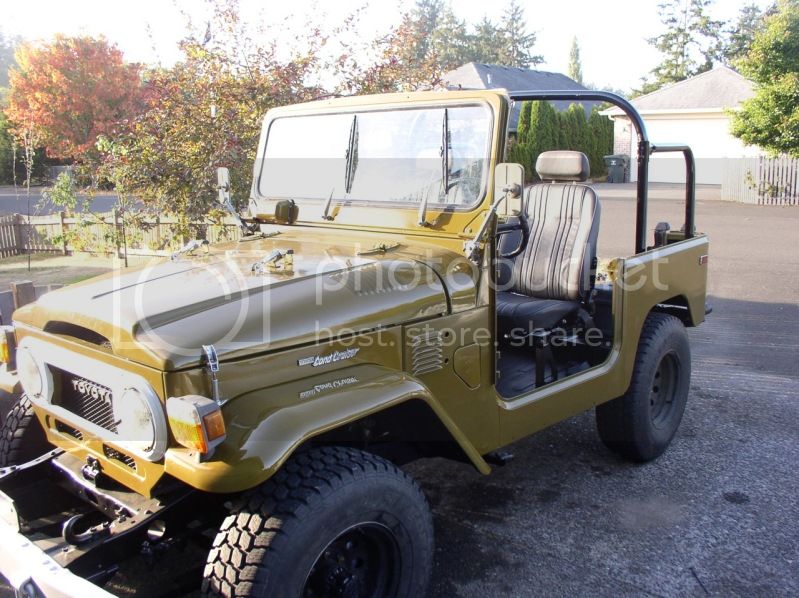

Still working through tons of loose ends but here are a couple pics just for fun:

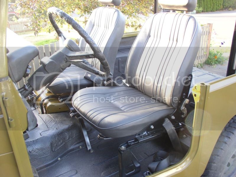

Cruiser Corps seat covers--the most expensive single item of the entire project. $299 well spent.
Home made quarters installed:
Thanks for looking. :steer:

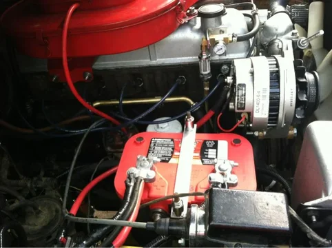

I drove the truck to work today. Knowing I wouldn't be home until dark, I spent a little time this morning making sure all the lights would be working and wired up the license plate lights in a temporary fashion. The ride down went off without a hitch. Bluebird day--cold, crisp, beautiful.
On the way home it was running well but when I switched the wipers on to clear some drizzle off the windshield, they blades barely moved and it instantly set in that I was barely going to make it home. Barely did, with dim lights and not enough power to run the blinker relay. Pulled into the garage and shut the engine off. Tried to restart but it was dead.
Classic charging system problem. The ammeter is reading way low.
Tomorrow it gets a new alternator and voltage regulator. Any suggestions on which to try first?
check the wires and connections off the alternator...including the wires in harness on fender...i had a recent issue just as you say...it was a corroded connection on connector against the fender...cleaned it up and good to go
X2 I would check all related connections first, and most auto parts stores can bench test alternators, no need to just "throw" Money at it,
I had the same problem last winter, it turned out to be a broken wire at the harness plug off the alt, unfortunately it took out my battery too,
In my opinion if u have any other non stock electrical components ie( winch, lights, amps) the 45 amp stock alt is just too weak, after my charging problems I upgrades to a 140 amp alt beefed up my wires and got a red top battery and haven't had a problem since!!
Don't worry, that's not an option, ha, ha.
Thank you gentlemen. I have backups on these parts so switching them out was the quick and easy way to diagnose by elimination. The results are in: both alternator and voltage regulator replaced with no change at all. Not getting any power back to the battery, and none of the electrics are getting enough power to work properly.
The three wires going to the alternator have been changed, so I'll start unwrapping wiring now and see if I can find a bad connection.
I drive it to work one day and it's already sitting lifeless in the garage! Better figure this one out ASAP.
EDIT: it was a loose connection at the fuse. Ammeter is pegged at 30+ trying to catch up. Hopefully the battery makes a full recovery and that's that.
Back on the road. Cheers, JD

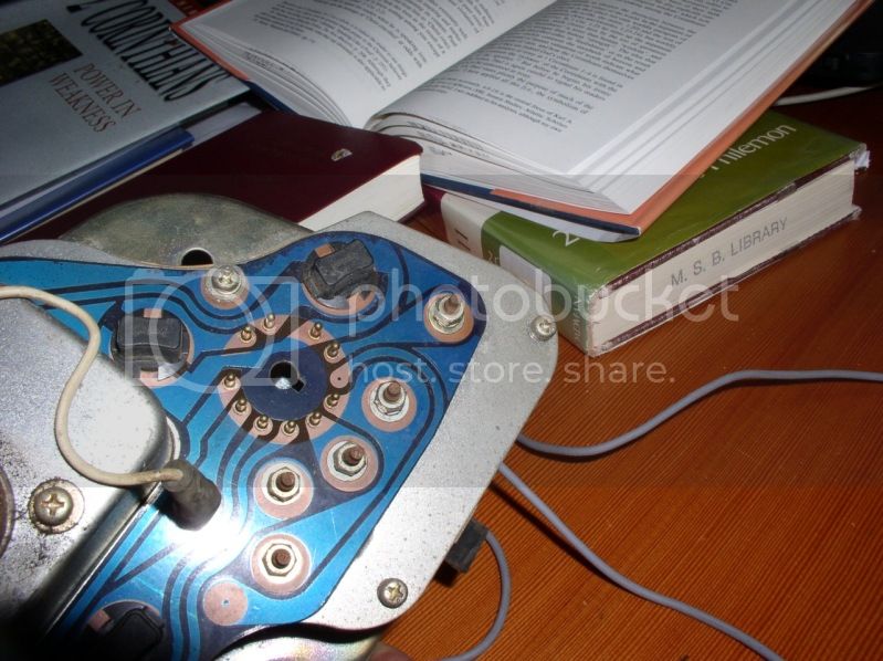

Here's a favorite: I have never registered oil pressure as long as I've owned this truck. I'm not insane, so while I did keep driving it, I kept the oil level up and removed the rocker cover multiple times to confirm that oil was getting up to the top (lots was). After a new sender made no difference I opened this thread:
https://forum.ih8mud.com/40-55-seri...e-new-sender-no-oil-pressure.html#post7108830
My gauge passed the test in the Haynes manual so I figured this build was as good a time as any to swap my spare engine in and sort the low oil pressure issue out later. So I changed the engine.
New used engine: NO OIL PRESSURE. :doh:
I have a drawer full of old gauge clusters so I finally dragged one out and plugged it in, and wouldn't you know it--bad gauge that tests fine. :hhmm: Just to be sure, I tried a third gauge and it registered exactly the same as the second. Bingo.
Learned in the process that it is actually easier to change the gauge than it is to change the engine:
You need a crescent wrench:
And ten minutes:
