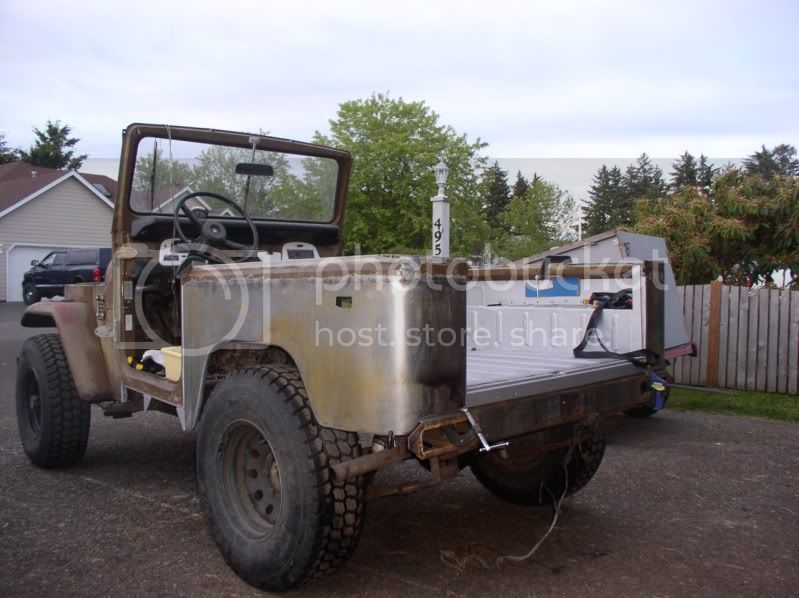

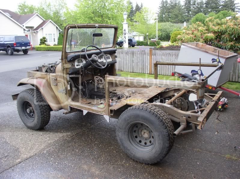

Pic taken ten minutes ago:
:hhmm: Well, it's worth a try.
The disassembly is the hardest part right? Now all I have to do is weld the tub up and paint it. :rolleyes:
Joking aside, I'm hoping to have everything but the top and doors back on the road in about two weeks. Failure is an option. :cheers:
Edit at 2 weeks 6 days: 'Failure was inevitable.' At any rate, this is a high speed refresh. Enjoy.
Edit at three months: Changed the title to save face. Ha, ha. Went a different direction with this build including pulling the tub off, sandblasting, swapping the engine, etc.

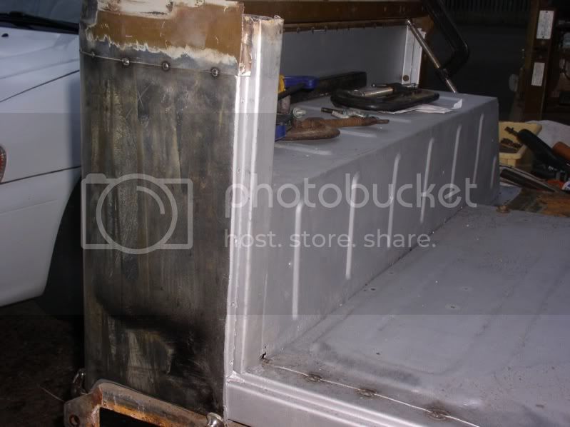

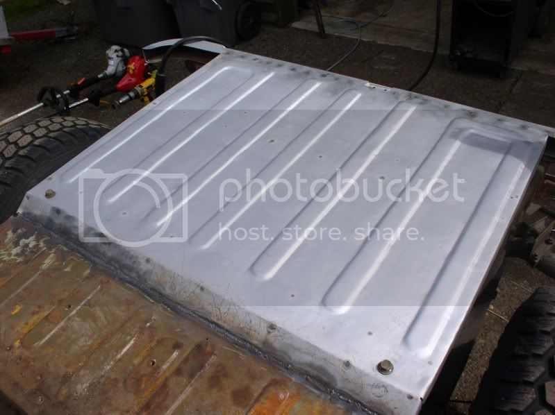

Well, I'm not sure where I would have to be in order to be 'on schedule,' but things are moving along. Yesterday I got a couple hours of fitment/fiddling in after church and then spent the rest of the day out hiking with the fam.

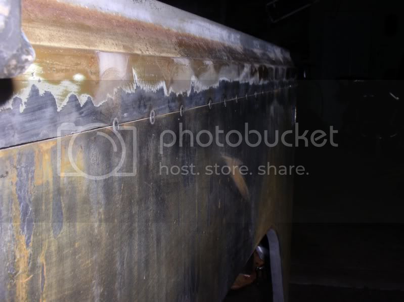

Today I got a few very productive hours in after work and before milking the goats, etc. The quarters are tacked in now and they lined up nicely. They're my first attempt at fabrication and you can read about that process in the thread linked above.
I was extremely careful to get the metal flush-flush-flush on the outside. It was slow around the rear corner radius.
It's so gratifying to see this straight panel after living with what it's replacing for a couple years.

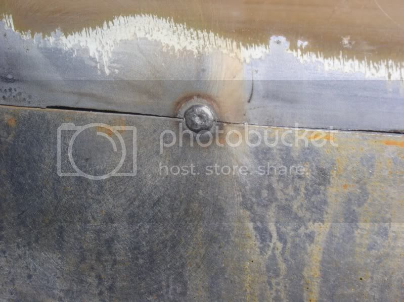

I'm forced (economically) to do my welding with flux core wire. Thank goodness it's 16 gauge!

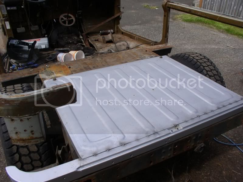

I'm hoping to have the welding and grinding on the 1/2 tub portion by Wednesday. Still hoping to have it on the road the Saturday after next. Very Best, JD
Those welds are sick for flux core. I see no splatter. What welder are you using??
Thank you; they are much improved. The welds in the pics have been lightly wire brushed, but there is some slag and splatter before cleaning of course. I'm using an older Napa 135 set up with reversed polarity and Lincoln Innershield .030 NR211 wire. My welder is set up for gas, but I'm just not at a place to buy into the bottle exchange right now.
I'll admit that my abilities and standards are much lower than others here, but I do think this is a reasonable system for the 16-18 gauge joints I'm doing.
