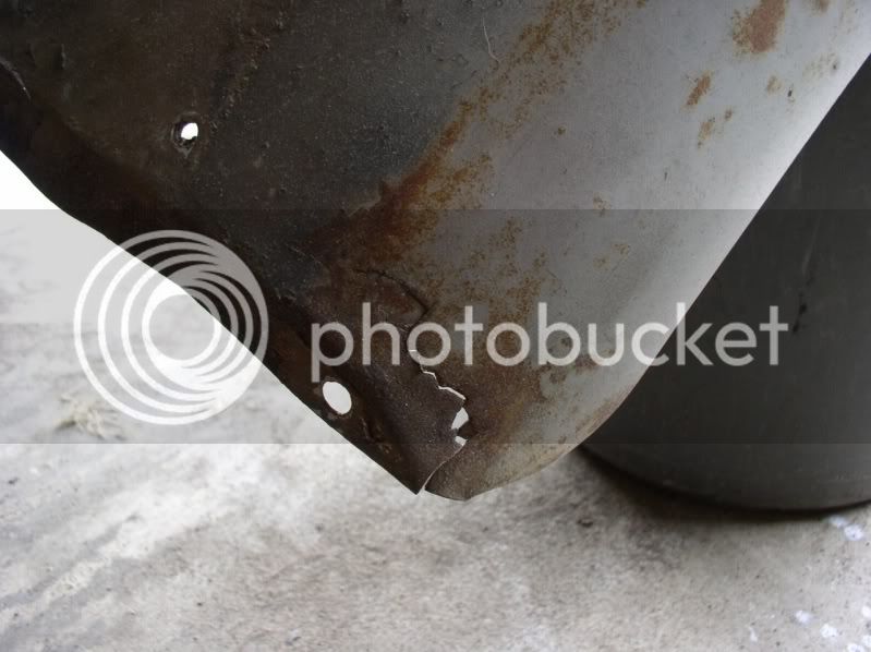

I've started the front fenders.

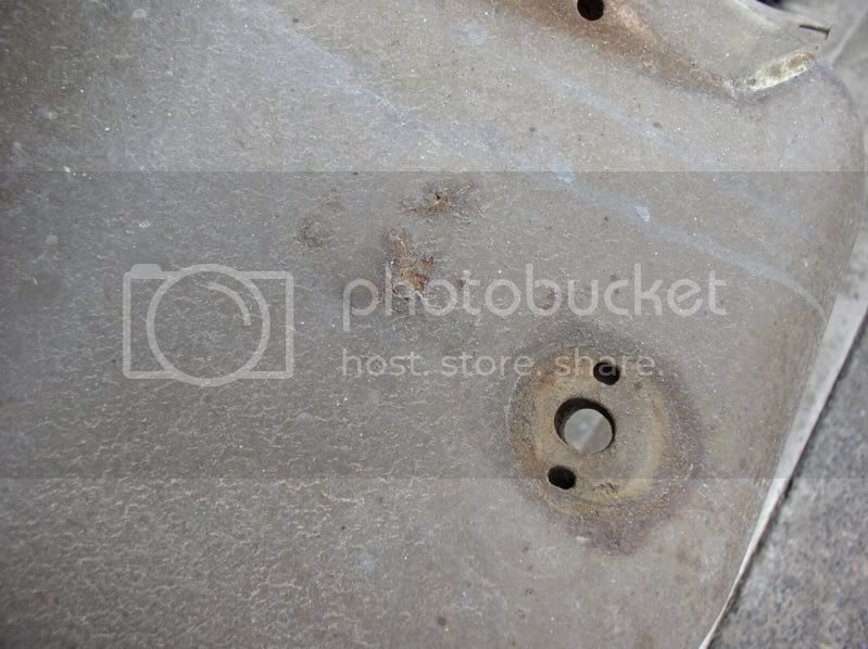

They have the typical rust bubbling through where the support for the turn signal is spot-welded on:
And some stress cracks and a couple rust-throughs where the fender supports terminate at the rolled edge of the fender itself.
I'm doing some rough wire wheeling with the grinder and then plan to get them really clean with the media. It looks like about 7-8 areas will need welding between the two but I don't think anything will need fabrication.

If there is an easy way to remove the factory paint on the cheap, I still haven't found it. Sanding is slow and doesn't reach recesses. The wire brush on the angle grinder is so loud I have to limit it to go easy on the neighbors. Stripper is fast but messy and always leaves stubborn stuff behind. Wet blasting is SOOOOO messy, takes a lot of sand, and it's miserable. I used every method today, and if nothing else, switching methods breaks the monotony. If I am missing the miracle process--please advise me.

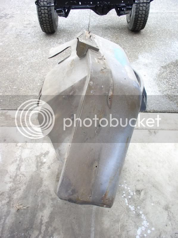

So, I've been hoping to really get my fenders squared away soon and decided to work on the whole front clip while I was at it. Removed the fender supports (drill out 9 spot welds--piece of cake) and the rustwich in the turn signal supports:

My tired factory paint responds well to stripper. This pic was taken after about 2 minutes:
http://i132.photobucket.com/albums/q35/duffontap/4-1.jpg
Where is doesn't work, is anywhere there is a little rust 'ant mine' under the paint. This front bib looked a little speckled but not really rusty, but look what was spreading under the paint (the rusty starbursts really spread out and this would have been a mess in a few years if I had just primed over this):
http://i132.photobucket.com/albums/q35/duffontap/why.jpg
Ended the day with the hood, both fenders, hood aprons and bib nearly bare and under diluted acid. I'm going to do the fine finish prep with the panels dry. I can get the little stuff with my $15 siphon blaster, and I've got a bunch of welding and hammering to do on those fenders before primer.

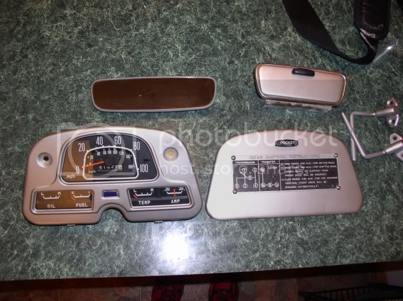

Small parts are accumulating in every corner of the house:

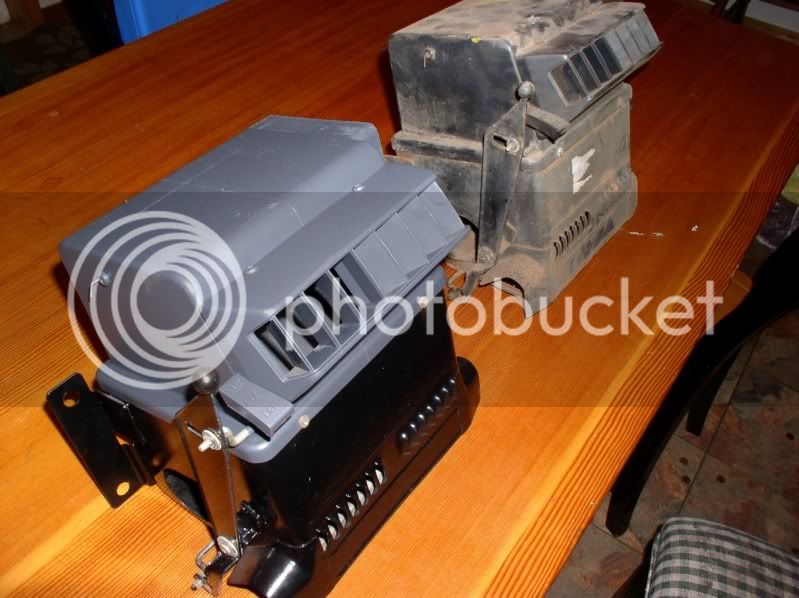

Surprising what a lick of paint will do (especially if you tear everything apart and bead blast it):

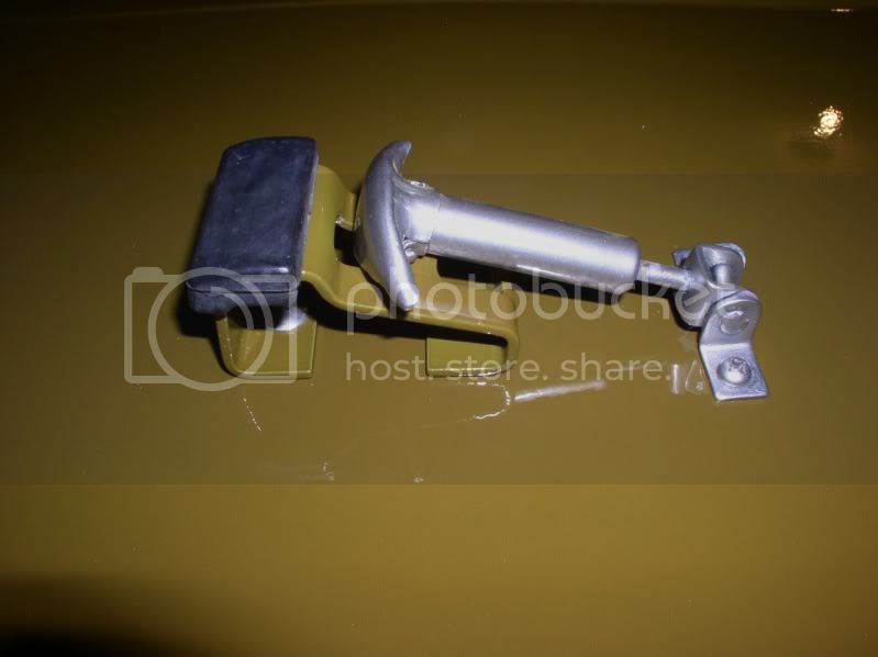

First time I've ever had a set of these: It's the little things in life. :bounce:

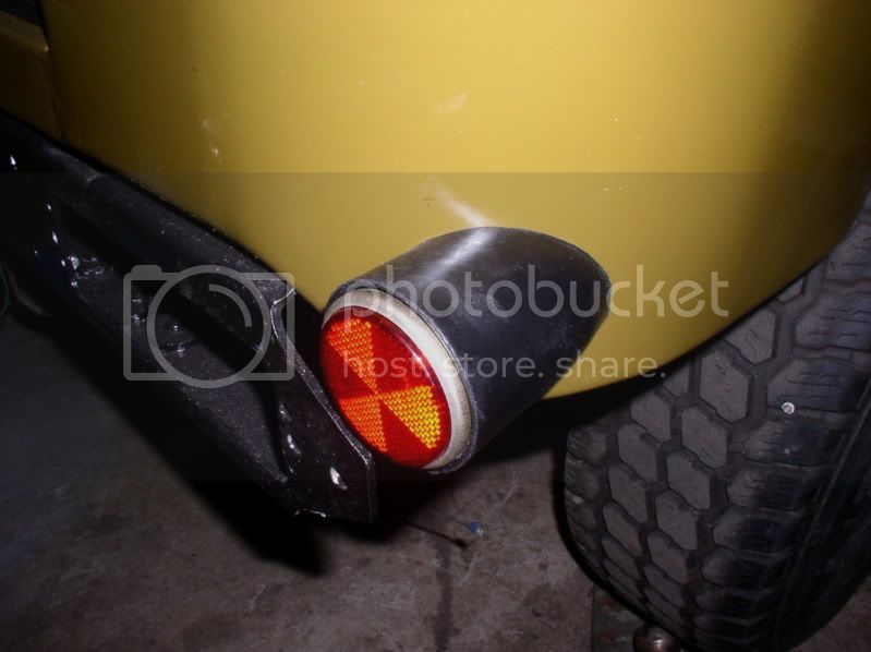

Thanks to FJsnoozer for the tip on the pewter rattle can paint. I like it--clear coated it all for a little extra life.

Looking great! Can you elaborate on the process, tools, chemicals you are using to clean all the interior parts?
Sent from my iPad using IH8MUD
Thanks ntsaint! Most of the interior parts pictured were 100% disassembled, then sand blasted with a $15 siphon feed unit and phosphoric acid etched before primer, paint, and clear.
