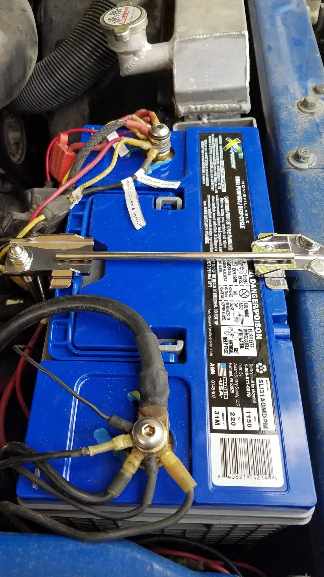

Id love to see group 31 installed, I cant fit mine under the hood. not securely at least
I had to cut the tray and order a new hold down... so it is secure....
Did away with the post. .
just need to clean up all them wires.... but I'll do that when i get back home. .. it clears the hood fine. .
This ous my aux battery btw......
View attachment 1635480 just need to clean up all them wires.... but I'll do that when i get back home. .. it clears the hood fine. .
where did you order hold down? and can you get a pic of whats UNDER that 31 series?? I may copy this install
