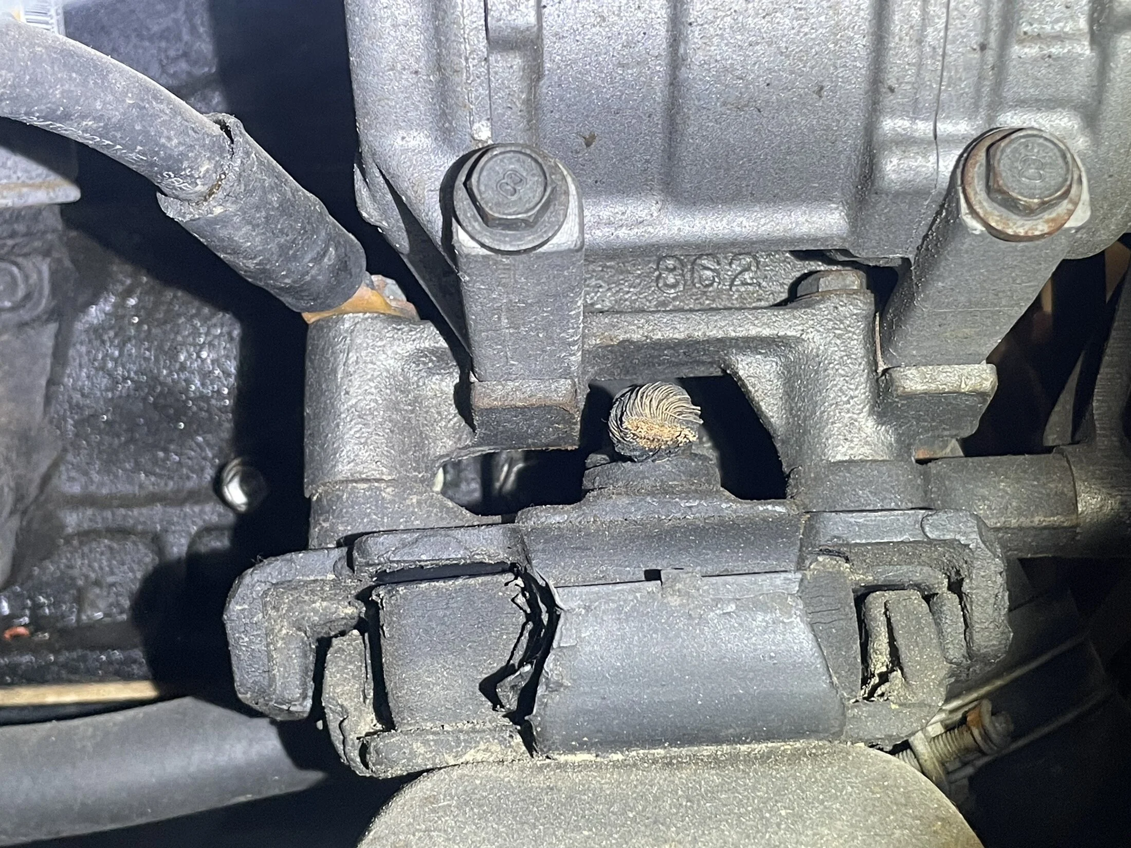

I am attempting to install Mark’s beefy battery cables on my 1988 FJ62. I am in conundrum on removing the negative battery cable as it attaches to the passenger side motor mount. The AC compressor is in the way. Is there even room to remove the bolt? Do I have to remove the AC compressor first?

I was just looking at this today as I have new engine mounts. I don’t really see how to get that cable out without removing the compressor. Which also requires removing the PS pump.

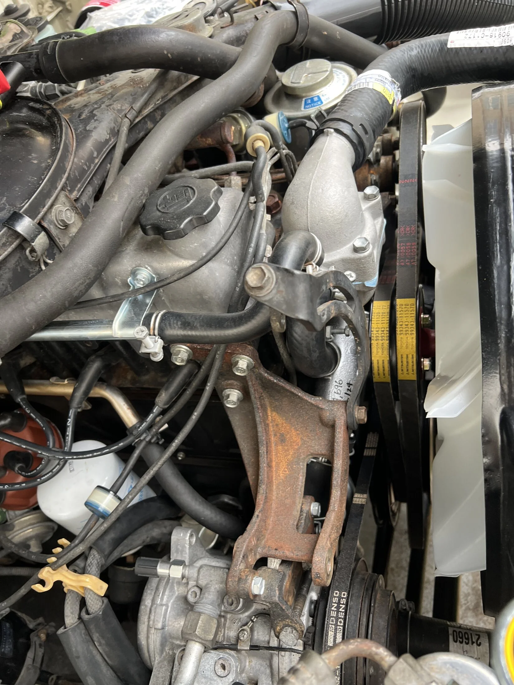

You should have room without pulling the compressor. Remove the alternator and bracket, the ac compressor can stay put. Here's some pics from when I replaced my battery negative cable
Thank you S.CarolinaFJ80, the photos help a lot! Now I just need some warmer weather, the cold makes my hands cramp up.

When I replaced all the grounds on my 62 with a heavier "custom" set many moons ago, I snipped off the original ground cable at the motor mount, and attached the new cable to one of the AC compressor bracket bolts.
This is the exact same thing I did even down to the spot. With several good points to attach around that area, it simply isn’t worth the effort involved in keeping in the stock location unless you really want to preserve originality or have a specific reason in mind.

That makes more sense and I don’t have to hide under a rock dreading the motor mount method. The old wire will get a snip and I can move on.

I just clipped and abandoned that terminal.
