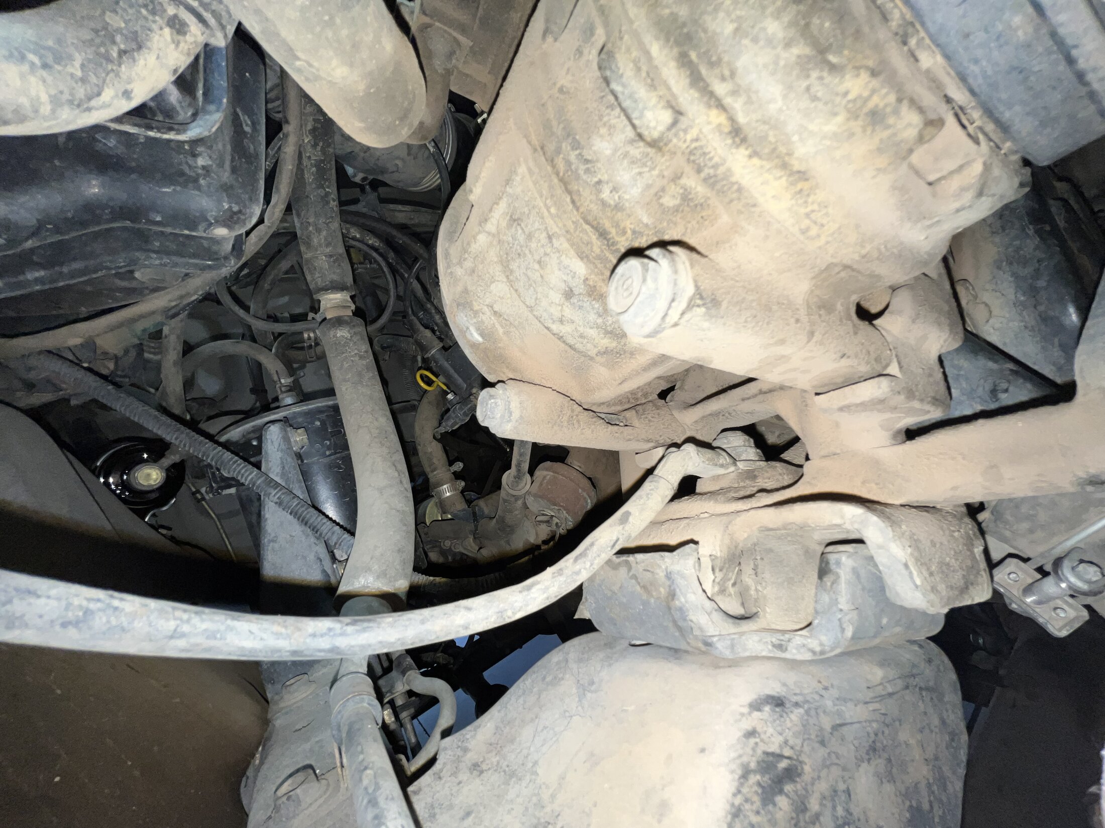

Fresh off the problem of removing/replacing my tranny and T/C fill bolts, now my latest headache is trying to remove my neg battery grounding bolt. I'm not talking about the smaller bolt very conveniently located on the passenger side wall. I'm referring to the longer battery cable that snakes down underneath the A/C compressor and is mounted to one of those bracket bolts. I'm having ongoing electrical issues and that grounding location is the last thing to check; I've already replaced everything else. But I can't get that <insert expletive here> bolt to come loose. I can get a 17mm wrench on it, but can't get the leverage to turn it. I don't have the vertical clearance to get a socket head+ratchet on there. Husband suggested something called a crow's foot, but they all seem to come with a 90deg attachment angle, and I don't have clearance for that arrangement either. Anyone have any tricks they can recommend? I'm already planning to relocate that cable to a different grounding location. Given that, I'm seriously thinking to just cut the old battery cable as close to the A/C compressor as possible, and buy in a nice new heavier gauge cable, to be grounded elsewhere. I don't like that "cut it and leave it" solution for a variety of reasons but I'm running out of ideas. Suggestions?
Tha cable is actually bolted to the engine mount. Even if you could break the nut loose, it’s likely you wouldn’t have clearance to remove it.
Your options as I see it are
1 remove the PS pump and compressor
2 cut and reroute the ground to another spot on the block
3 leave it and add an additional ground to the block.

Thanks all for the suggestions. I'm 90% of the way to just cutting that old negative cable and bringing in a new cable to a new ground location, but I wanted to eliminate some other possibilities first. So we spent some quality time yesterday and today testing various things, and found a few potential culprits. That negative cable is still Suspect #1. When I tested continuity between the negative ground and the other end of that grounding cable, I got really intermittent continuity readings on the multimeter. The cable is good and tight at both ends, but since I can't see the end under the A/C compressor, and I can't remove that bolt, I have no idea how corroded and/or gunked up it might be. But the wild swings I was getting on the continuity testing tells me that my ground is currently pretty poor.
