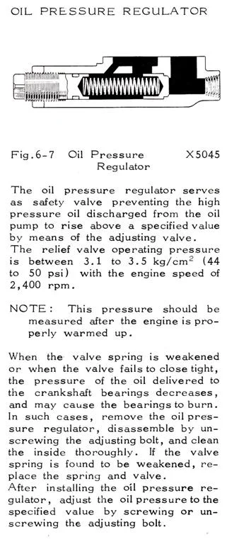

So here is the F motor. Correct me if I'm wrong here. Oil pressure builds in the pump which has an internal pressure relief valve that pours the excess back into the pan. Heading up the tube the passage splits, one way is the filter the other engine bearings. The filter canister fills from the side and the outlet is at the bottom. There is a tube running up the center of the canister that has a small hole a couple inches down, this is the return from the canister and it kind of hard to see but it pours directly back into the pan.

1) or if the filter plugs, yeah, you have no filter in the system.
2) Right
3) your figure doesn't really show how the oil pressure regulator works. Yes, if the line to the oil filter was cut I'm sure the pressure to the bearings would drop. I'm not sure how much difference the size of the filter tube hole would make; obviously the resistance in the filter system effects the overall pressure and therefore the pressure to the bearings.
That's something you could experiment with! :D
attachment.php
Here's the circuit diagram for the F engine. There are two points of resistance, obviously. The nice thing about the F is that you do have a mechanism for adjusting the oil pressure in the system if you need to do so.
Not saying that the F oiling system is superior to the F 1.5 or 2F, but that is an aspect that could, I suppose, come in handy at some point under specified conditions.
As far as I can tell from my F 1.5 engine, there's no oil pressure adjustment other than to change the filter, pump or bearings and to clean the passages.
By the way, unless the 2F is different from the F1.5, the oil pressure sender is rear driver's side low on the block, same as the F. Nowhere near the head.
