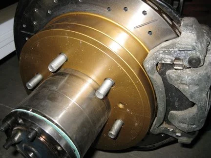

I spent about an hour searching, maybe my search skills are inadequate, but has any body done a rear disc conversion on a 40 using discs with a drum in them for the ebrake? I believe it would require going to 16" or 17" wheels but I don't know what else is involved. Neither of my trucks has provision for the tcase ebrake and the '83 has Monte Carlo rear discs and calipers, thus no ebrake.
never seen it on an FJ40 but on plenty of Ford junk and they had 15" wheels. Thinking about this it would space the rear wheels outward the thickness of the 'hat' on the rotor b/c that's where the drum e-brake is located so equally spacing on the front via wheel spacers would be needed.
