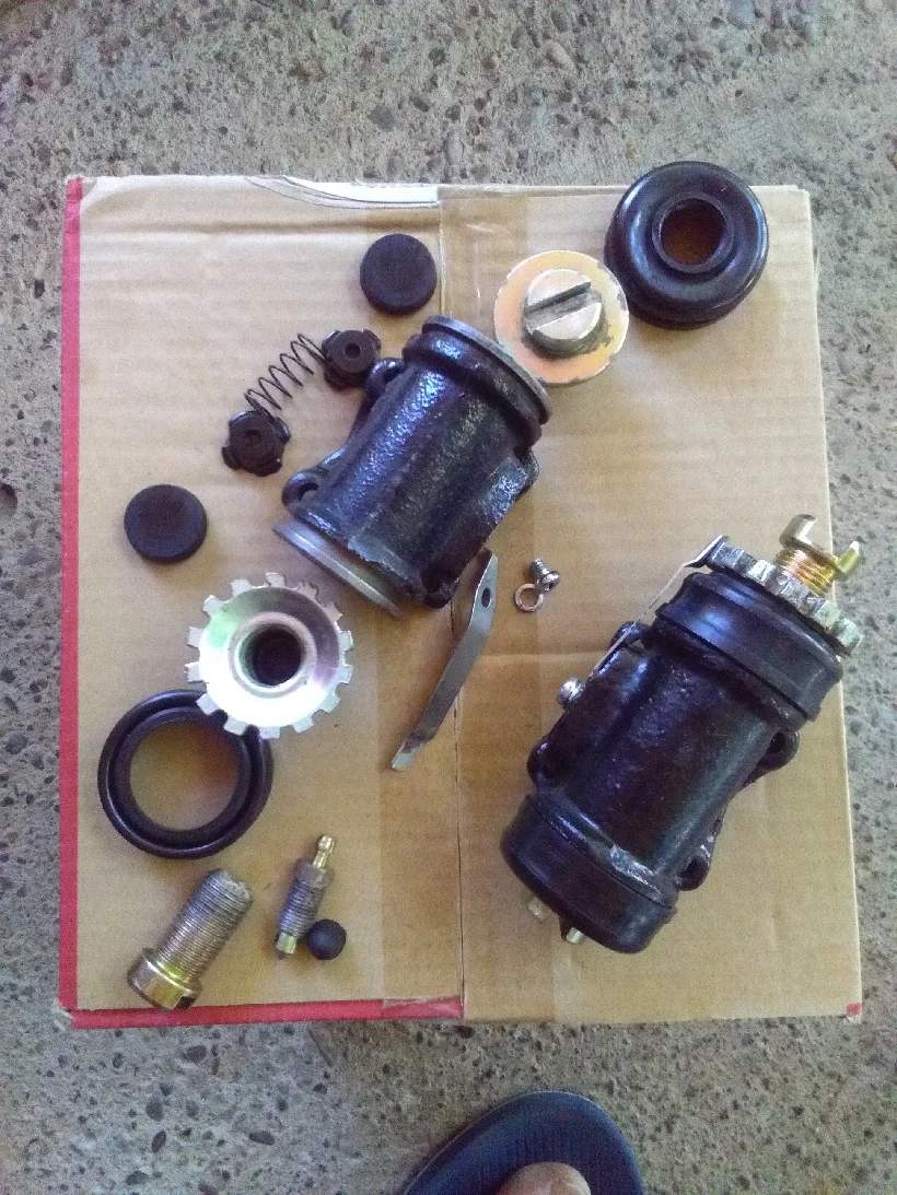

I know most people consider it a waste of time with how inexpensive new wheel cylinders are but, unless the brake system is funkruddy I try to rebuild them at least once before they get tossed. Rebuilding an hydraulic drum brake system from master cylinder back was one of the first skills I taught myself after I got the basics kind of figured out (oil/filter change, timing/plugs, valve adjustment, etc). I find it kind of relaxing because I don't have to be at the bench. Any shady spot around the yard will do.
Did these the other day. Passenger rears on my '78.
I'm mentioning this because it also tends to make me a little more focused rather than just slapping on a new part. Sometimes.
