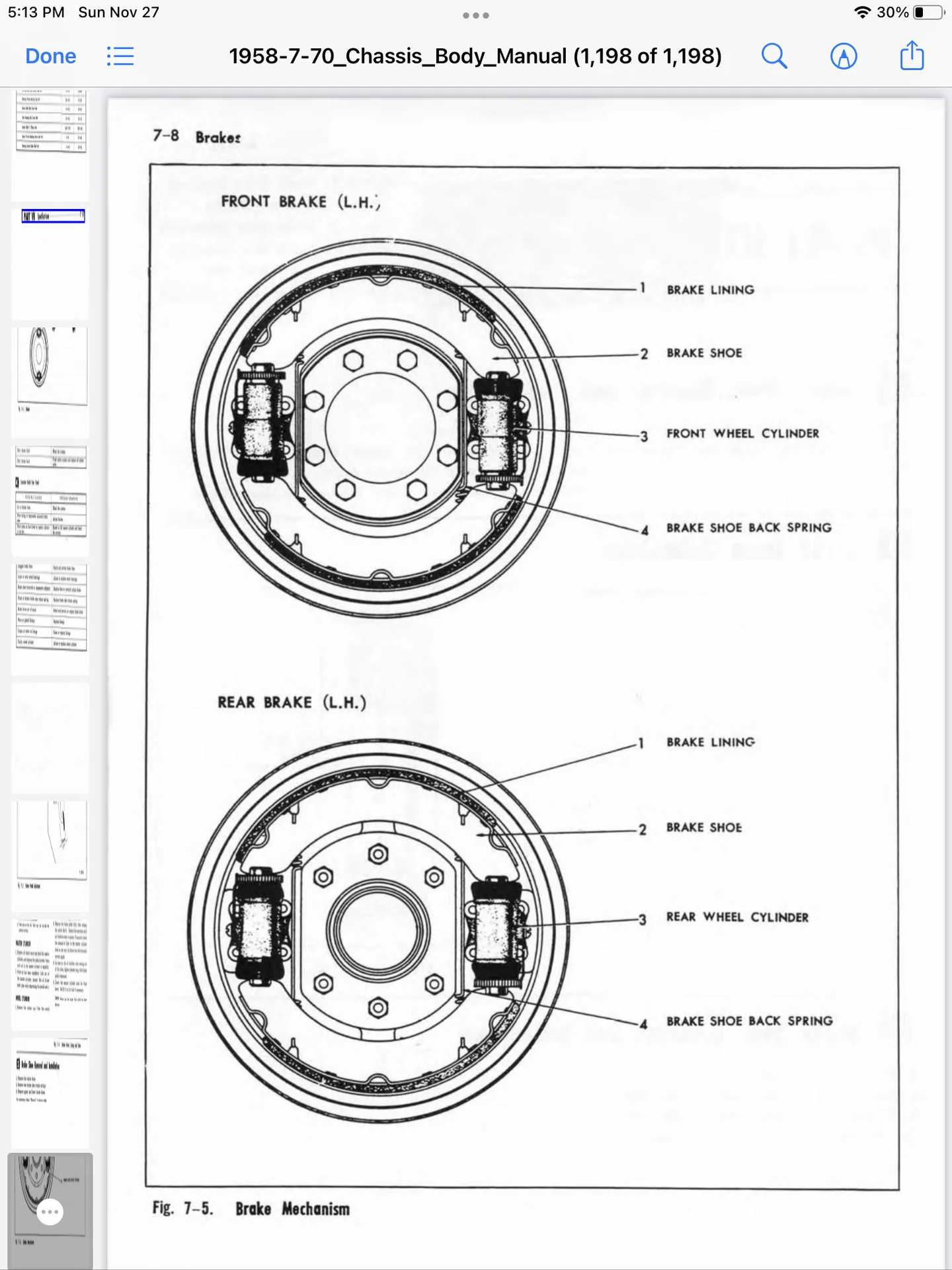

Don’t remember the changeover date, but if your pads have the retaining clips in the middle of each pad, then spring orientation looks like this…
… otherwise it looks like this, from the factory…
Thank you.
I have the top schematic. Mine does not have the retaining clips and I didn’t have the bottom schematic. That clears up how it should be and now to finish up the rebuild of the brake system
